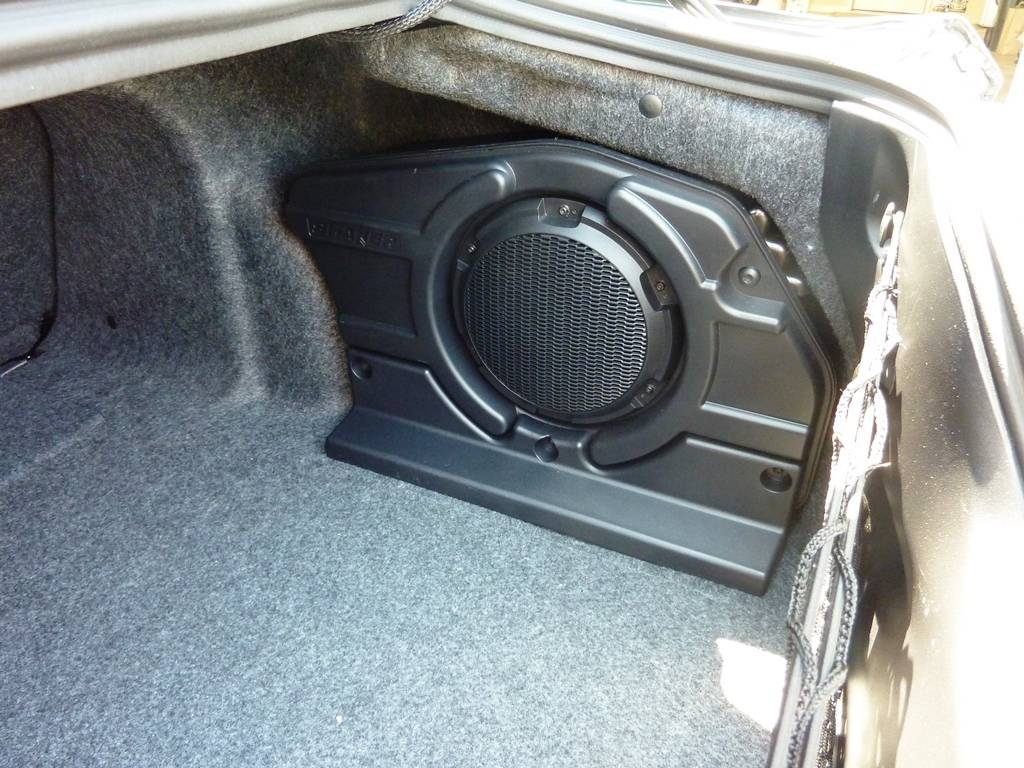

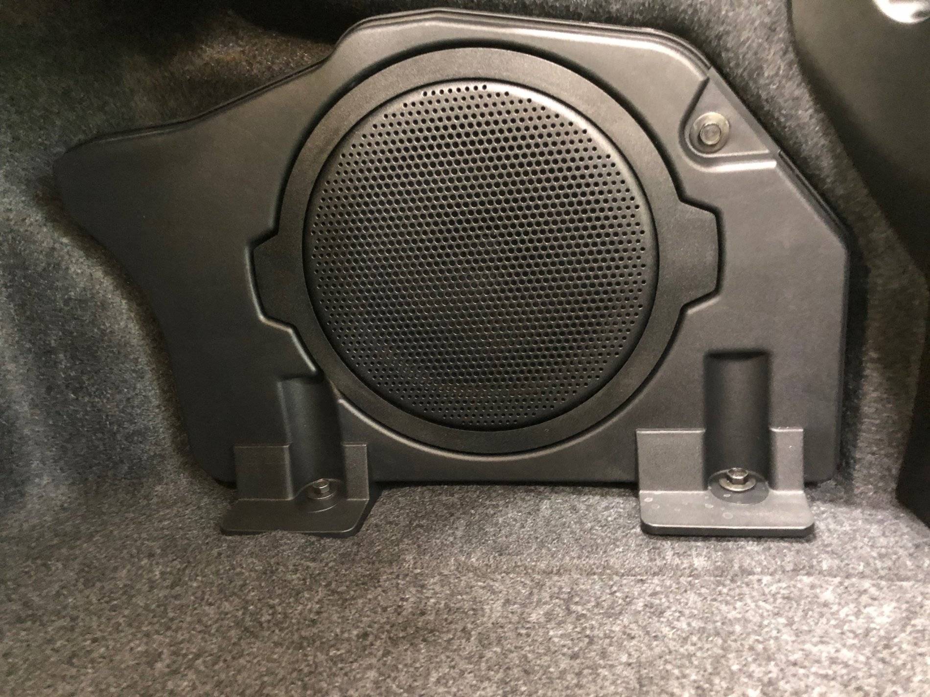

I'm 100% sure it will fit in the same location, but I think you might have to find a different way mount it. Does that bottom part of the Shaker come off and bolt down in front like the B&O? Maybe the top right bolt is in the same spot but it's hard to tell for sure. First pic, B&O. Second, Shaker.
Yes, the bottom part of the Shaker sub comes off first as it only covers the two bolts that bolt down the sub enclosure the same way the B&O enclosure does. I don't know if the B&O will fit though.

@BlownGP @gpierce @m3incorp @Cathul
FYI, The B&O 10" sub uses the same mounting holes as the 8" Shaker Pro sub. I swapped the 8" Shaker Pro sub enclosure with JL 8w3v3-4 in my car to a 10" B&O enclosure with JL 10w1v3-4. I'll post some pics tomorrow. The only issue is the trunk liner leaves a visible gap near the bottom 2 sub mounting locations so you can see the bare metal underneath. The Shaker Pro sub has another plastic trim piece to cover that gap
