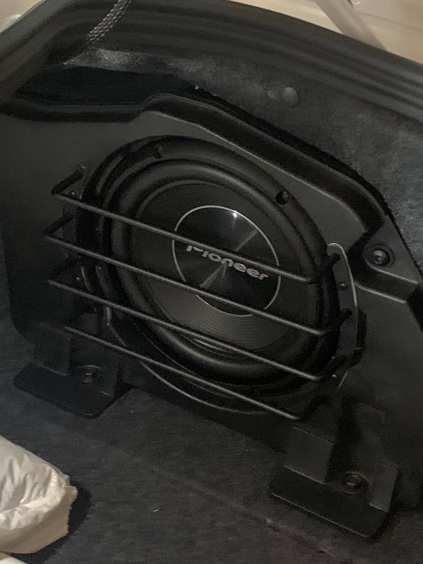

Finished mine up. Cracked the trim ring removing it so I just added this grill off of Amazon. Very happy with the noticabke improvement in bass quality. I’m no audiophile so that’s about the best description I can give lol.
Nice! Do you have a link to this?
Holy cow thanks for sharing. I also broke my pins but it's mostly on OK enough, I was cool with it.
But this honestly just looks good. I am doing this. Thanks!
