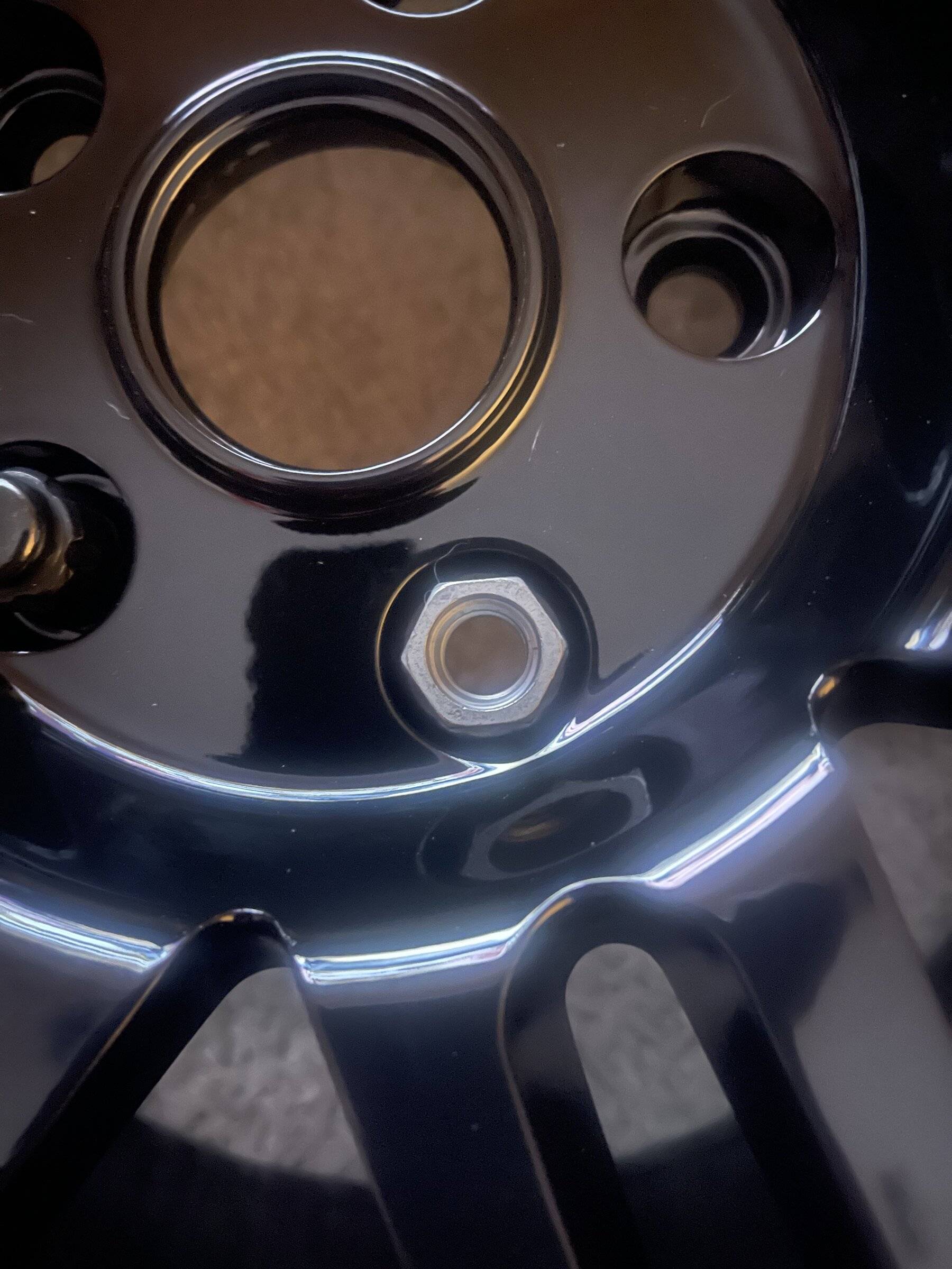

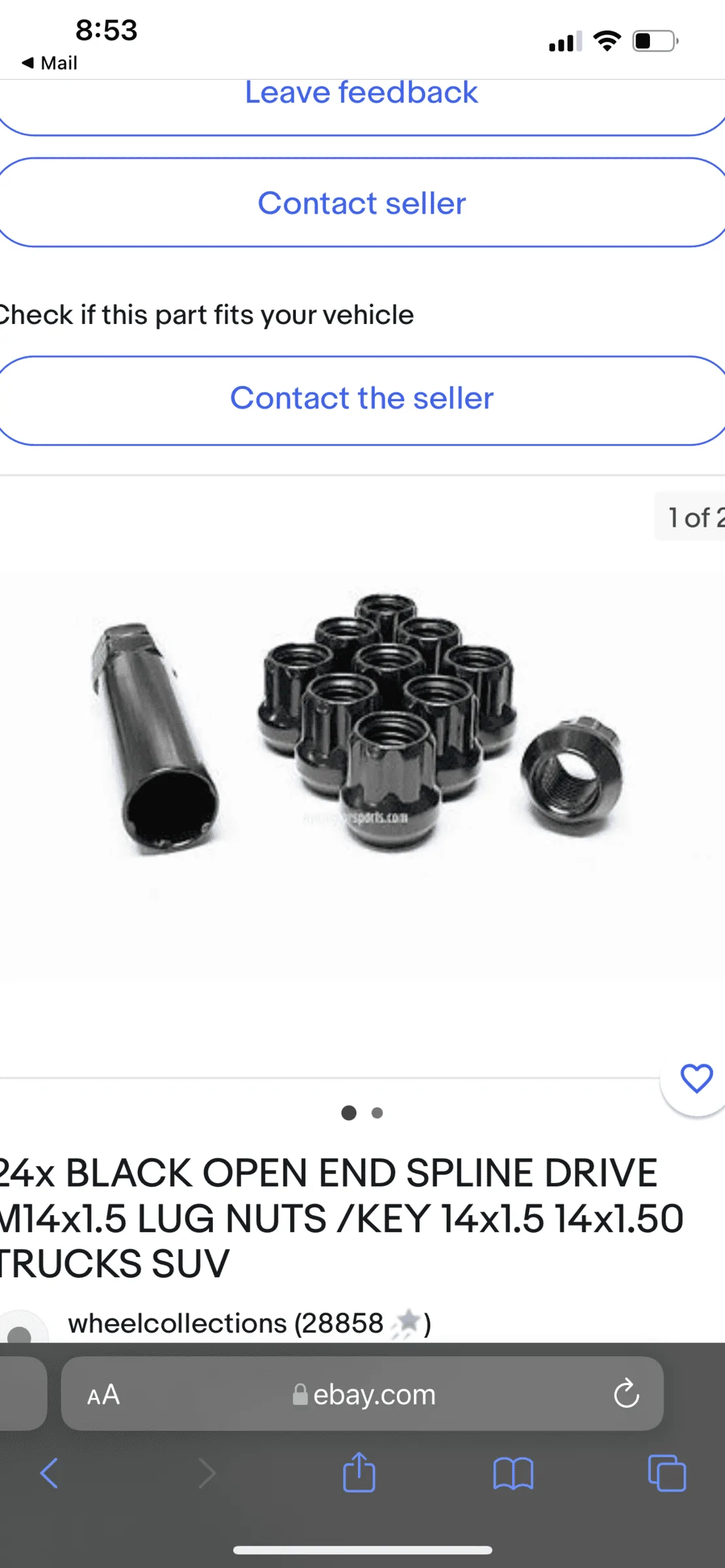

The bearings in my rear hubs went out so I changed them out for new hubs with 3” arp studs. What lug nuts are y’all using? I have aftermarket wheels and I am struggling to find a open ended lug nut that will work. The OEM style ones are too big to get a socket on and the closed tuner style nuts that came with the wheels prolly won’t work with my studs.

The second picture is the first performance nuts and the third pic is the gorilla nut that came with the wheels but won’t work due to stud length
