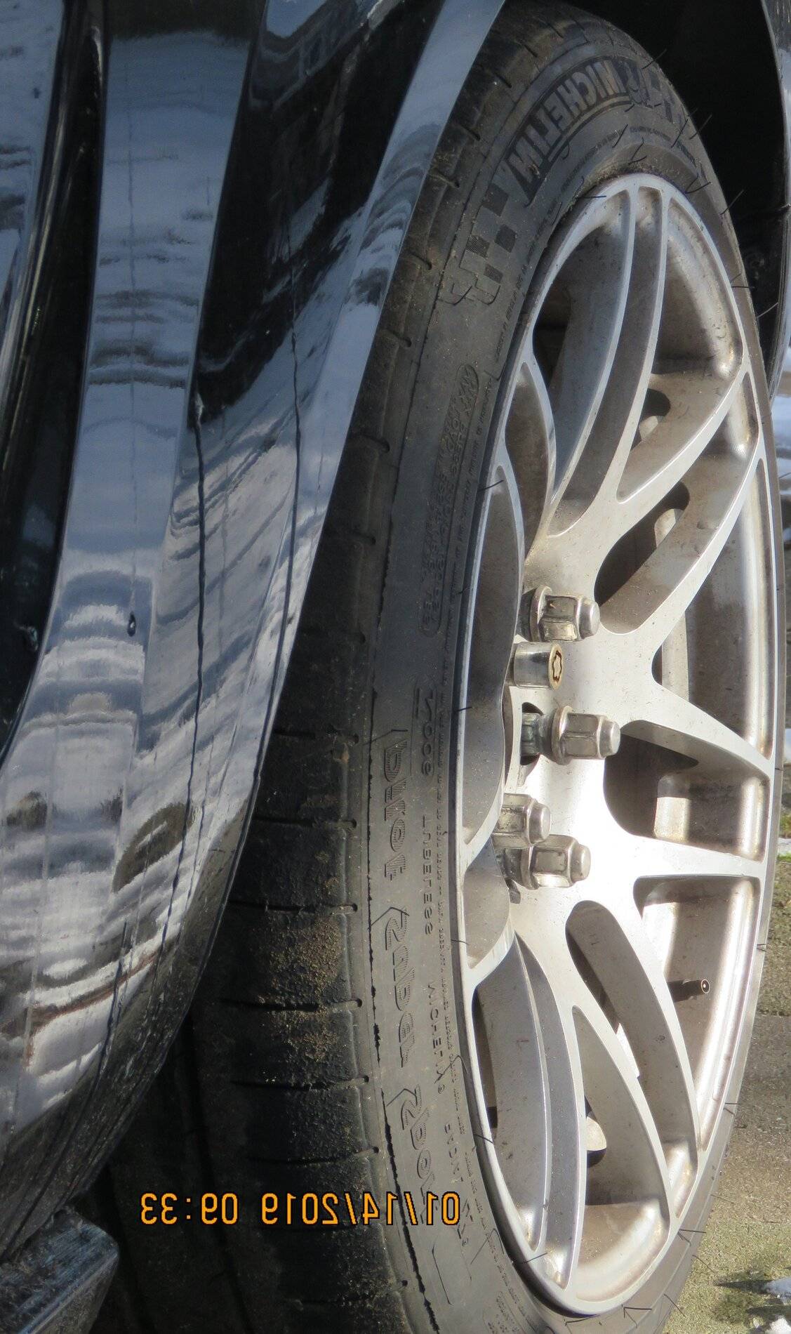

Obviously you'll be needing open-end lug nuts to secure the wheels. But if there's enough exposed thread to double-nut the stud, without there being an absolutely huge amount of exposed thread, you could take the OE closed-end lug nuts and run them down to cover the threads. Torque to maybe 30 ft*lbs max.
You'd remove the OE nuts for track time and the tech inspection for it.
Here, the long ARP studs stuck out nearly an inch and a half past the outer surface of the wheel at the hub. There's probably a better-looking solution, but this at least works and you have everything you need already on hand.
Yes, I know the picture is a mirror-image. I have no idea how that happened.
Norm
