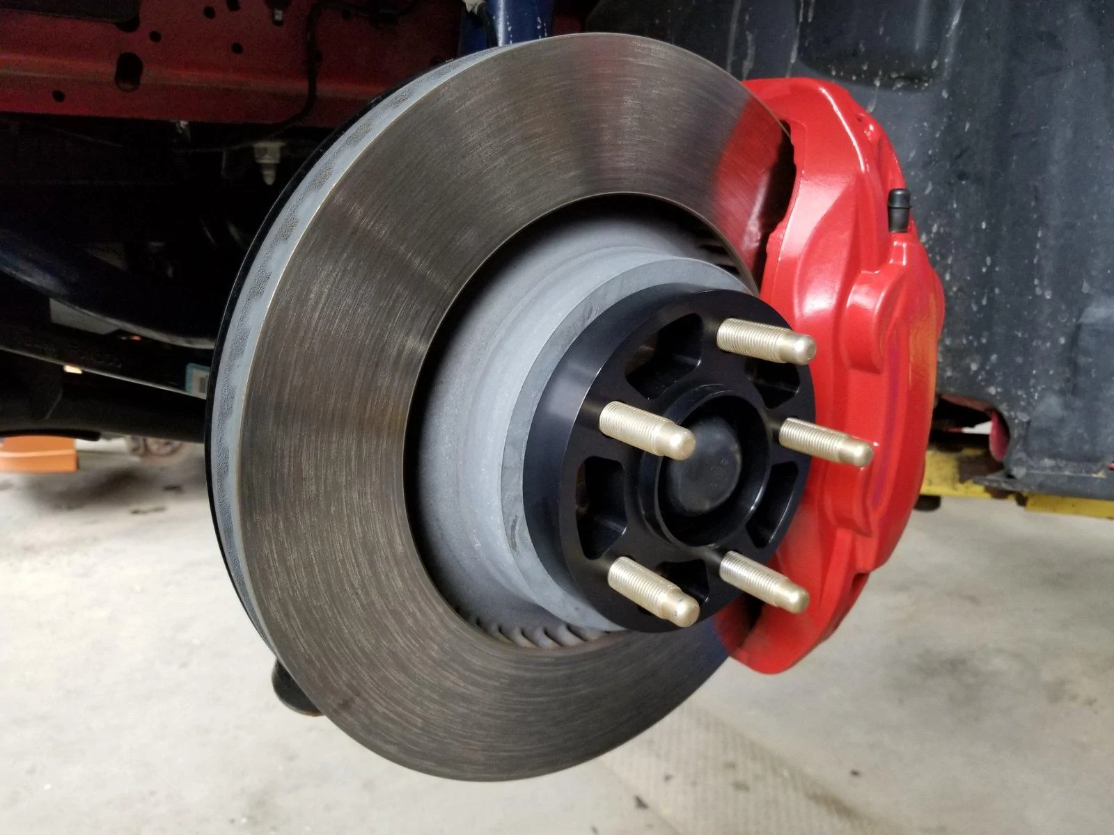

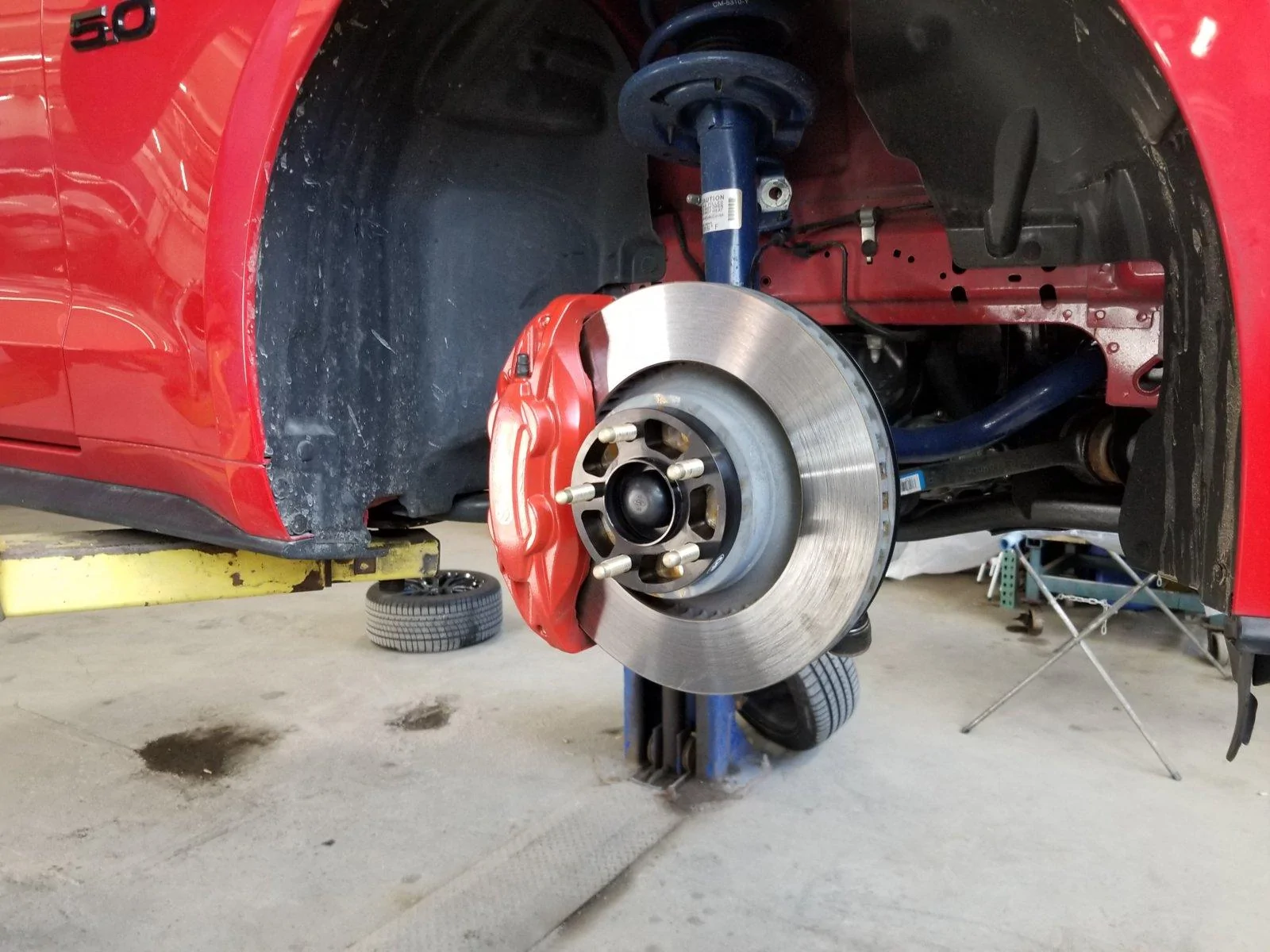

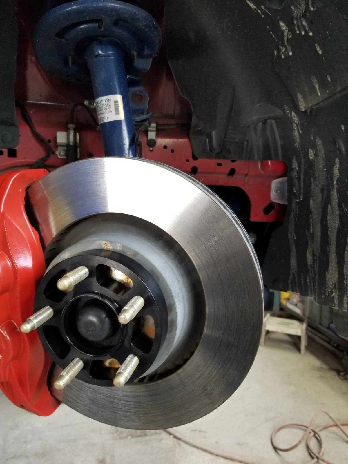

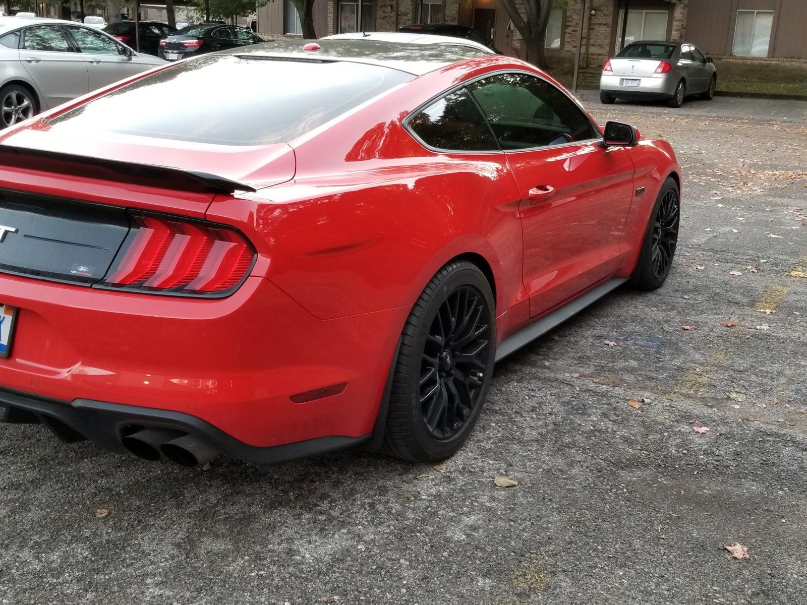

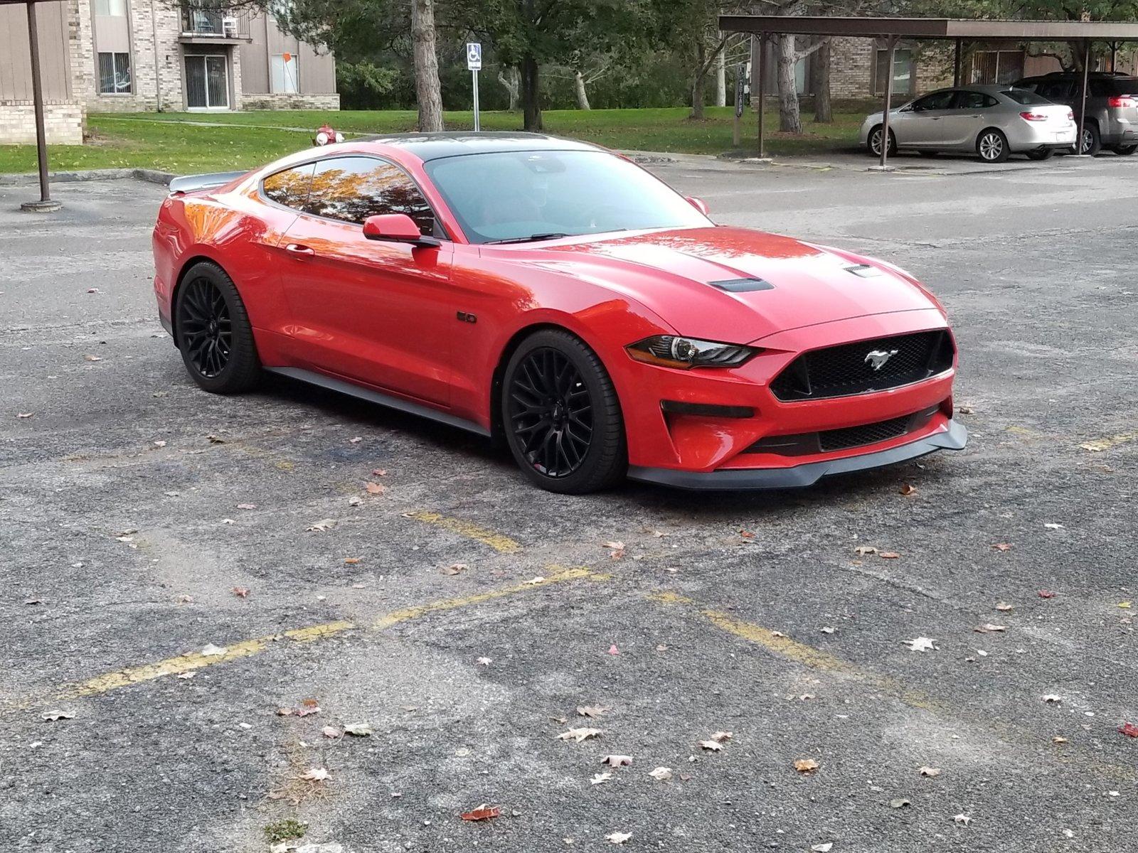

Thanks to everyone on the forum who helped me in getting this setup. @Wolverine @1 old racer @ApexRaceParts @BmacIL @1bad66 and finally @Optimum Performance for shipping the items quick. Their service wasn't great as I PM'ed them, called them and emailed multiple times but no response, however the shipping was super quick so i'm happy and not complaining.
This is my winter setup until next year when I'll be switching to 305 square setup. I'm lowered on FP track handling kit 1" all around and the spacers made a huge difference as i wanted the flush look. I got the high quality slip-on spacers from OPMustang and not the cheap bolt-on adapter type. They are definitely hub and wheel centric and i was impressed with the quality of these. I've noticed a significant improvement in ride quality and handling after installing the spacers, doesn't make sense but i can already feel it.
I got the following parts and got them installed at a local shop.
ARP 1" Extended M14x1.5 Studs: 100-7733 (all 4 wheels)
OP mustang hub and wheel centric 25mm (Front), 20mm (rear) spacers
Gorilla 26143BC duplex spline lug nuts
Apex Wheels

Looks really nice, funny how good those cars look with proper offsets and really no other changes. Glad to see you did it the right way with ARP studs and Tim's spacers.

Ya looks sharp!

That's the way to do it. Much stronger than the bolt on type. Looks good. Did the same on mine. Been very happy with the setup.

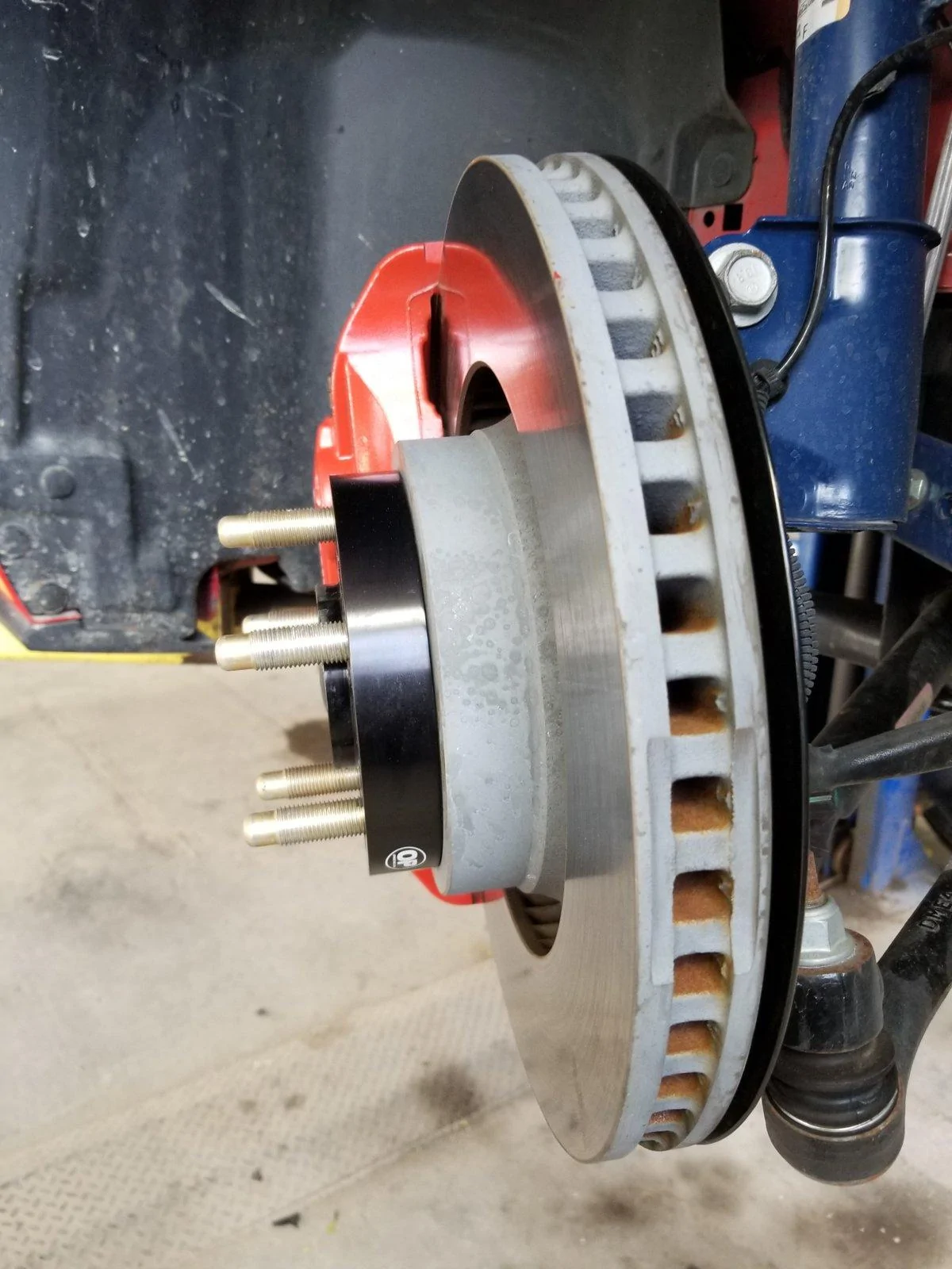

Looks good @krishelnino! Happy I could help get you set up!
Did you specifically request the spacers with lightening-slots milled in between the lug holes or do they all come like that now? Nice little weight saver there.

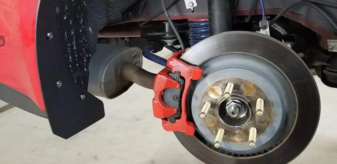

I got them installed at a local shop which works on a lot of Mustangs in my area. The existing studs were hammered out while on the car, they came off very easy i was surprised how they came out with minimal force. The new studs on front hubs were pulled in using open ended lugs and impact wrench. This caused some circular indentations on the hub surface, i wasn't too happy about it. But he smoothed and polished them out, told me it wasn't nothing to worry about. The rear hubs were removed off the car and new studs were pressed in using some tool on a bench. One of the stud refused to get in completely so it took some hammering. Also, one of the spacers on rear hub was a very tight fit on the studs and required hammering it to push it in.
The design was updated for weight savings while maintaining the same strength. That is what it says on their website. They were really light when i held them in my hand.
It sounds like that one stud pulled in ever-so-slightly crooked. Not good. Hopefully they did get it squared up, otherwise you could be in for a wheel that won't center (vibrates kind of like an unbalanced wheel/tire does).

I agree this isn't a ideal way to install and wouldn't recommend it to anyone.
But he is very good at what he does and installed suspension kits, lowering springs on over 100 S550s in our group and most people go to him for anything that needs to be done. He has a S550 himself. I couldn't find any other dealer or shop that agreed to install this for a reasonable price, either the quotes were ridiculous and i wouldn't trust someone who never worked on this to do it right. I took it here and he allows customers to watch while he installs anything.
I've considered getting the whole hub assembly kit from Ford Performance with extended studs pre-assembled. That would mean an additional $450 in parts and doesn't involve any of this since the hubs would be swapped and bolted on directly. But in the end, i decided against it.
After the install, he took it on a test drive with me in the car to check everything. I haven't had any issues so far, the car drives smooth and handles great. Only time will tell if something goes wrong and fingers crossed it doesn't, but if it does I'll be replacing the whole hub assembly next time. He also asked me to come back in a week to retorque the lug nuts, and when I go I'll ask him to double check everything.
