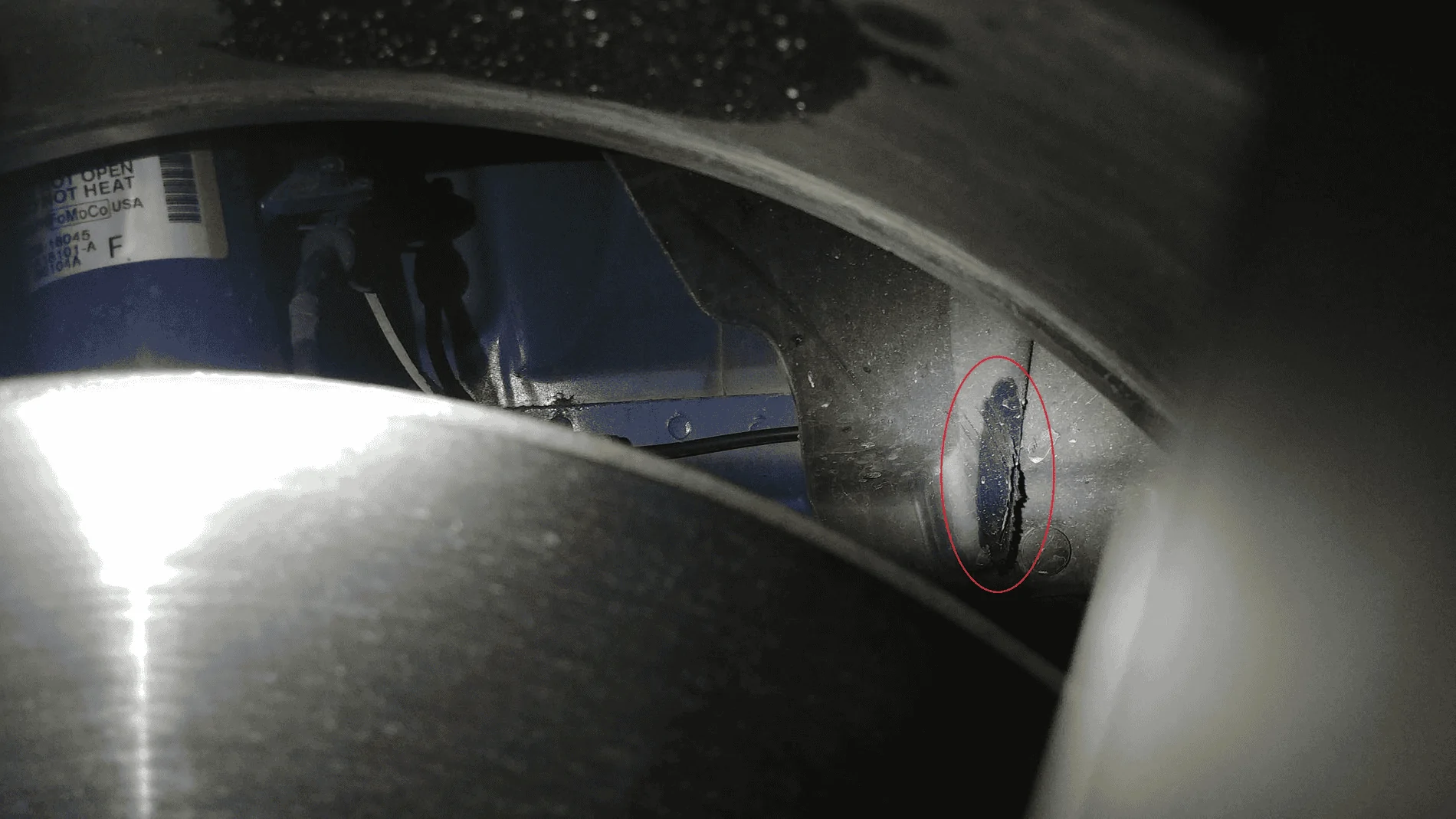

Oh yeah, I absolutely have; specifically I'm pretty sure it's the Steeda lateral link control arms which is part of their Bumpsteer kit since their install instructions mentions rubbing at full lock with different wheels.
This is a old pic of the rubbing, but it's definitely still there and has now rubbed the paint off the chassis at this point.
I've modified my car for handling which has had unintended but not unexpected consequences, I'm just trying to figure out what is the optimal solution to the problem.
