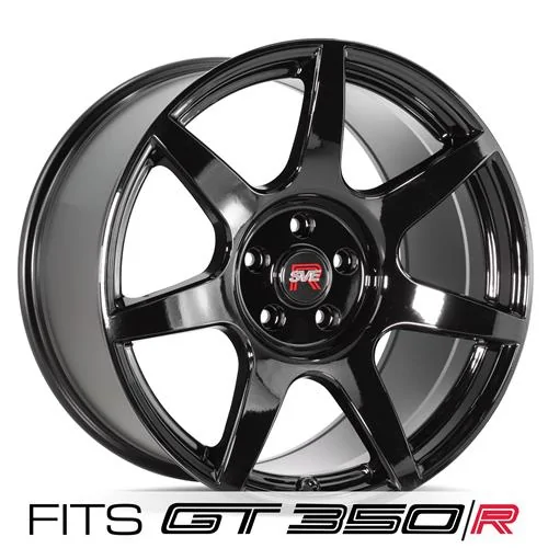

Hmmm. 19x11 +60mm $249. 25 or 30 mm spacer up front?
19x11ET62 is the OEM GT350 rear and I use a 35mm spacer with mine to get a 27m offset (vs 24mm for OEM GT350R fronts). The 35mm spacer I use is actually an H&R 35 that came with their double stud setup. I don't think these are strong enough for a GT350, so I punched the extra studs out and just use it as a hub-centric spacer.
So, if you get the SVE's, get a pair of the H&R 35mm spacers and a pair of OEM Hub 299 front hubs (GT350R OEM) and it'll bolt up just fine with stock lug nuts.
