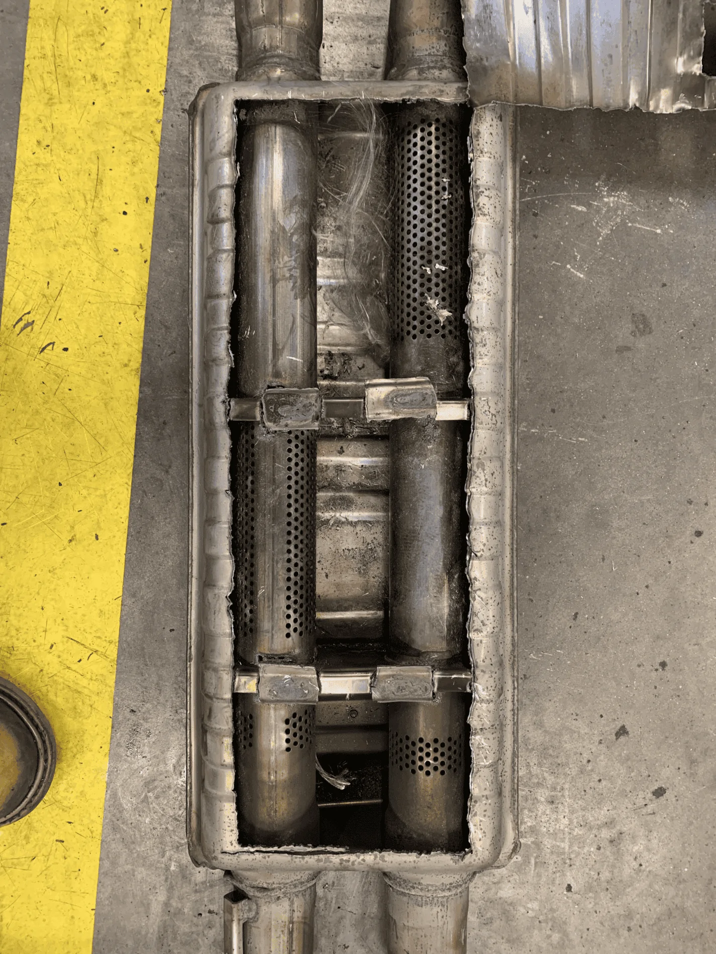

If my Switchfire ends up being too obnoxious once I put on my headers with the Atak, I'll probably look to fabricate up a mid section using the 3" dual in/out resonator option here:
Dual Thin Oval Muffler (stainlessbros.com)
