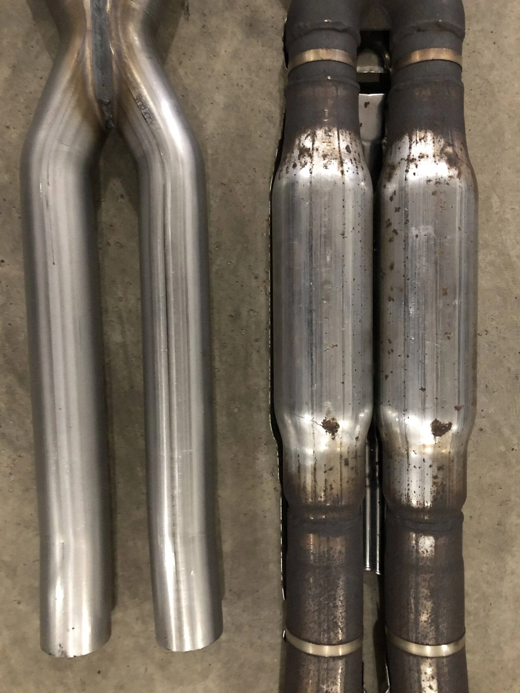

Got the GT350 X-pipe and resonator section in, and have a Ford Performance X-pipe. Here are some comparison pics and the pipe measurements:
FP inlet outer diameter: 2.25"
FP outlet OD: 2.50"
GT350 inlet OD: 2.50"
GT350 outlet OD: 2.75"
So the plan is to install the FP pipe myself, and unless I hate it, the GT350 assembly will be in the classifieds soon. So many times over the years I meant to learn how to weld but never did it, and always end up regretting it. I went to a short 1-week hands-on class for work a few years ago and all I learned is that I really suck at welding.
That OEM GT350 cast stainless steel X isn’t the greatest flowing vs the FP sweep X.
I think the FP X will do you right , if not try the H-pipe next.
IMO the factory is using that casted stainless True X to assist in suppressing dB’s on the GT350 in an attempt to keep the exhaust volume reasonable.

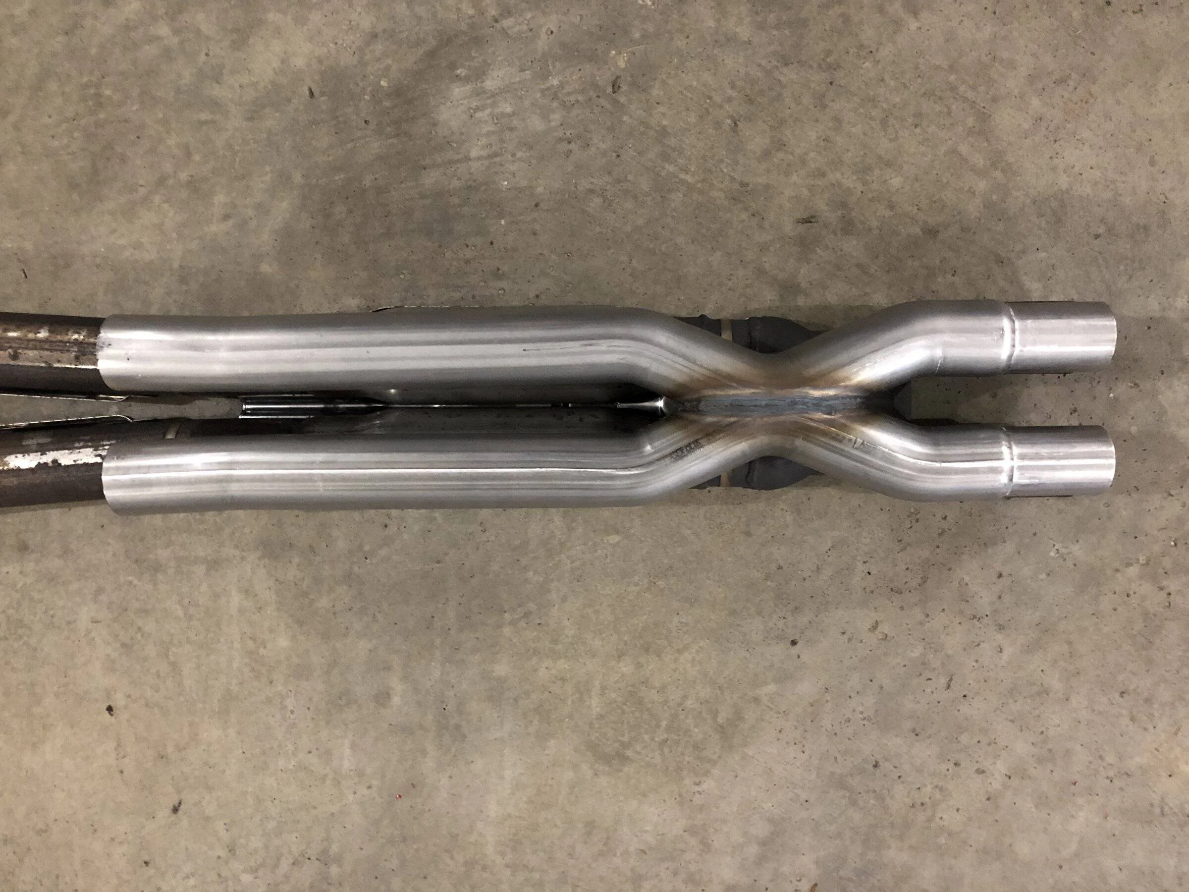

OK, Ford Performance X-pipe installed. Probably will be taking it back off and putting the factory resonator back on. This FP X is more booming loud at 2000 rpm, which I don’t like, but otherwise sounds a lot like stock, except louder at WOT. But very quiet cruising. Also can’t get the tips to line up right, the two long legs didn’t match up well with the back end of the exhaust. Had to pound a piece of wood between them to spread them out so I could jam the pipe on. No noticeable difference in power.

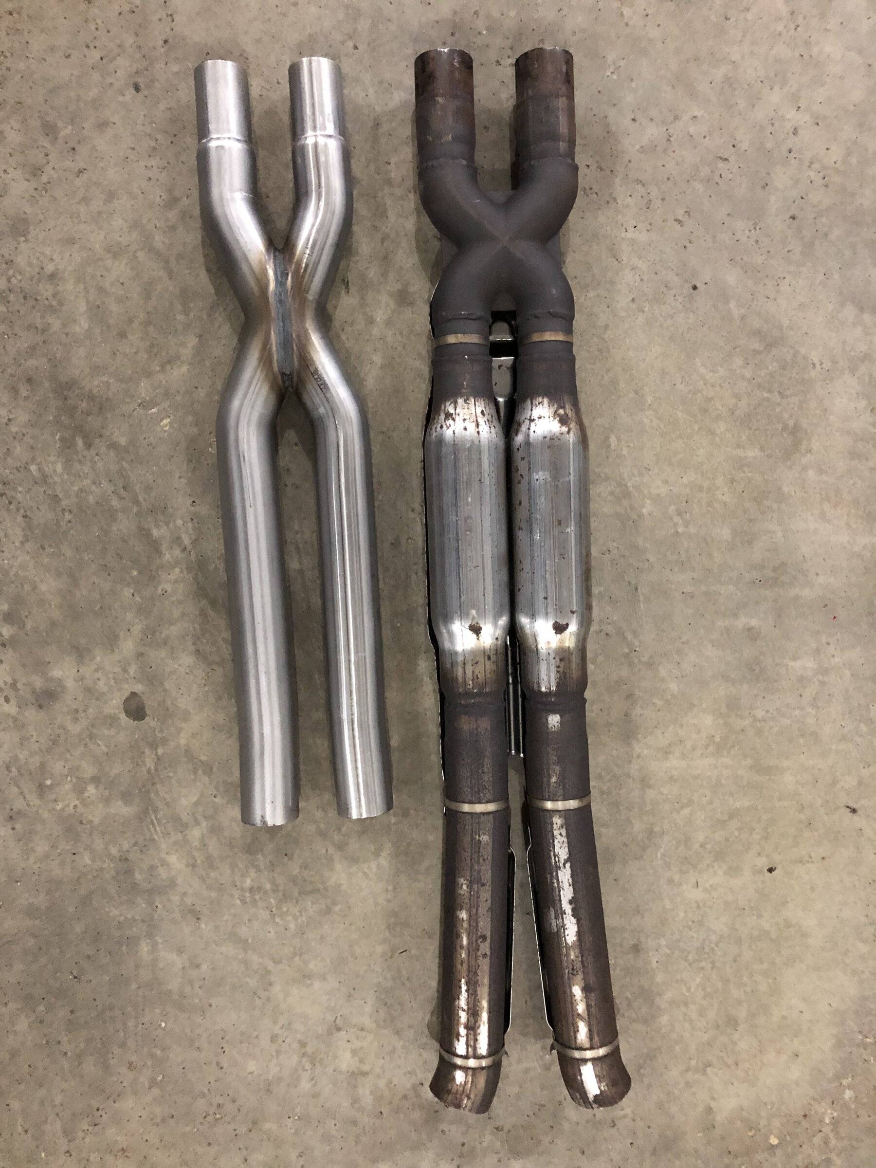

Did you put it on the right way up ? (the bends at the exit are different on the left and right side of the car) :like:

Not on this FP version… I was looking for that. Here it is next to the GT350 center section.

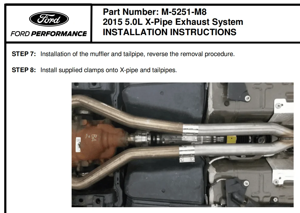

Yeah its difficult to tell from your photo, maybe its the angle or maybe it's just fabricated poorly :frown:
The difference compared to yours appears more obvious in this photo from their install instructions :
But even that seems far less pronounced than the Steeda offerings :
Although I have seen people still mange to fit the Steeda kit upside down (on YouTube installation videos ...).
