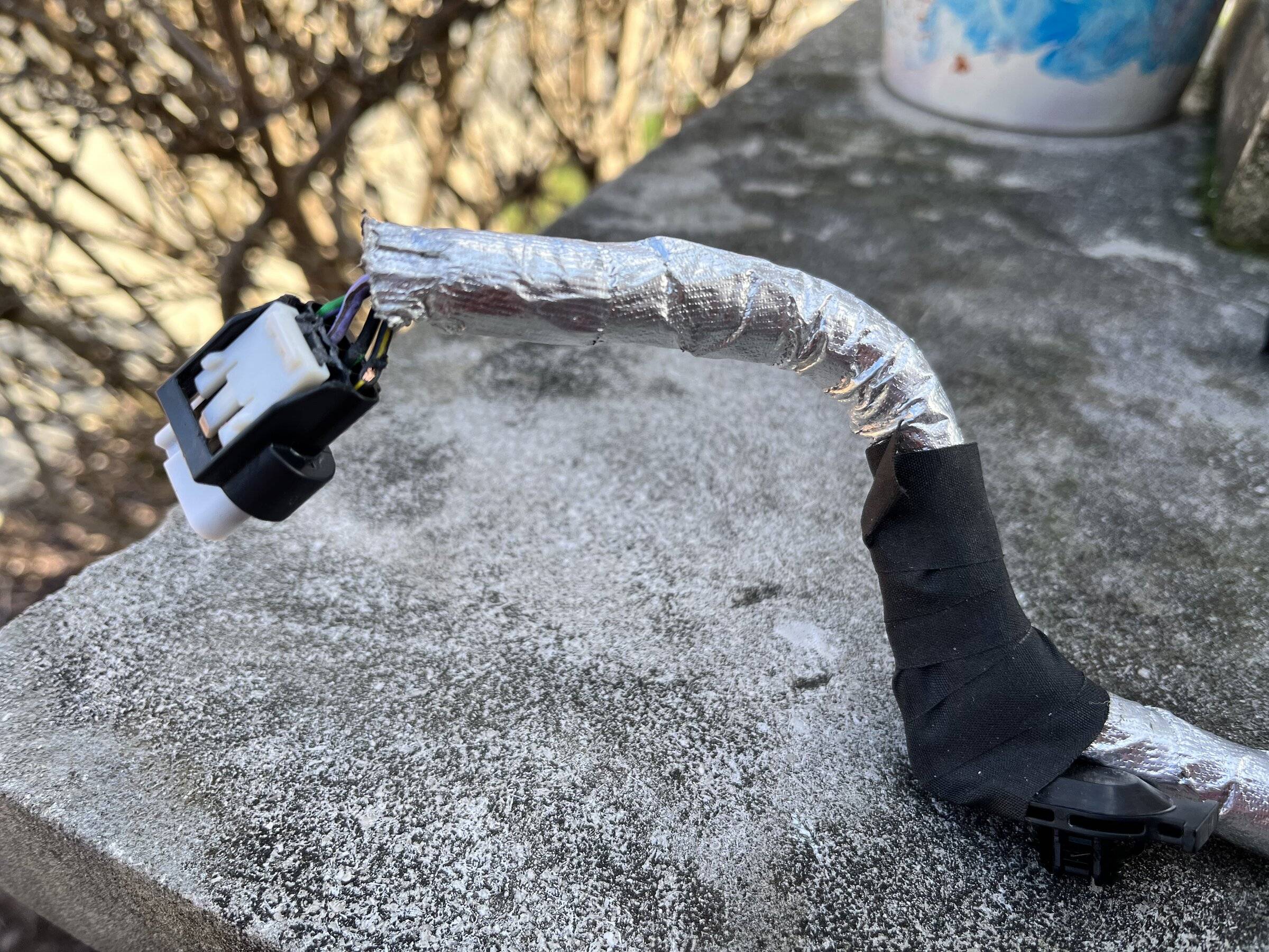

Yes, I only added Steeda H-pipe, and you'll be very happy with the deeper sound. Plus, make cut a little shorter (1/4 inch) and pull exhaust forward to eliminate issue with active exhaust harness rubbing into frame and cutting wiring.

Yep the wiring issue is real, look at this photo, 186 miles on my M1HP

Will you be taking it to the dealership to be fixed under warranty, or repairing it yourself? It’s doable, I had to repair mine because no one has the harness in stock.

I bought two harnesses as they're the same part for left/right, $25ea fixed. Really no time for Dealers unless major issue.

I hear you. I like to stay away from the dealer as well and only visit them if it becomes absolutely necessary.
