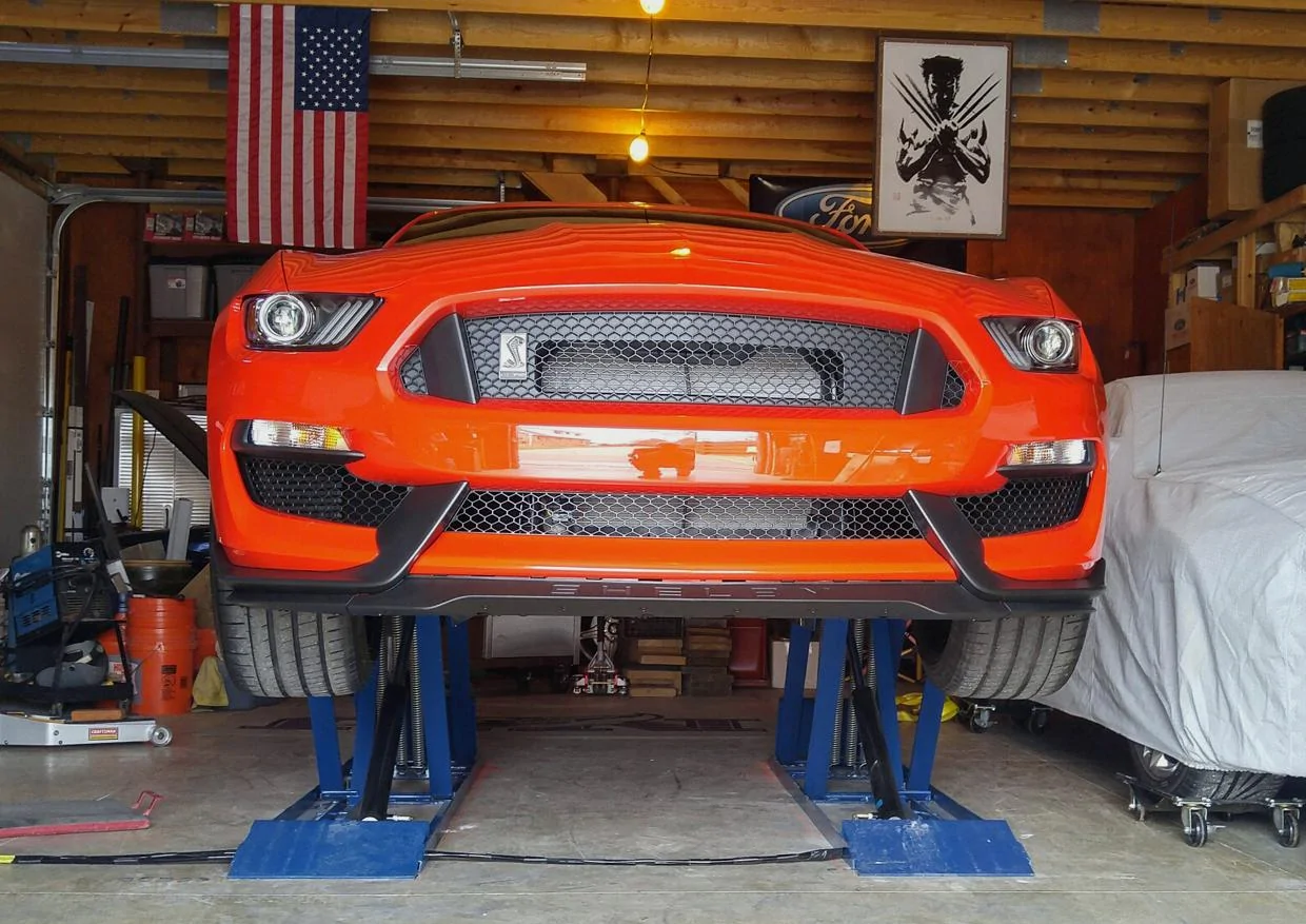

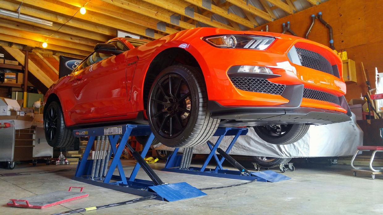

BendPak Low-Rise P-6B has done me right. Extremely robust.

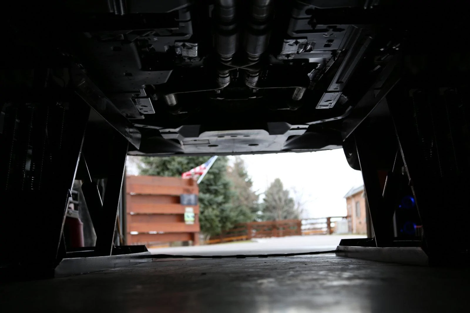

A few additional comments regarding my Bendpak HD-9W.....
1) I bought it through a local reseller / installer and they did a great job of setting it up. No leaks in the hydraulics or air, and the cables and safety locks work great.
2) I give mine quite a workout. I've had it for nearly six years and other than occasionally cleaning it and greasing the various zerk fittings throughout, I don't give it much of a thought... it just keeps working.
3) I have the optional sliding jack bridge - really just a steel span that slides along a track between the runners. I use a heavy-duty scissors jack on it that I operate with a Milwaukee cordless impact driver and can lift any car up (one end at a time) and put it on jack stands on the lift. This allows me to do all sorts of suspension and brake work on the lift, just like a 2-post.
4) Installation of a 4-post is much easier than a 2-post. Mine isn't even bolted to the floor. And, as others said, you need stronger concrete pads to support a 2-post.
5) Absolutely no issue with lowered cars using the standard Bendpak ramps, but I do back lower cars onto it, rather than driving them on forward.
Couple additional pics - as you can tell, I have confidence that this thing isn't going to collapse on the lower car.

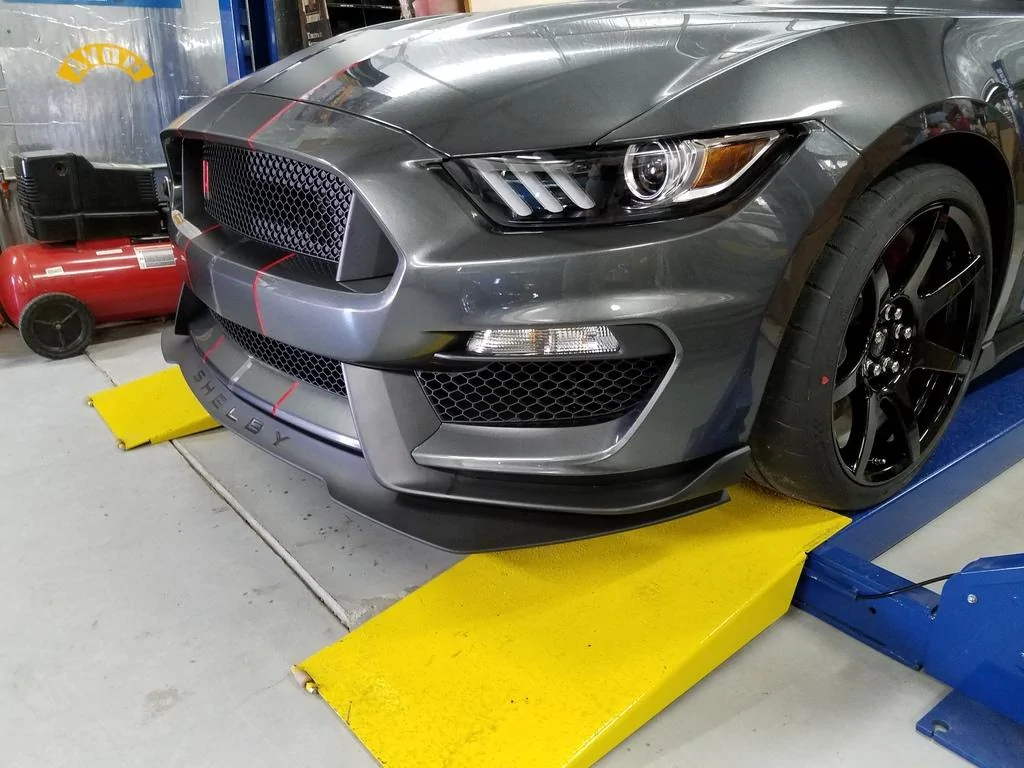

Stock Bendpak ramps on my HD-9W. I would not try to pull straight on, but backing on is no issue, even for an R.

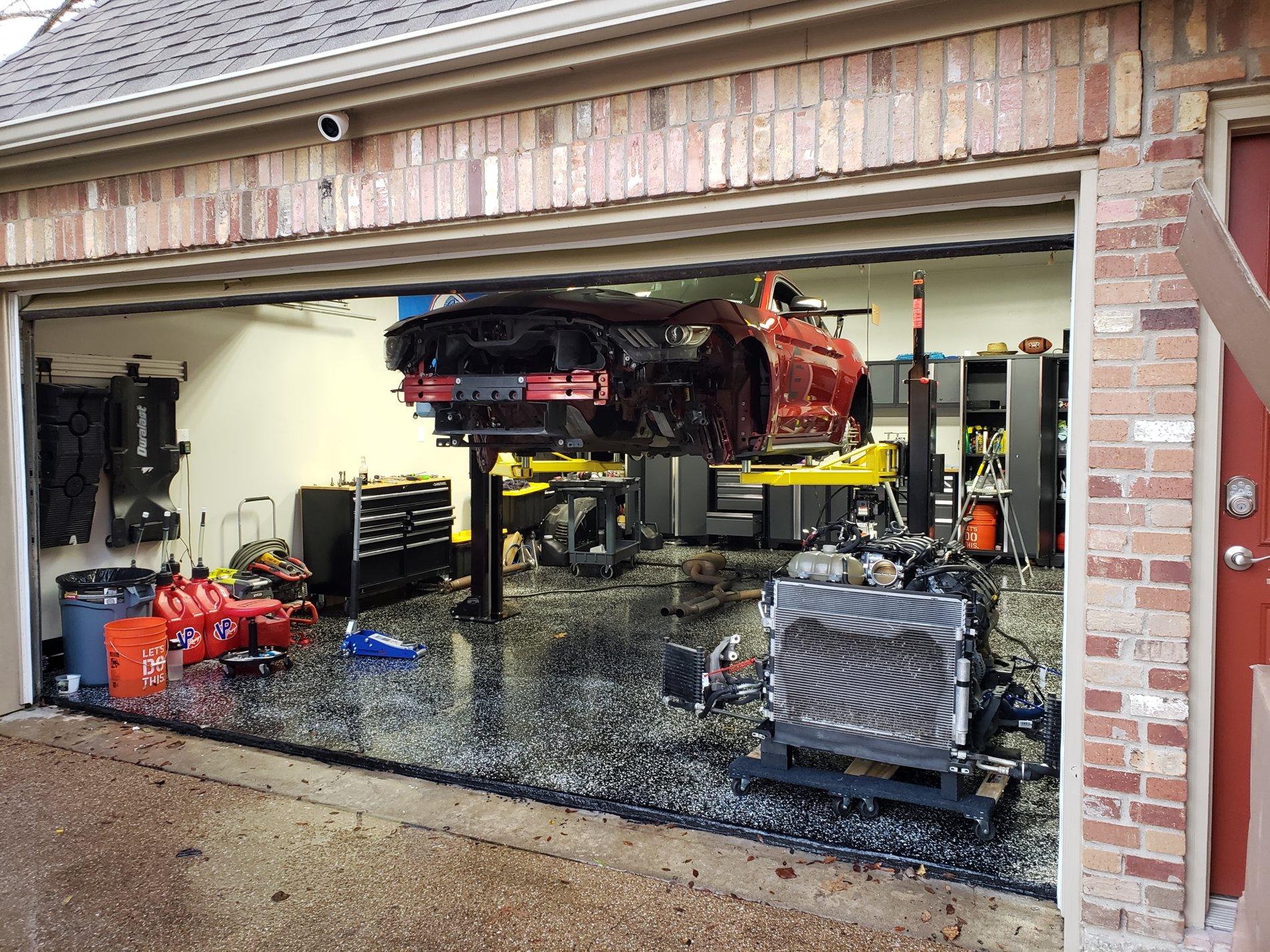

If you need a low-ceiling lift, take a look at the Danmar M-6 (previous version was called the MaxJax). It's fully certified and my car has been on it for almost 3 months now while I am waiting on engine parts. A bit quirky, but a great option for those of us with low ceilings.

The M-6 is a "portable" lift according to there website. How is it to move? It looks like your is bolted to the floor.
