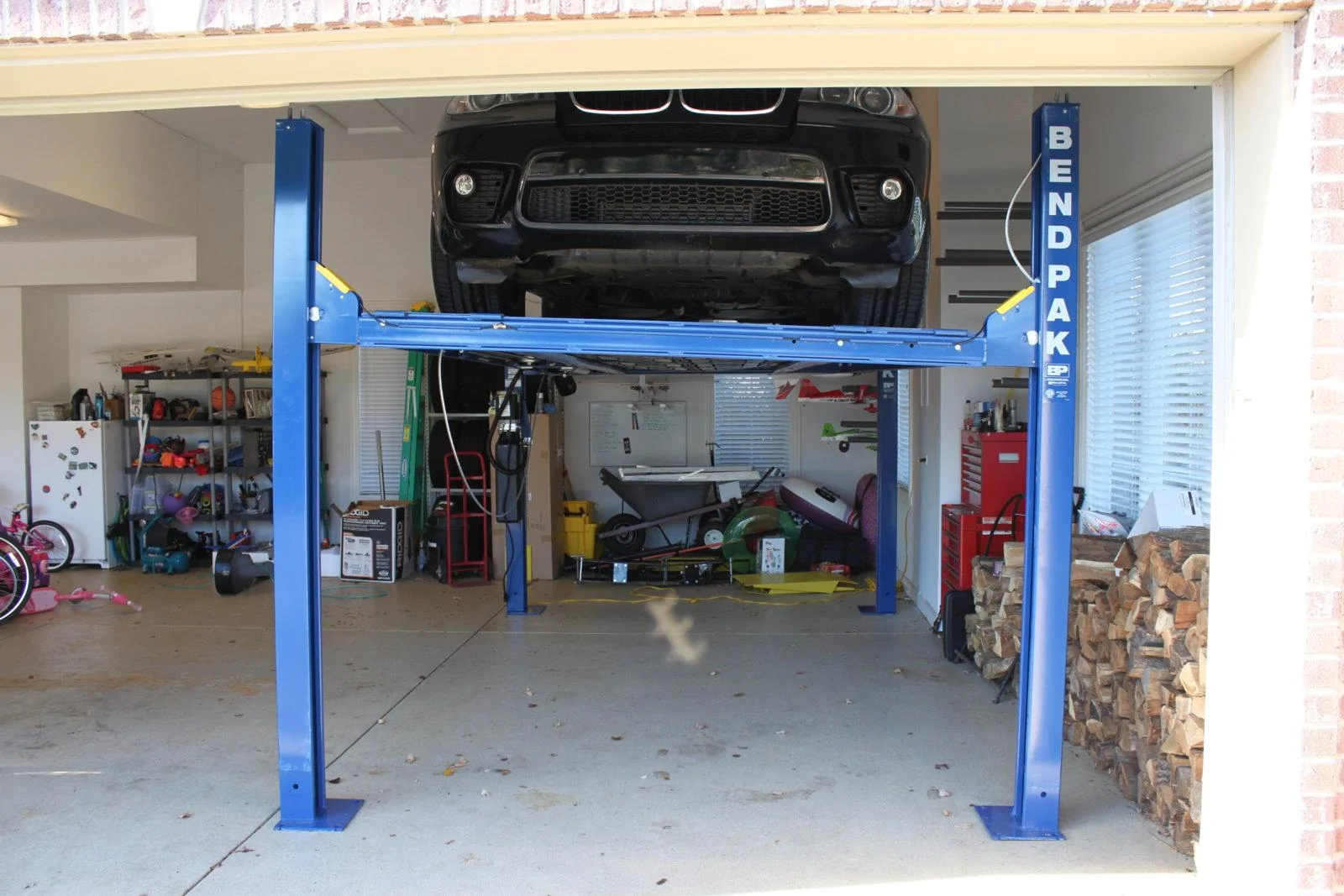

I'll have to vote against Bendpak. I have an HD9000 4 post lift and I've had major problems with it. Support at Bendpak is non existent. It took months of calling and pressure from the dealer to get Bendpak to do anything. I was not satisfied with the outcome. I don't trust my lift and wish it was out of my garage. I will never buy another Bendpak product. I understand products have problems but they refused to take care of the issue blaming the shipping company, installer, dealer, and everyone but themselves. I received a junk lift which looked like it was used and beat up. Posts were bent, rust was present on the lift, and all air fittings leaked. A cable broke and one corner partially fell and stranded my X5 on the list in the first week of use. Again, BendPak blamed everyone else and refused to do anything. Stay away from Bendpak. If you have any problems, and you will, you are on your own. See below for a picture of my bent lift with cable snapped and one corner hanging. The posts really are bent. This is not an optical illusion. Oh, and the stock ramps will not work for anything but an SUV. You have to pay an outrageous price to get their extended ramps if you want to get a GT350 or any other sports car up the ramps. The stock Bendpak ramps will take the front off your GT350 when it scrapes.

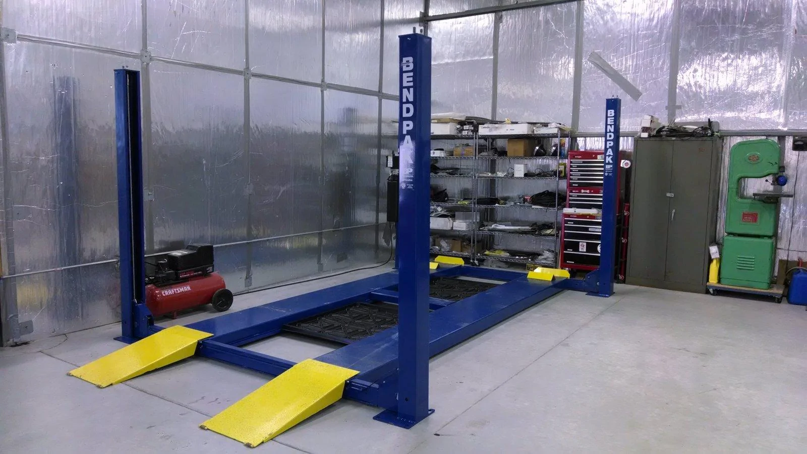

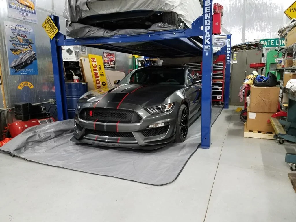

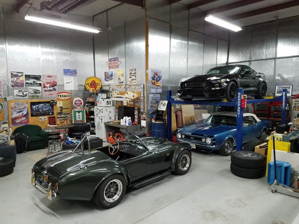

A few additional comments regarding my Bendpak HD-9W.....
1) I bought it through a local reseller / installer and they did a great job of setting it up. No leaks in the hydraulics or air, and the cables and safety locks work great.
2) I give mine quite a workout. I've had it for nearly six years and other than occasionally cleaning it and greasing the various zerk fittings throughout, I don't give it much of a thought... it just keeps working.
3) I have the optional sliding jack bridge - really just a steel span that slides along a track between the runners. I use a heavy-duty scissors jack on it that I operate with a Milwaukee cordless impact driver and can lift any car up (one end at a time) and put it on jack stands on the lift. This allows me to do all sorts of suspension and brake work on the lift, just like a 2-post.
4) Installation of a 4-post is much easier than a 2-post. Mine isn't even bolted to the floor. And, as others said, you need stronger concrete pads to support a 2-post.
5) Absolutely no issue with lowered cars using the standard Bendpak ramps, but I do back lower cars onto it, rather than driving them on forward.
Couple additional pics - as you can tell, I have confidence that this thing isn't going to collapse on the lower car.
