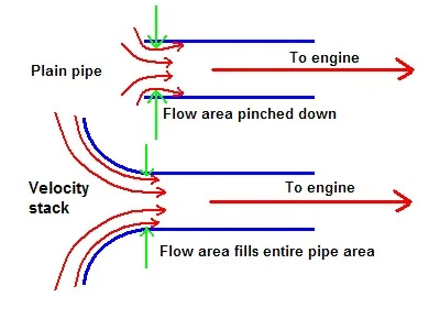

Velocity stacks can show pretty big gains on the dyno, they smooth out the sharp edge of the compressor inlet

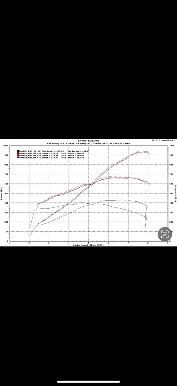

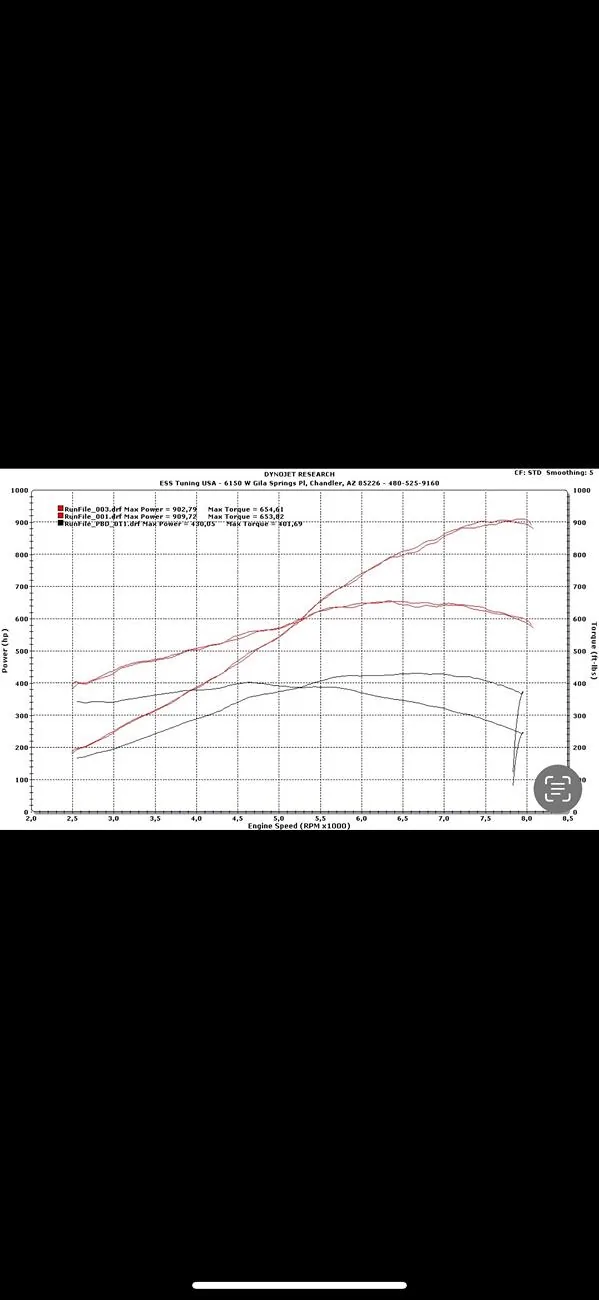

Here are some results from the velocity stack on the dyno from my personal car. G3X/100mm/E85/headers.
First graph is filter on vs filter off. We did about 3 pulls each and they averaged almost the same. Maybe a few HP with the filter off but realistically a wash.
Second graph is 3 pulls with the stack. All runs were done on the same dyno session with cool down between runs for consistency. All done on the ESS Dynojet.
Real world testing on my car has shown that the velocity stack does make gains at that power level, roughly 1 MPH on average 1/4 mile trap speed and slightly less than 1 tenth 60-130. The factory intake and filter do really well, so as mentioned it’s not really recommended to drive it around like that. In more controlled environments however, like the dyno or drag strip it can be beneficial.
