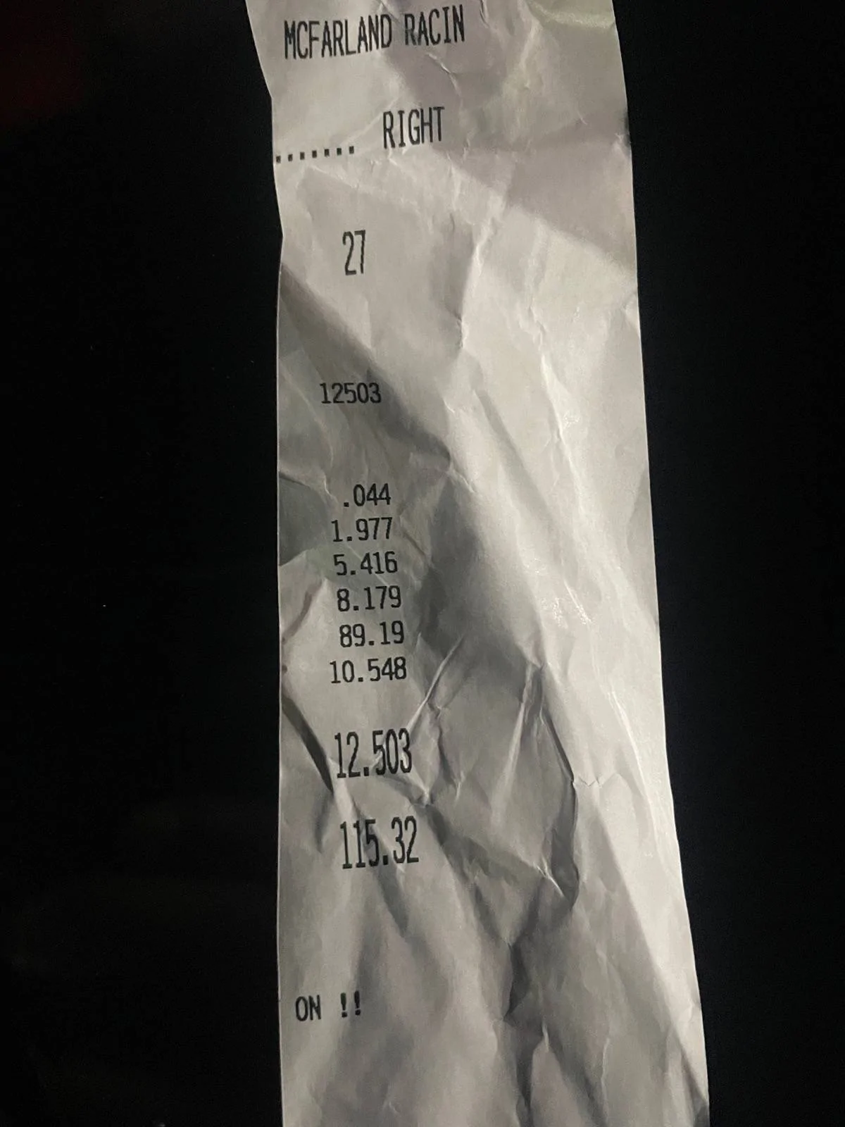

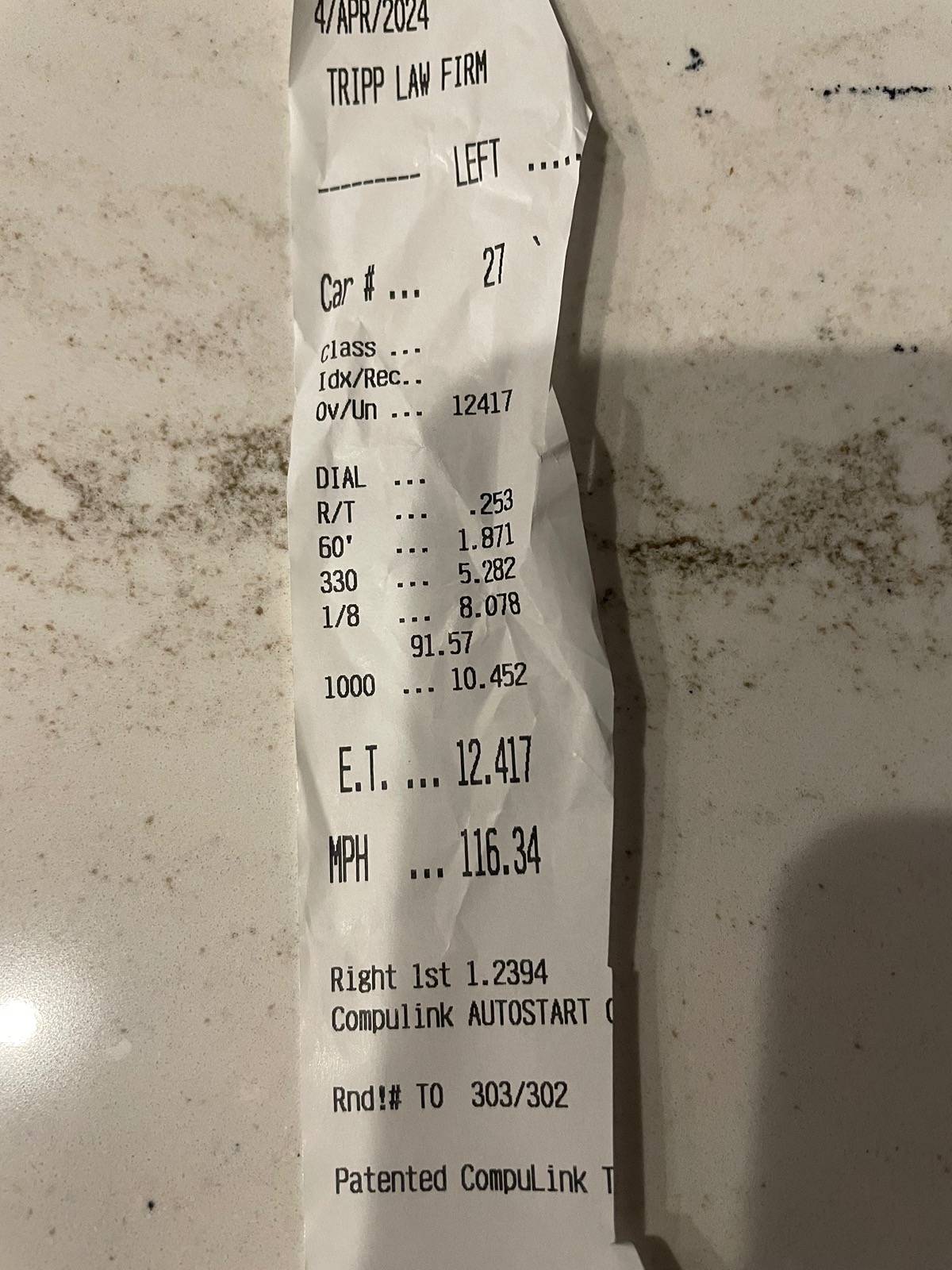

I did make a couple of NA passes on the Hoosiers about 2 months ago, but the sixty was still an issue. Here are those time slips.

1.8 on 60ft, isn't hateful. You're being hard on yourself, but I get it.
