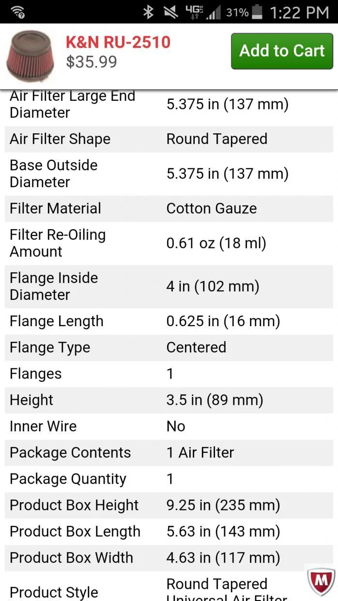

Is there enough room to put a small filter right on the blower head unit it self? I'm guess the 90 degree bend in to the blower from the intake elbow is contributing factor of restriction? From stock air box to JLT intake is netting around 20-25 whp from what I'm seeing & no JLT intake at all is netting another 27 whp. So is it safe to assume that your looking at 50whp without an intake at all?

I don't have a Paxton yet buddy. I think the inlet is 4 inches but I'm not sure how many inches from the blower to the front shroud is. So the actual size of filter I would purchase is unknown until I can get install & a measurement. But will do an update along with before & after dynos for something like this (if feasible) vs. stock air box.
If all else fails can always purchase the JLT :cheers:

I'll go check the measurement in a little bit
