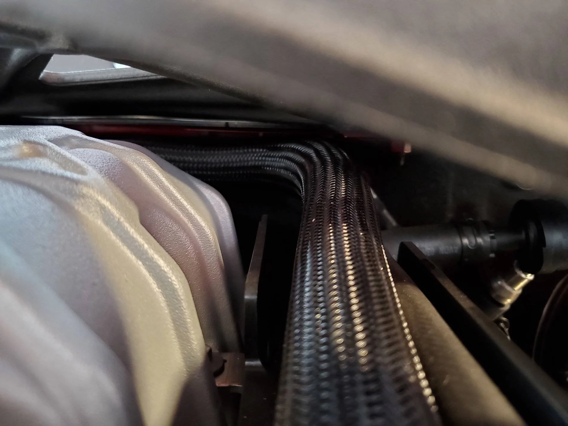

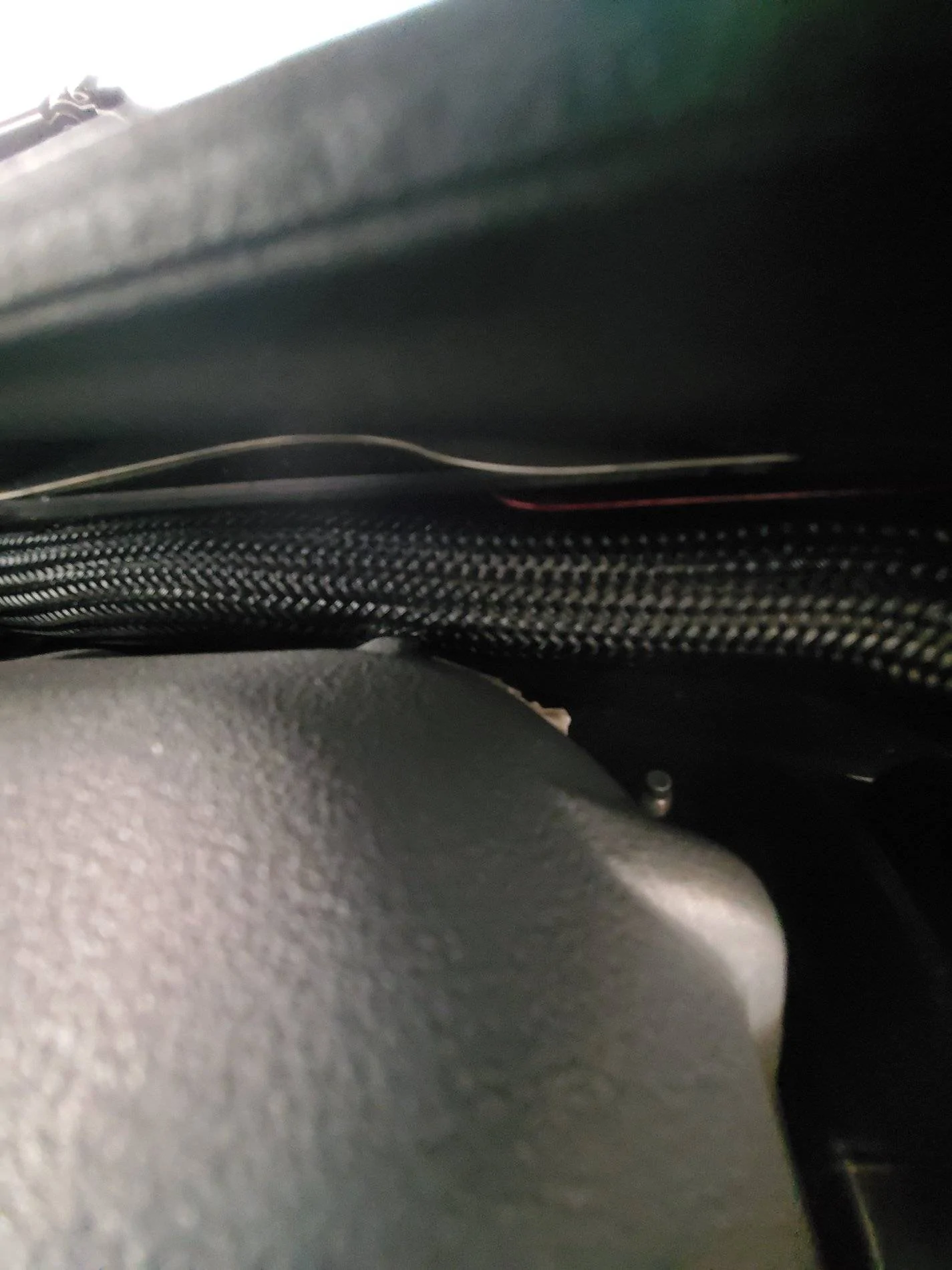

have a look..... it seems to me that my supercharger coolant line isn't routed correctly? Its tight in there, hard to get a good photo. Thoughts?

Yep, you have the dreaded hose displacement syndrome.
You will need to remove the strut tower brace for access.

Yup, it is definitely pinched and needs to be addressed.

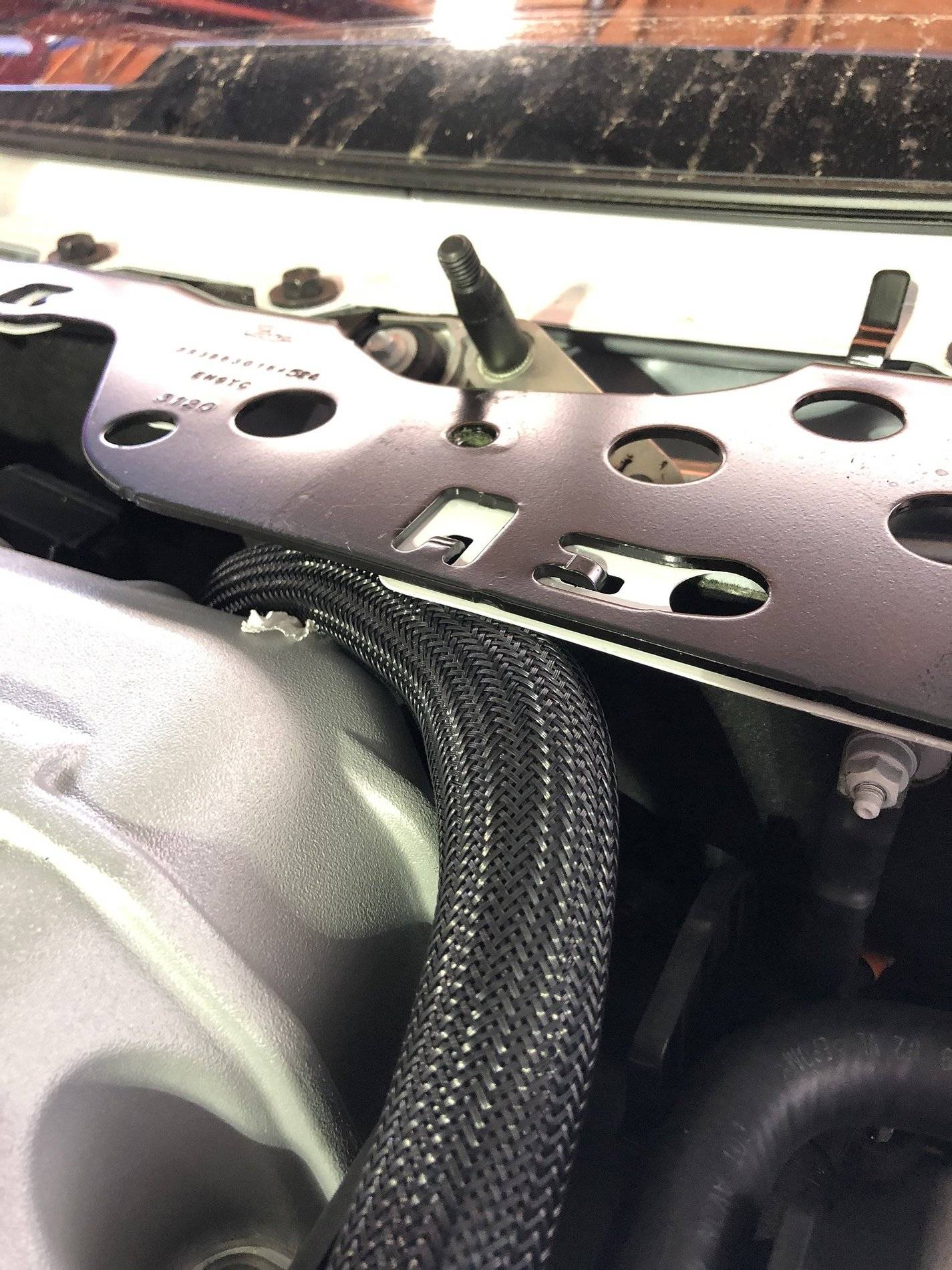

Here is a picture of a car going down the assembly line with the displaced hose prior to the strut tower brace installation. How hard would it be for the worker that installs the brace to make sure the hose is properly positioned?

So the coolant line is getting pinched between the housing and the strutbar?

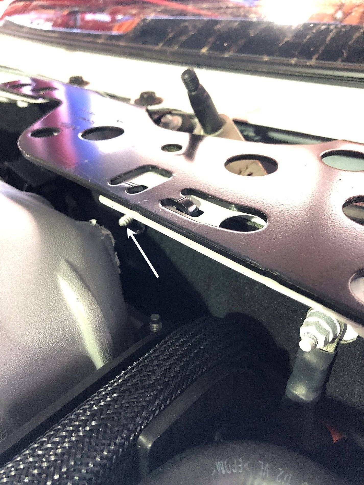

Before
After - The white arrow points out the screw that the hose hangs up on.
