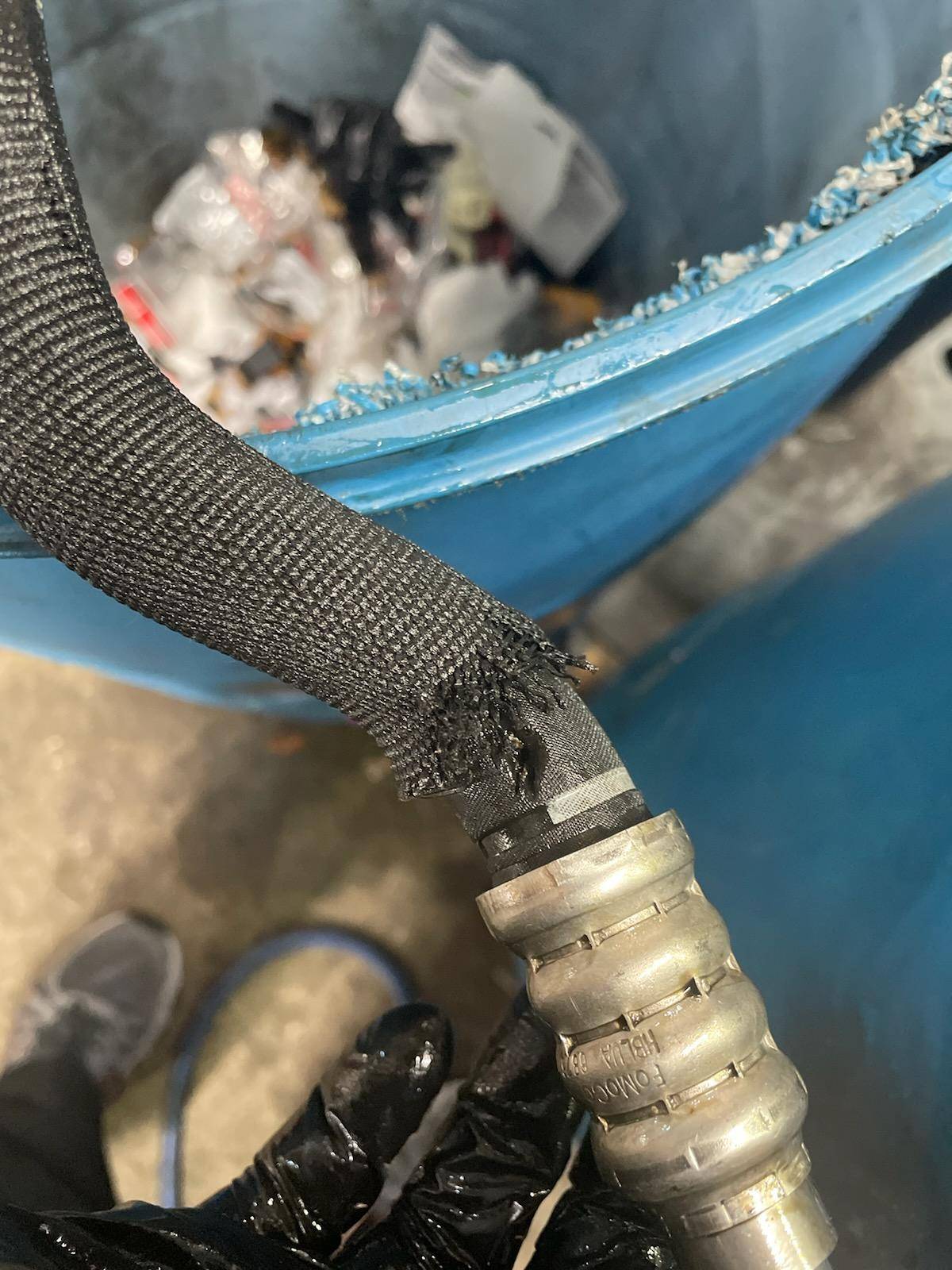

Just adding to the list of failed oil cooler lines. Was driving home from work on the highway and noticed a huge smoke cloud out of the back on my car. Pulled off to an exit and looked under in. Oil pouring out of the engine bay and oiled down the entire bottom of the car. Got it home and was look about 3 quarts. Drove it the next day to Ford. They pushed it in and said it would be a week to even look at it. Got a call after 4 days and it's an oil cool line that blew or leaked. Should have the car back in another week. Yay.
If it's possible, can you update us with a pic of the failed component?
