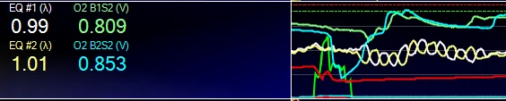

@junits15 if you wanted to play with it, you can log lambda for both banks and rear o2 voltage for both banks. Usually within the first few miles when you hit steady state driving it will perform a cat test. It alternates lambda rich/lean for both banks in inverse and looks for rear o2 switching. If it toggles high low quickly then that’s why it’s showing bad. If it toggles once or maybe twice then the cats are good. At least you can see what the pcm is seeing and confirm.

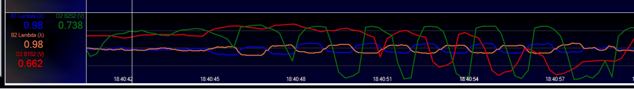

Blue - B1 Lambda
Red - B1 downstream
Orange - B2 Lambda
Green - B2 downstream
I can see that B2 downstream starts oscillating pretty much instantly, while B1 takes a while to start showing any signs. If it were a failed sensor there would be no correlation to lambda. The rest of this log is filled with similar dropouts while driving.

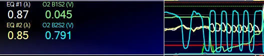

Dropouts:
red line is stable, green line drops out randomly, makes me think it could be a crack, sometimes its good sometimes it isn't.

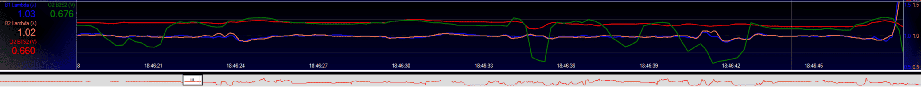

See here:
This is when i let off the throttle the red line (good cat) takes longer to react than the green one. Indicating that it still has storage capacity.
Its cooked.

Actually I think both are cooked, sad to say.
