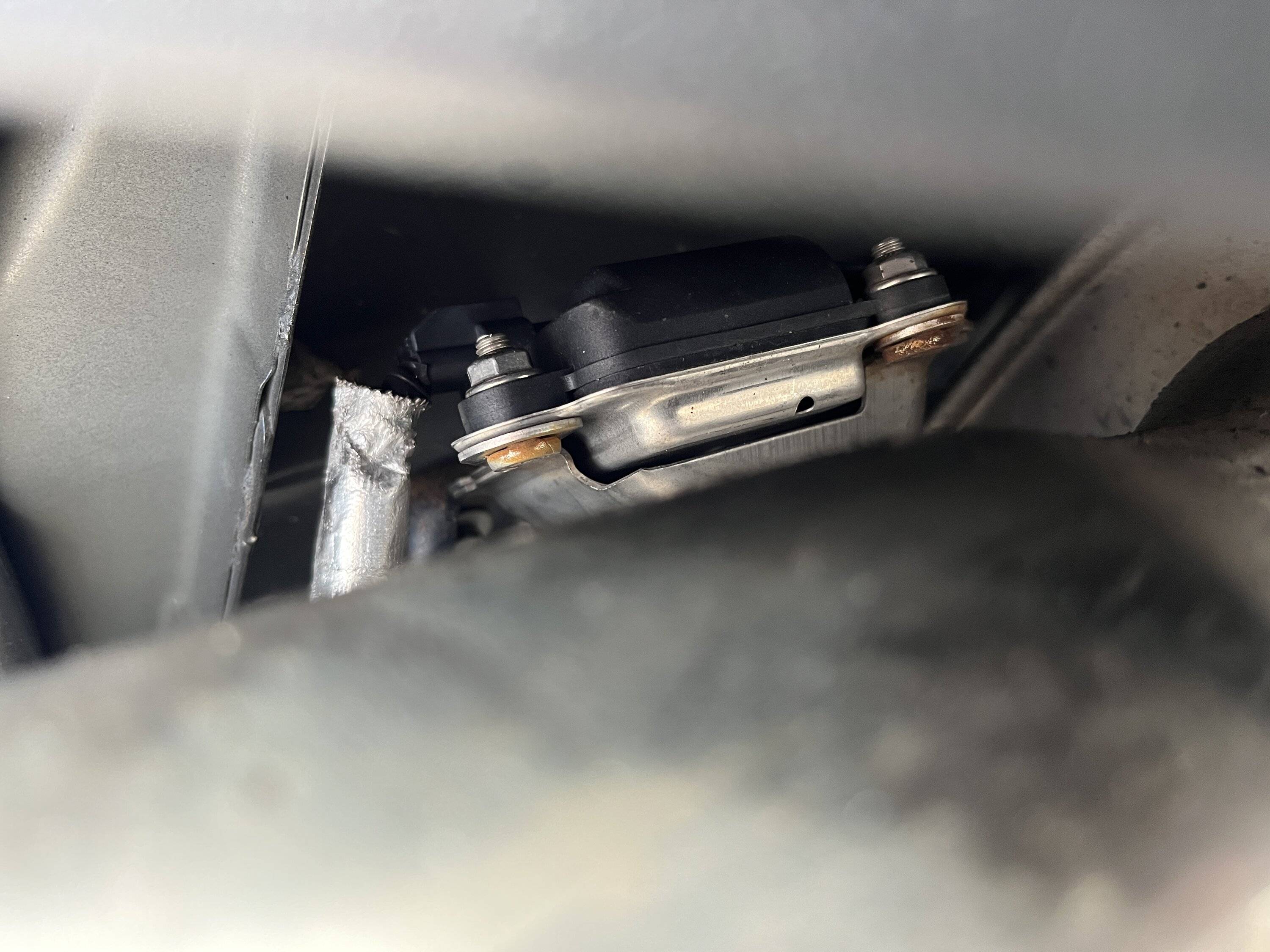

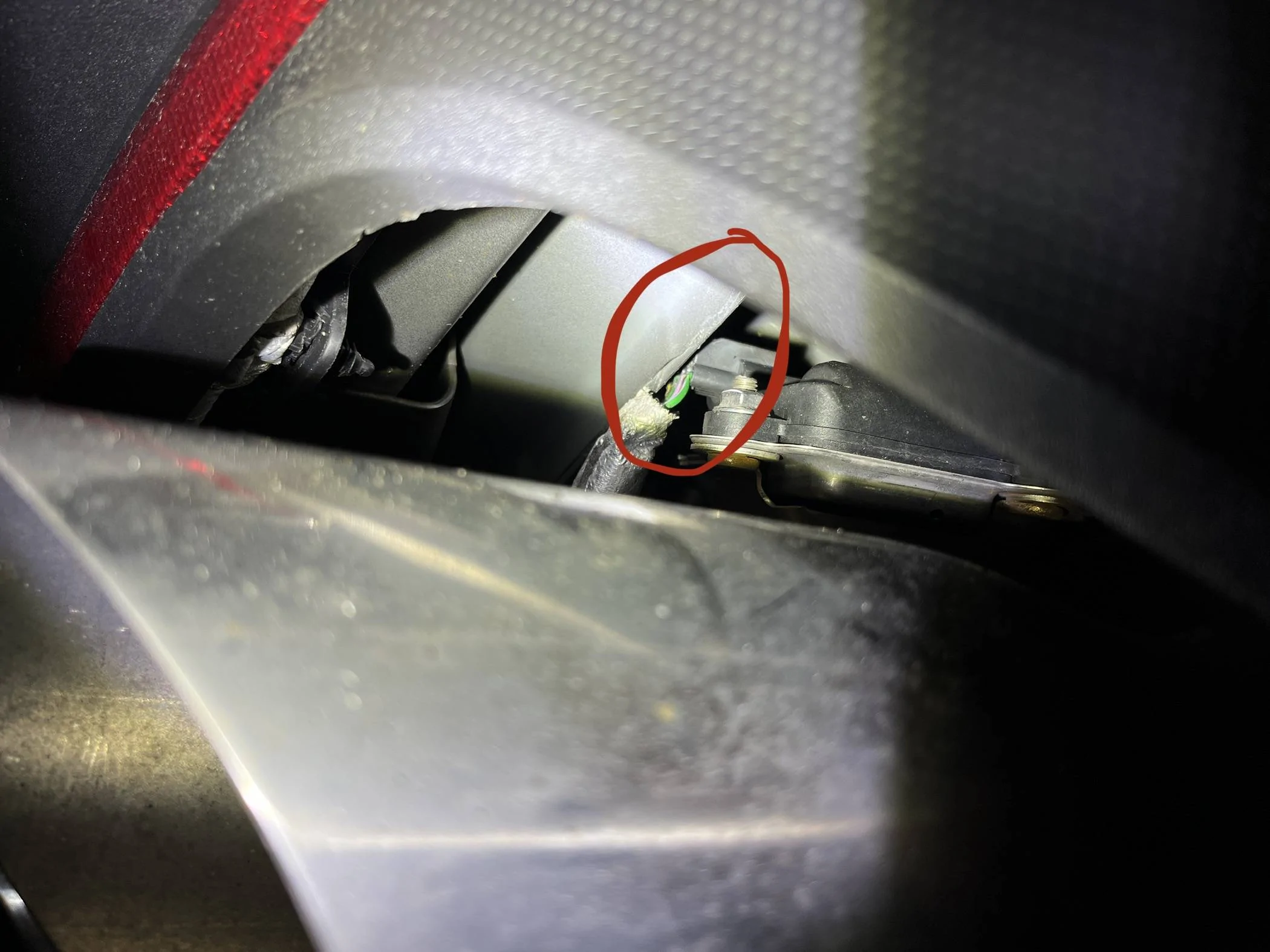

You big dumb dumb face!I cut the center muffler a bit shorter than the x pipe by accident, so the longer x pipe pushed the rear mufflers back. This caused the passenger side exhaust valve actuator wires to jam into a pinch weld. Eventually wearing through the insulation, shorting to ground, and giving the “exhaust mode selection not available” error.

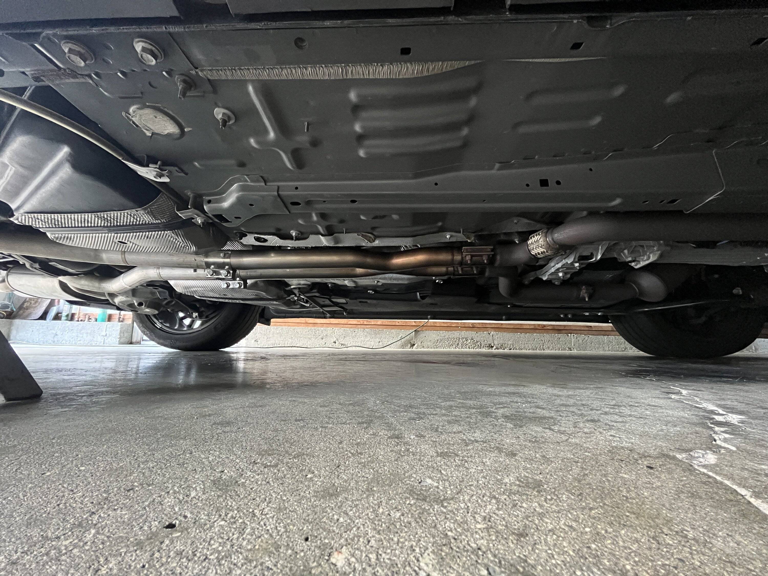

I cut another half inch off the x pipe on both sides re-adjusted and now it’s good.
before:
after:
