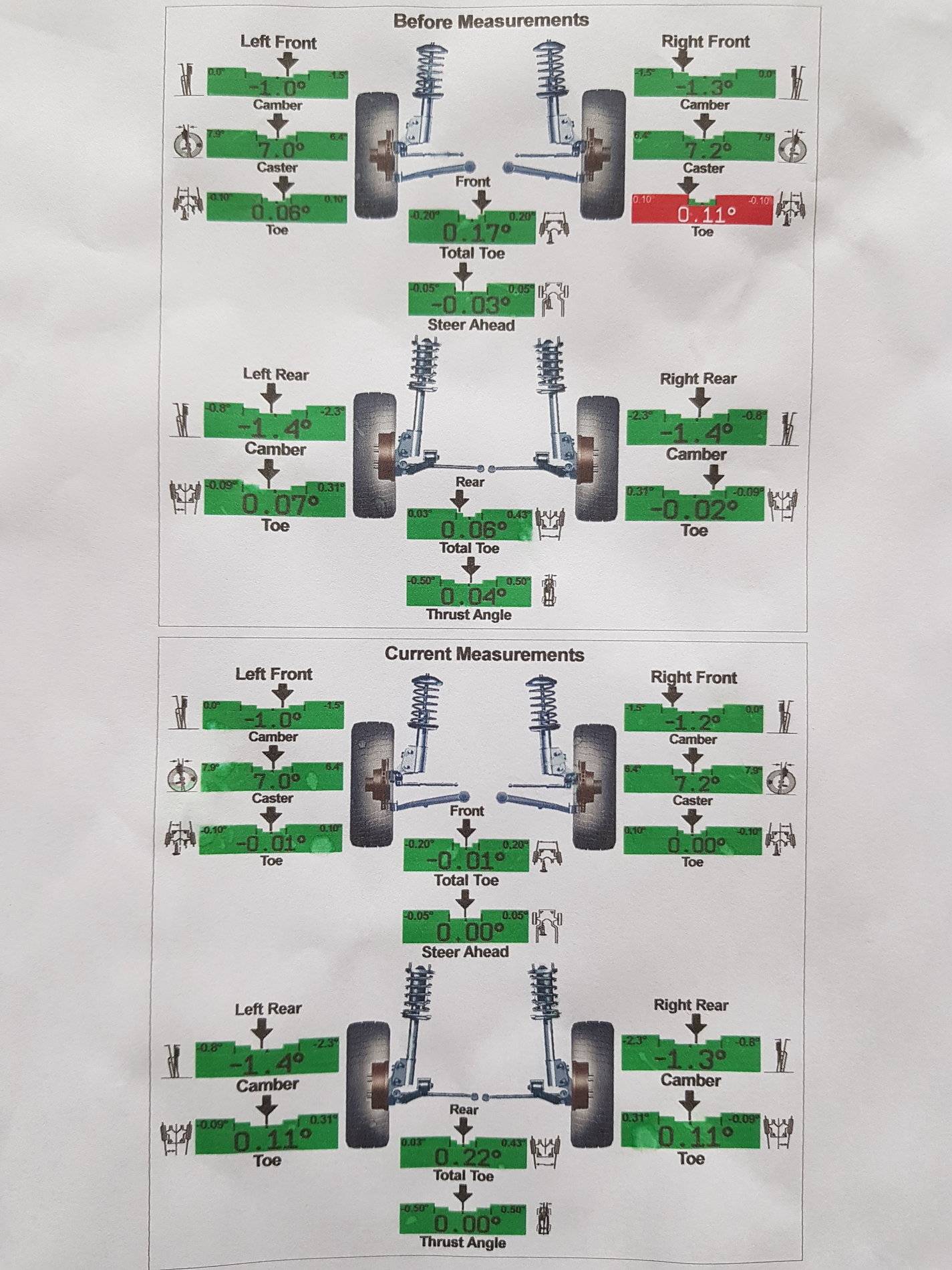

So then why am I going to be setting 0.10-0.12 toe out in the rear? Shouldn't I be running toe in then?
Was going to use these tomorrow
Front
Camber: stock
Toe: as close to 0, same both sides
Rear
Camber: -1.4 to -1.6
Toe: 0.10 to 0.12 per side, thrust angle 0.00

Well looks good now, that one front tire though was unexpected

Looks good...just so little front camber!
@Brian@BMVK, what should the optimum street/spirited driving all-stock suspension alignment settings be? Is this acceptable or even possible with stock suspension parts?:
Front: -1.3 degree camber
Zero toe
Zero steer ahead
Rear: -1.2 degree camber
+0.12 toe (toe in)
Zero thrust angle

Given that you can't adjust the front, pretty good. Is that 0.12 toe in on either side or total?
