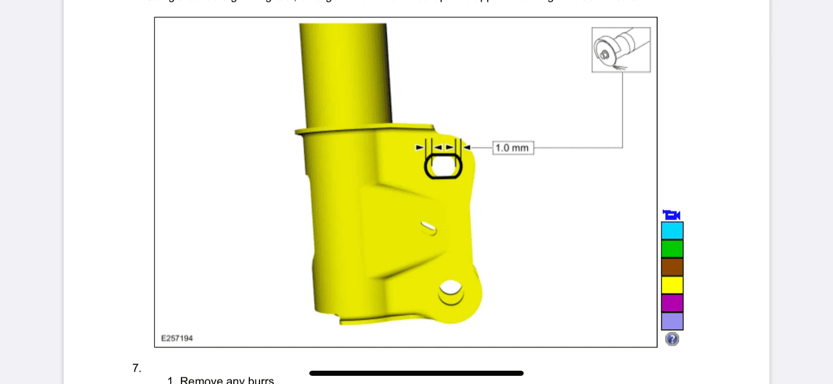

Front camber is adjusted by slotting the struts as shown.
alignment shop also needs to buy smooth shank service bolts because the splined factory bolts are horrible.

Do alignment shops perform that work? or if I asked for front camber would they just go ahead and widen those slots?
if you slot them, (which can get you a little bit of camber at the expense of wheel to strut clearance, I recommend wending in some metal back into the slotted hole to lock the bolt in it’s new home. They aren’t slotted by default for a reason, they can slip.
I used to have mine slotted and slipped on w/in 20 minutes of leaving the alignment place. Another loosened up later and went banging around until I caught it. Nearly destroyed the strut itself. Careful slotting things.

Camber bolts are an easy way to adjust front camber. You can buy them for cheap. It's fine for street use. When you do get the CC plates, I'd put the oem strut bolts back though. One less adjustment to have if you are running CC plates.
Im not saying it didn’t happen, but considering that the torque spec for these two cross bolts is 184 ft-lb, I suspect someone goofed in putting your car together properly.
you would slot the struts before going in most likely.
Yeah, possibly right. Or reused bolts when a new one was needed. Either way slotting is not the preferred method of getting camber, that's what Camber plates are for.
Slotting is cheap if you can do the labor yourself, but if you can't, you might as well pay for camber plates.
On my S197 I had both maxed out camber plates and 2 mm of slotting on the struts. So much glorious front grip...
