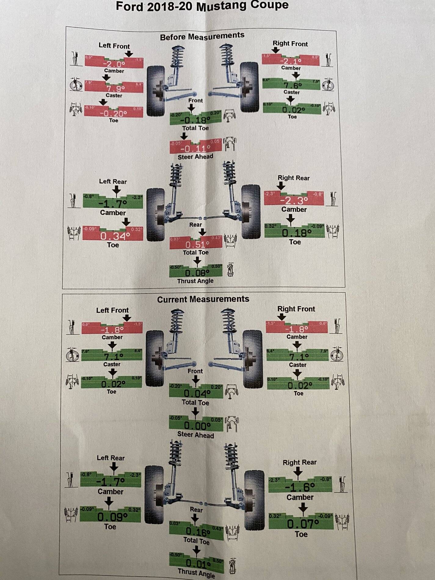

Got an alignment yesterday.
Car is lowered on Eibach prokit springs, camber plates with proaction shocks/struts. Car is DD with occasional drag races, but def looking to get into autoX in the future.
Overall, I think car drives great and bumpsteer was noticeably reduced following alignment as well as tramlining (255 F tires / 305 R).
Just wanted to get thoughts on what y’all think. Is the rear toe okay or should I try and get it within 0.10-0.12 per side (total 0.20-0.24)?

I doubt it'd be worth the effort to change the rear toes by 0.04-ish degrees, considering that you might end up chasing camber as well. Serious autocross use would probably be better served by 0.05° individual toes / 0.10° total.
Look through posts by BMacIL / Brian@BMVK.

So far, I really haven't found an upper limit on front camber for autocrossing, so if you're going to play with little orange cones, going to maximum negative camber (which makes toe go in the 'out' direction) is a good start. Mark the original position so it's easy to return to baseline.
