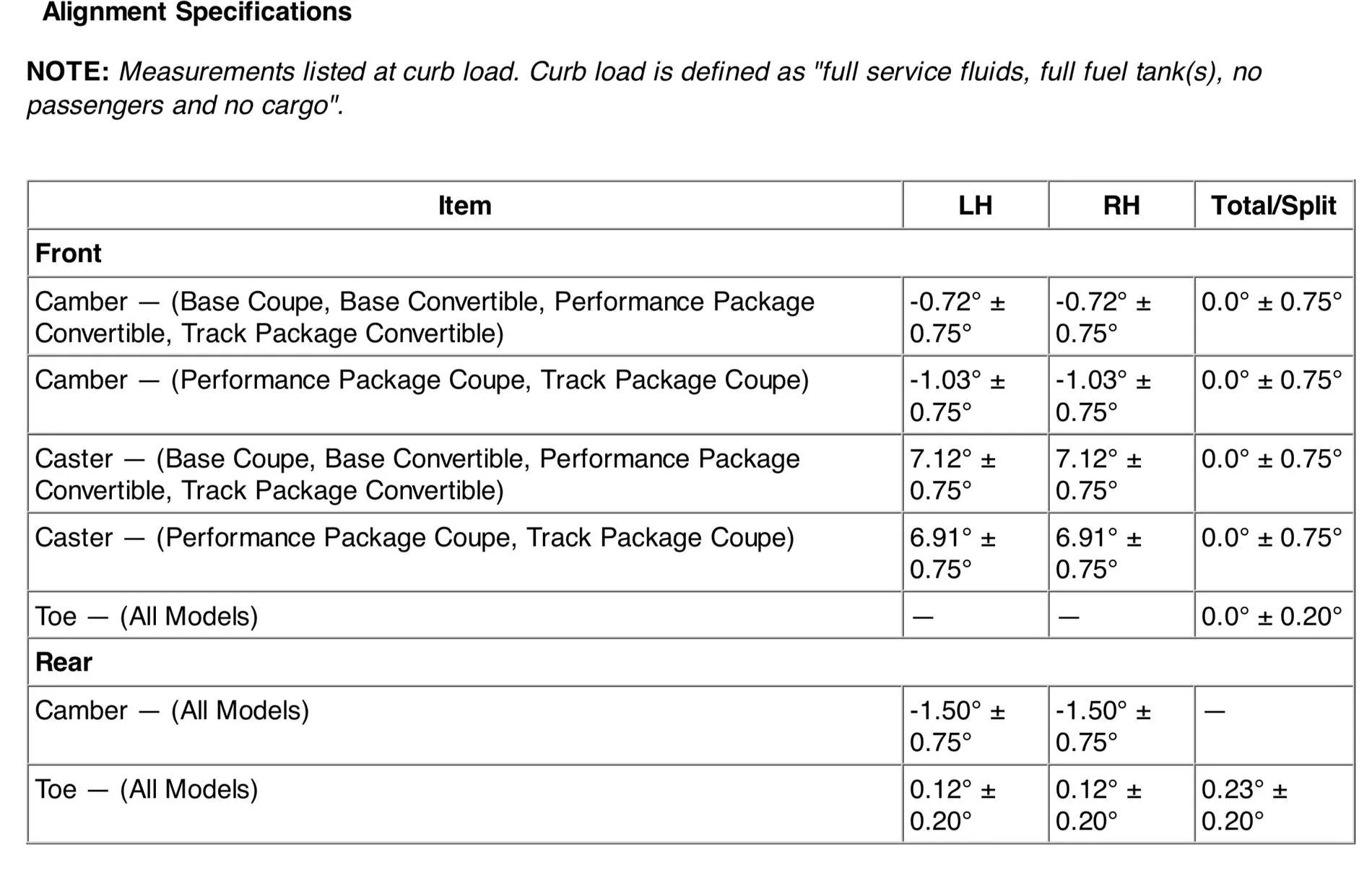

Norm, JC isn’t looking for any alignment advise. He’s just looking for the numbers. Why? Just because he’s curious. :like:
JC, if you really just want the numbers go here.
https://www.alignmentspecs.com/mm/mustang.asp

I found the alignment settings for 2016 Mustangs. I see no reason why the Bullitt would be any different than the Performance Package 1 settings.

Thank you for posting the factory specs. The main numbers sound about right, but you guys weren't kidding when you said the tolerance was ridiculous. It's beyond that at 75%. It's -1.00 +/- 0.75 in front, and -1.3 +/- 0.75 at the back. So yes, impossible to rely on -0.25 to -1.75 front and -0.55 to -2.05 at the rear. I bet you can't get beyond those figures even if you wanted to, so basically all cars are aligned properly. Ha ha.

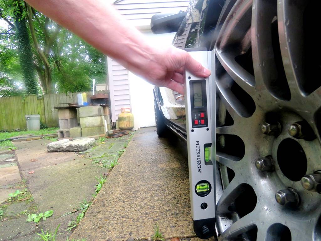

Finally, I might do some research on how to measure my alignment specs, but only if it can be done with a good degree of accuracy
With a little patience - and a setup area either known to be flat and level or with at least a known sideways slope - you should be able to get to within about ±0.1° with one of these. Just take a little time centering the bubble; on this gauge from centered to the edge of the bubble touching one of the lines is about 0.3°.
Within 0.1° is more than good enough for any street driving and most track driving.

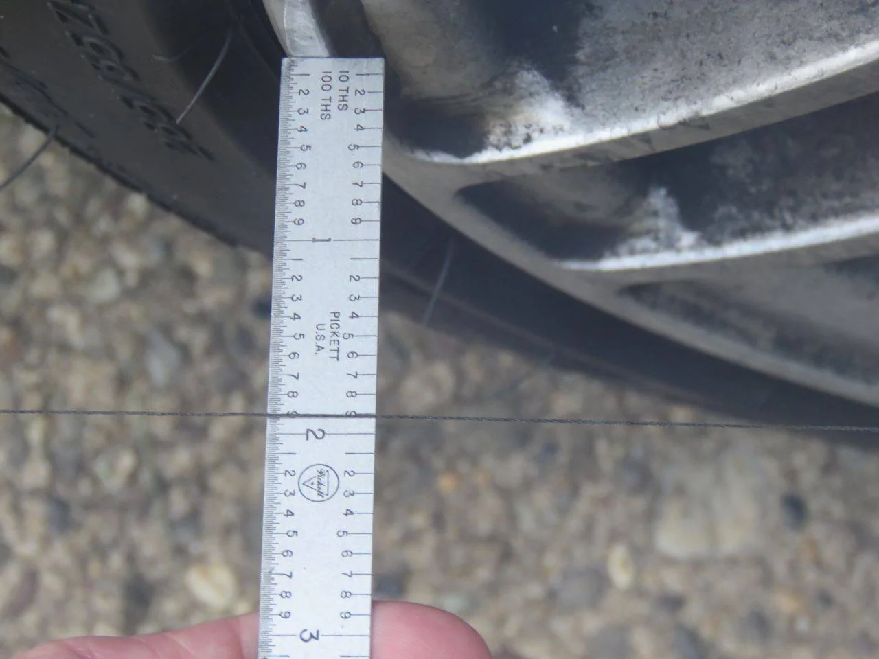

Well, you sort of can eyeball toe, at least for some cars. It would probably be trickier with IRS, though. But you can set up a pair of parallel strings and actually measure it (there's something called 'Smart Strings' that takes the sting out of getting the strings parallel). Basically, you'd be doing this, plus a little trig. I use thin thread and a scale that reads to 0.01".
