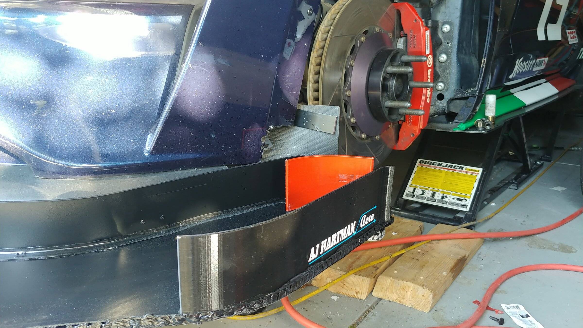

So I know this discussion started as an 18+ AJ Hartman Aero thread, but with such limited info about his parts elsewhere on the forum, figure this would be as good a place as any to post up pics of how my air dam/splitter/canards install went. I can't take credit for how it all came together; a good friend conjured up the idea, then designed, waterjetted and welded the final product together. Very happy with the end result and will be putting the car through its paces in (2) weekends @ Thunderhill. Will be sure to post up pics, vids and data on my FB racing page afterwards.
End result. Tough to tell from this angle, but the splitter and canards line up perfectly with the tire and should do a great job directing proper airflow:
Quick release mechanism, to aid in fast R&R:
Waterjetted pucks turned on a lathe to distribute load and provide protection for the carbon fiber:
Height-adjustable front chassis mount:
Rear chassis mount:
Quick release pin:

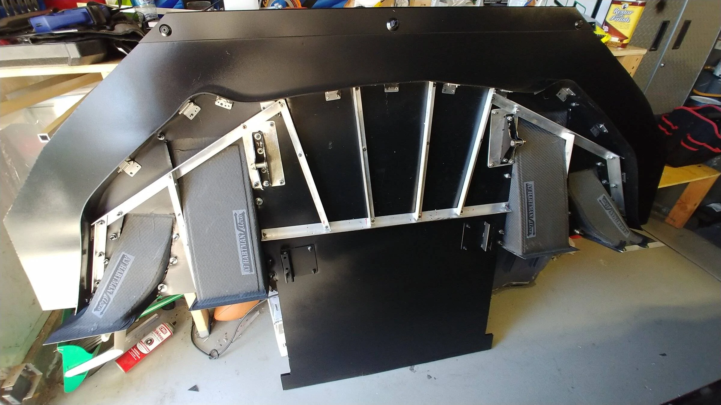

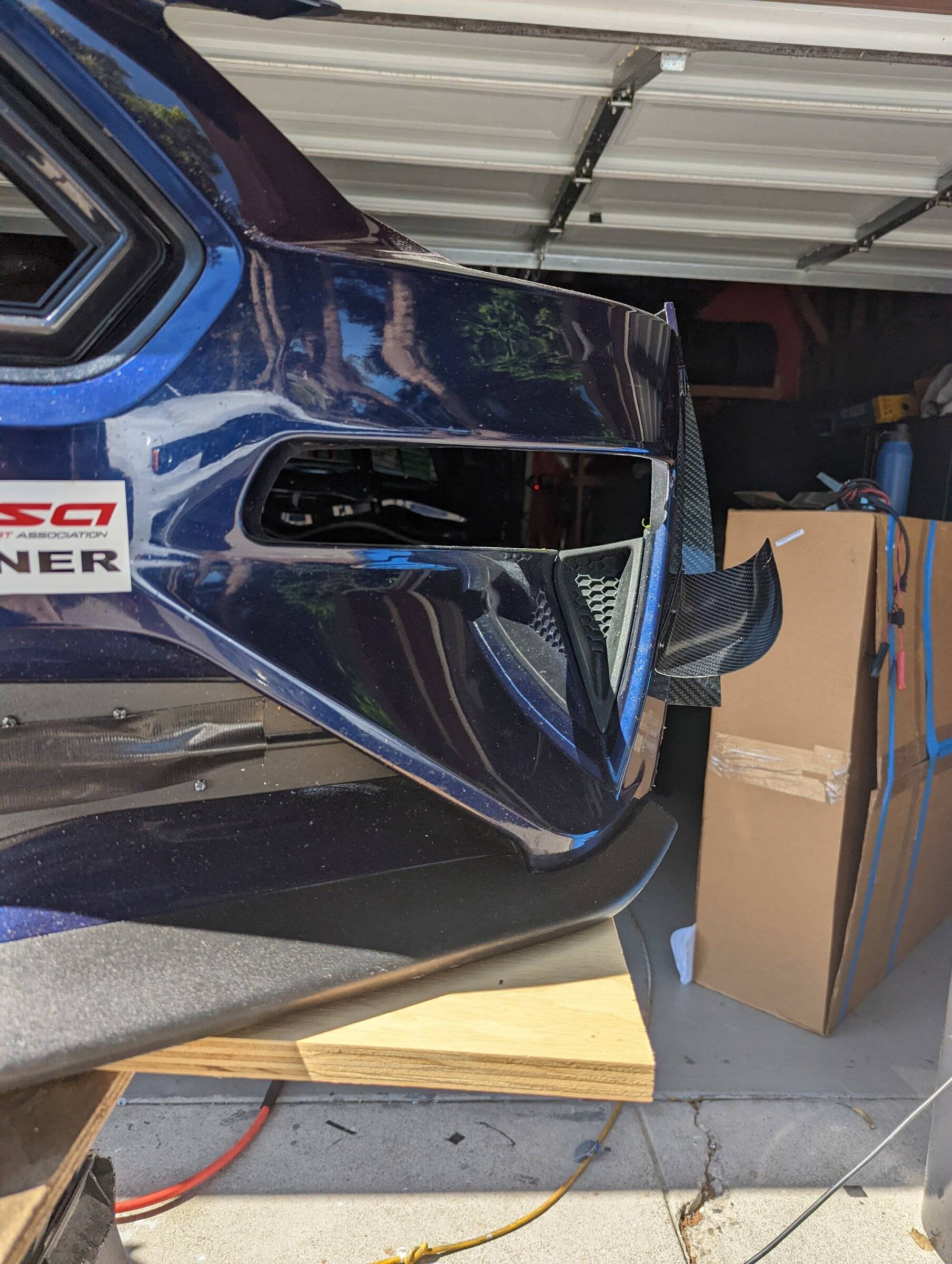

Latest Splitter
Name ROMA.
MAX front downforce (estimate 500lbs +) @100mph
Just added canards.
Splitter is also paired with multiple hood and fender louvers
Rear wing is FULCRUM 14 by AJ hartman

@Performance nut
Thank you sir.
1. I 'evolved to a performance product lol
10 ft Roll of Airdam/Body... https://www.amazon.com/dp/B07B8TYCW4?ref=ppx_pop_mob_ap_share
2. Not really. I have no deflector and i also removed the hoses. I measured temps and they are actually under control just with the 2 piece rotors. However i do time trials so for endurance racing i would consider a different path. In a recent discussion in a. Aero forum they asked exactly this question. The answer was u can point up to 10deg towards the deflector.
3. My tires are 315mm on a 18x11 wheel.
The reason why i used the curved 'smaller' tunnel instead the big one is to go 50% out the tire.
More over consider that i have tire deflector tire spats and side plates to 'deviate air stream around the tire i creasing the air extraction from beneath the splitter (=more DF)..all in combination with the side fender vents to.reduce even more the air pressure in the fender well

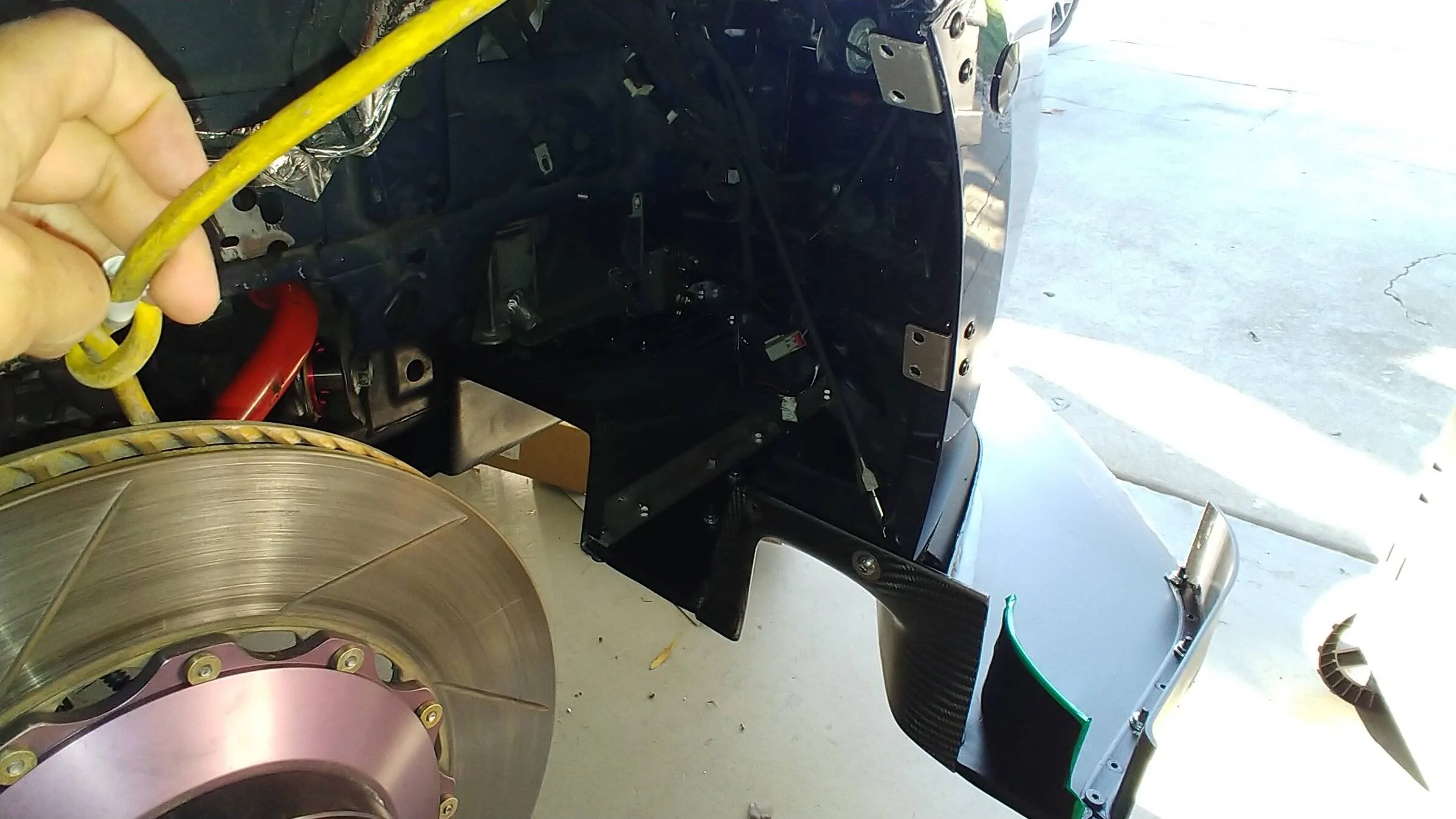

I'm actually doing a lower DF Splitter right now in wood with smaller tunnells pointing to the deflector :)
I might use it in high speed track.
Right now the ROMA splitter.is.producing a shit tona of DF meaning high angle rear wing. Not ideal in high speed track such willow springs.
You could probably just fab some detachable panels to close off one or both front diffuser sets?
