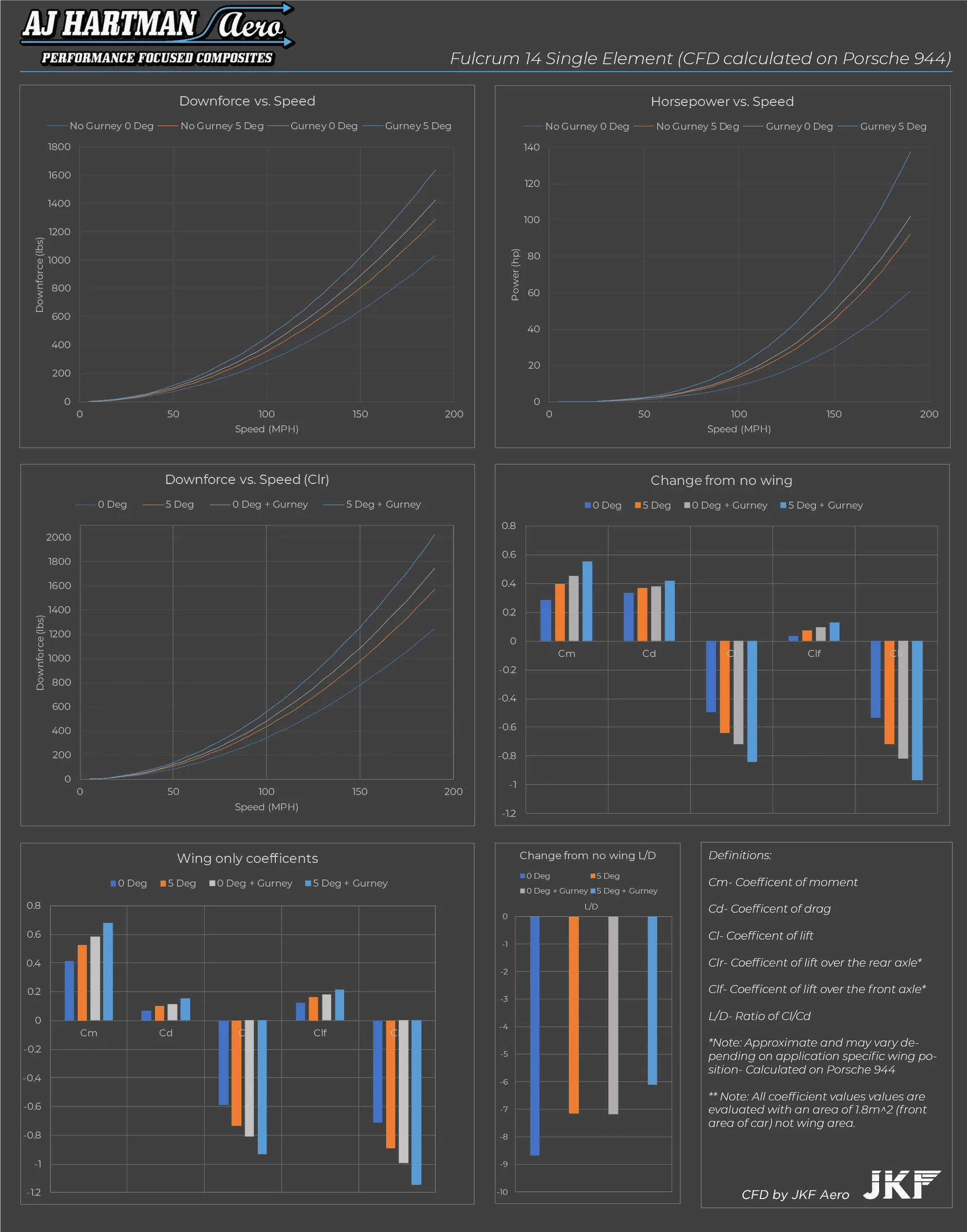

Well i was there with the AJ wing at 3deg and gurney flap which generates about 500lbs at 120

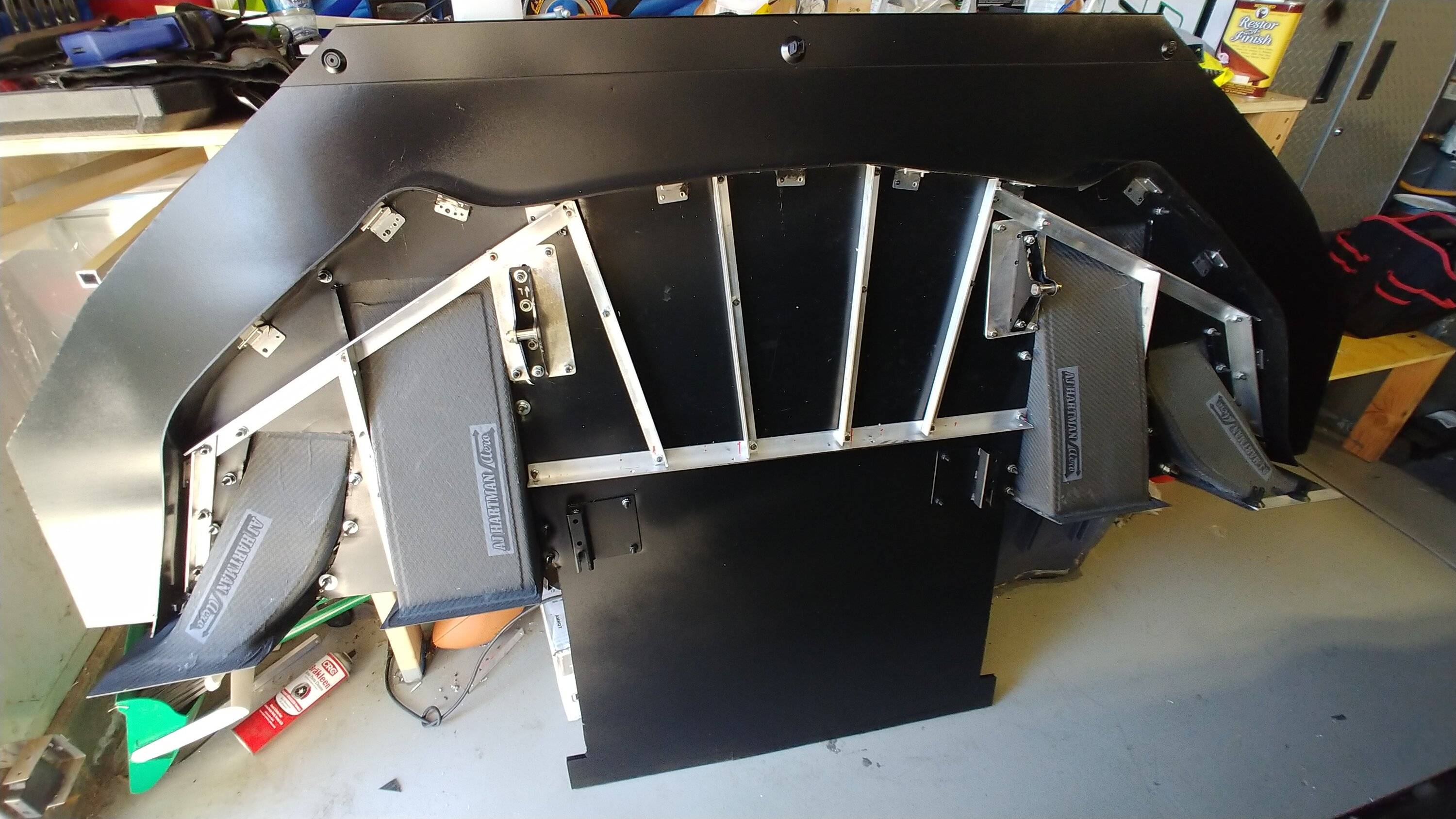

The splitter was the "old" one with 2 smaller prof awesome tunnels at 2.75"from the ground
I was able to sustain 147mph in t8 closing at 1:23. Which was 3 sec faster than previous one. The car was glued. (did u watch the video?)
The new splitter gets balanced at Sonoma with a 7deg wing angle.+ Gurney
At that angle we are around 70-80Hp loss.
Like you were saying I'm looking for balance. Car was balanced.
At Daytona i would have been 3sec slower with a 7deg wing 😅

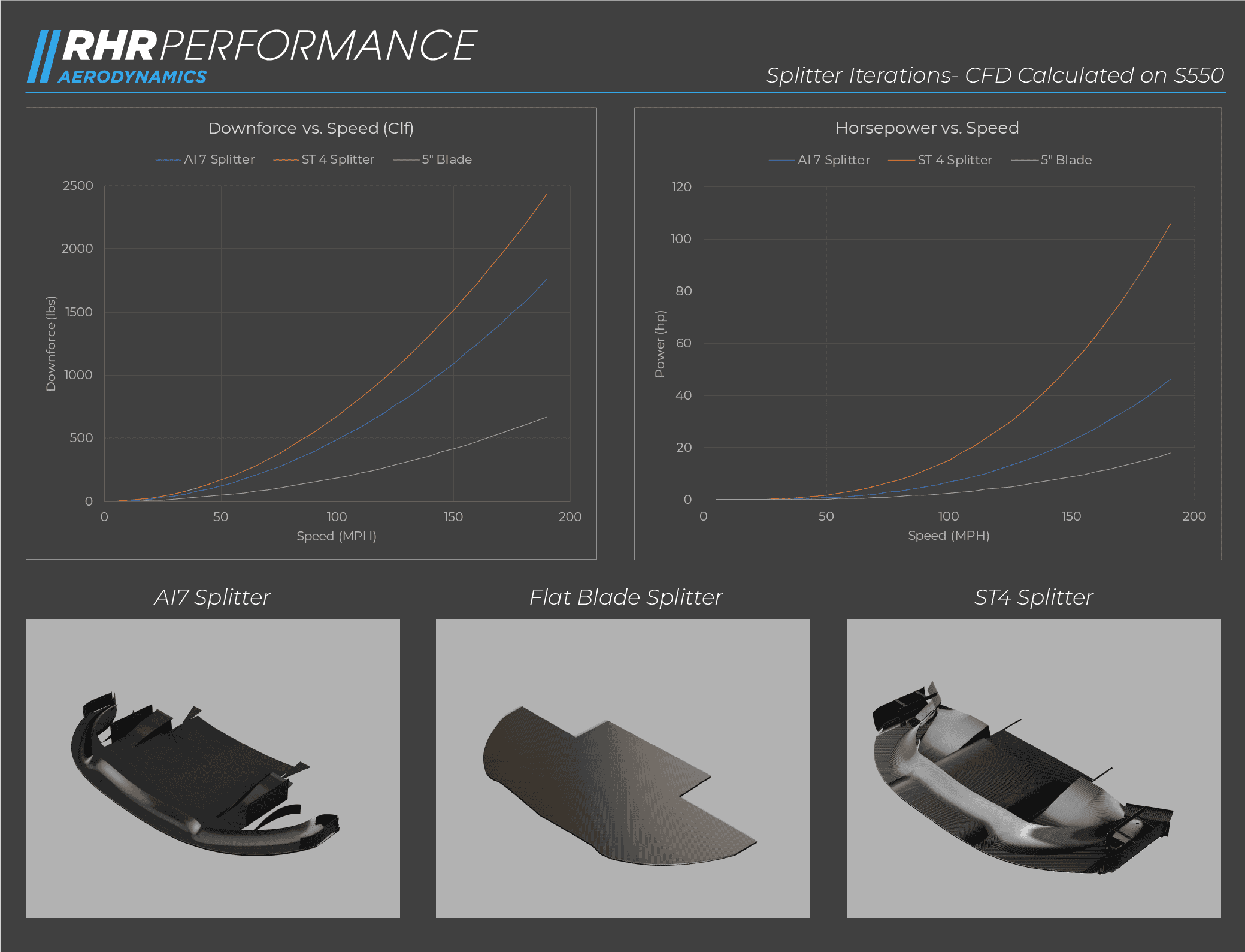

Splitter performance comes from 4 main factors.
1. Size.
2. Height from the ground.
3. Front diffuser.
4. Shape
1. Size matters. Lol. How much lip you want depends on you and the competition rules u do. Usually between 4 and 6 inches is a great target
2. One of the key factor. ~3" from the ground is the 'magic number' here. More and the effectiveness of the splitter is reduced .less and u destroy it every time you brake (if u dont have enough springs)
3. This can multiple downforce.
4. Shape is more about how far back you want to go with splitter and what about the side part where you will have side plates canards and tire deflector.
NUMBERS.
a only blade splitter is about 150-200lbs DF @100mph (from now on DF is always referred at 100mph)
Side plates and deflectors can add another 50-70lbs (but increase drag too) . Canards about 20-30but more important canards help reducing drag and improve overall aero performance.
Front Diffuser well...we can discuss years here. 2 pairs of AJ diffusers can double the DF(SEE PICS)

AJ WINGS are master pieces. fulcrum 14 is an excellent piece can sustain and balance a splitter from a flat blade to a more complex front diffuser blade. (Just changing the Angle of Attack)
APR 250 is a nice "base" wing that produces leff DF and less drag. It is good to balance a blade only solution but cannot balance a bigger splitter.

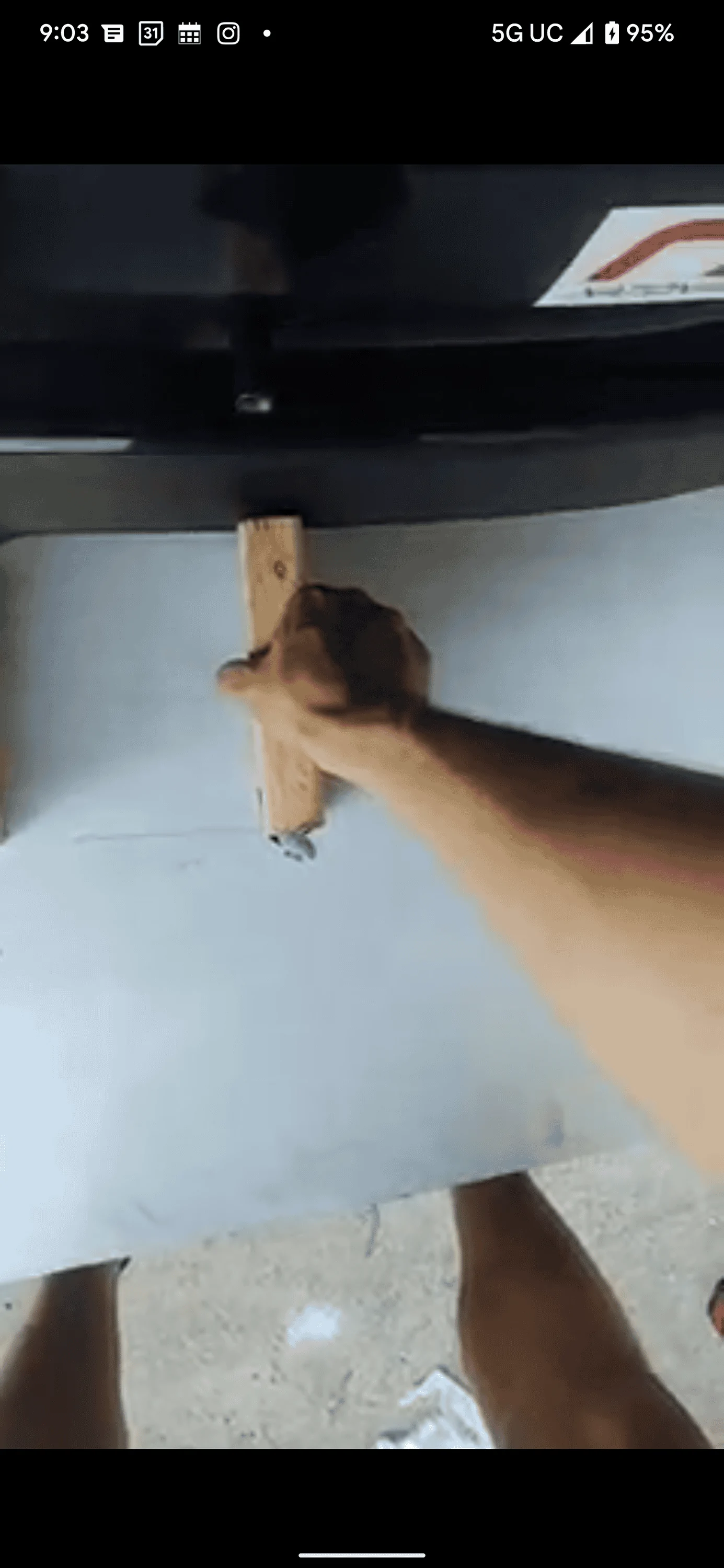

You're reading my mind. I was thinking birch sheet with a layer of S-glass on top and bottom. I might locate it with the stock splitter, but the idea is to support it properly off the chassis.
Do you think one of those cheap-o PP2 splitters off of Ebay would make a good template?
Pp2 adds 16lbs of DF to make a template is super easy. Put a 4x8 sheet under the car. And trace it witha block of wood and a sharpie🙂
