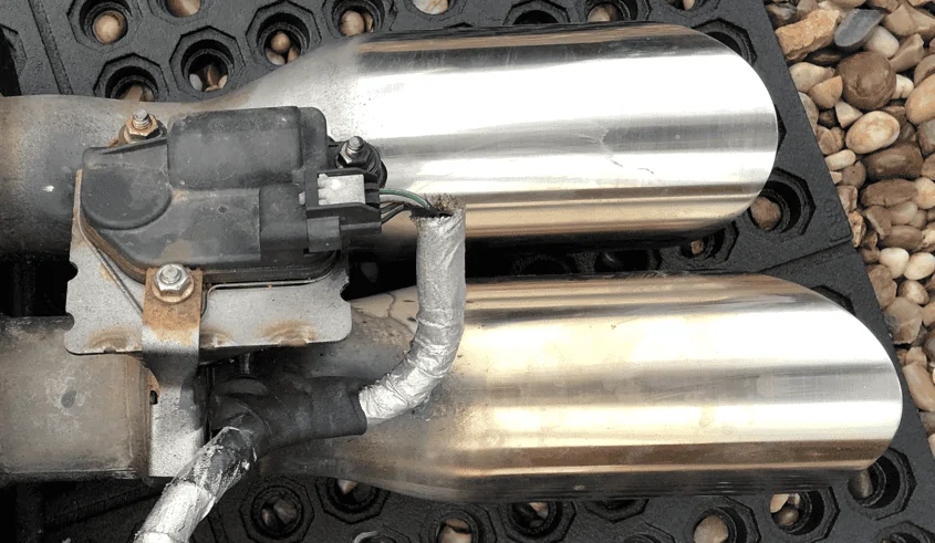

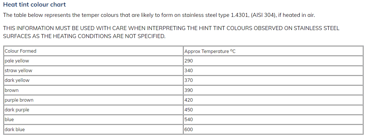

Spotted this (it was more obvious in real life) :
Compared to this :
So I pitched in at 350°C 🤷‍♂️
My H pipe is really colourful ...

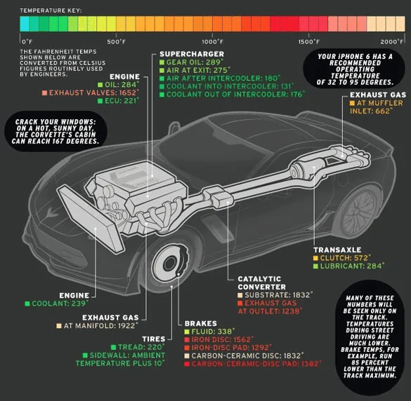

OK, it's a Z06 but :
I don't know what effects the euro GPF has on exhaust gas temp when it's doing its regen thing ? (If it's anything like the DPF on my diesel it will raise it).
I understand this is why most performance exhausts have double skinned tailpipes, it hides the discolouration that you can see on my photo above.
Note that it's only the straight through pipe that discolours, the muffler takes too much heat out of the other pipe.
How would you interpret the photo of my exhaust (on the valved pipe) v the colour chart I posted ? :like:

A: Many of the numbers on there are clearly bullshit guesses. Or on-track maxes.
B: "euro GPF" means absolutely nothing to me and most people here. So whatever point you were tying to make was missed.
C: The "discoloring" could have nothing to do with extreme temperatures, and everything to do with whatever got on the exhaust at one point or another. Like washing soaps, spray-on waxes, road-crap, etc.
WD Pro
Jan 18, 2018
132
6,798
13,640
United Kingdom
Lime GT
As you are clearly being argumentative on this I won’t bite on A and B, you can find that info yourself.
C : was on both mufflers, on one pipe on each, on the valved pipe on each. They are close enough to get treated with the same products and same conditions.
D : You didn’t answer my question.
E : I’m out, unless I can offer more help to the OP :like:
