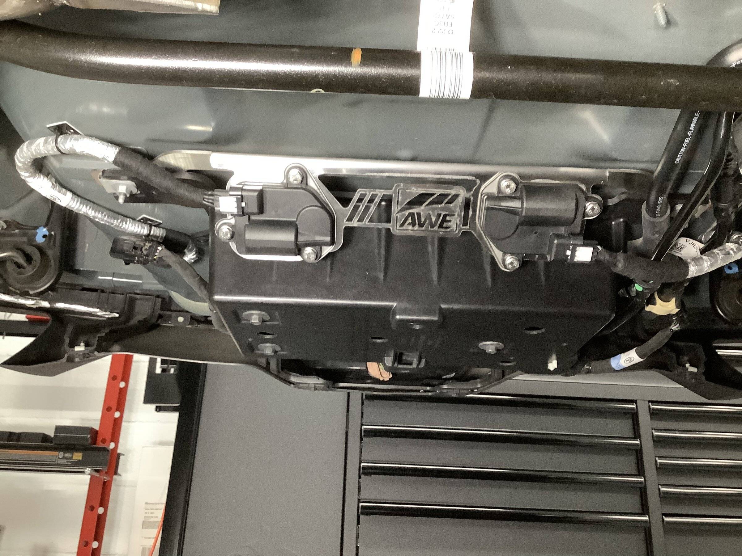

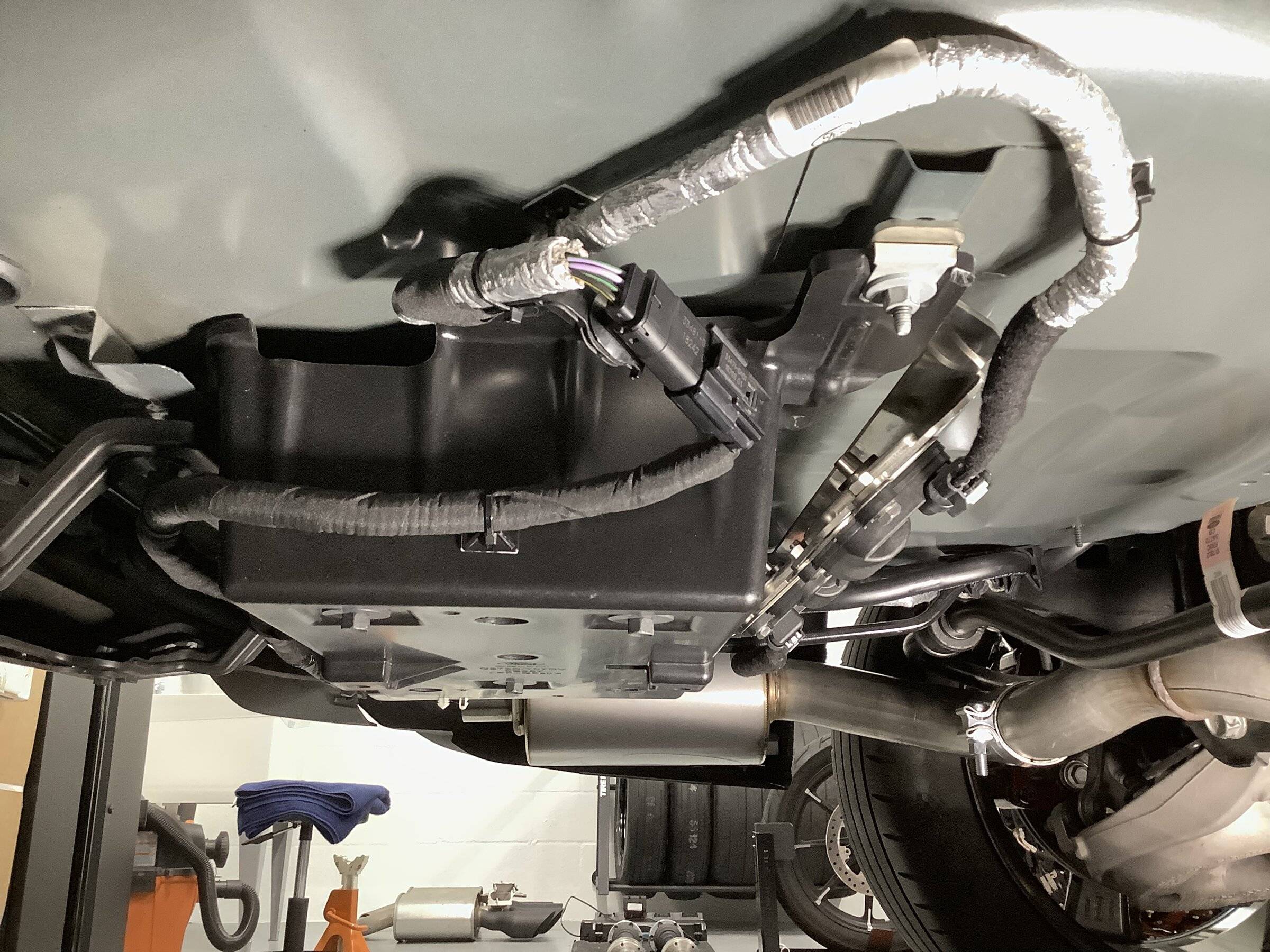

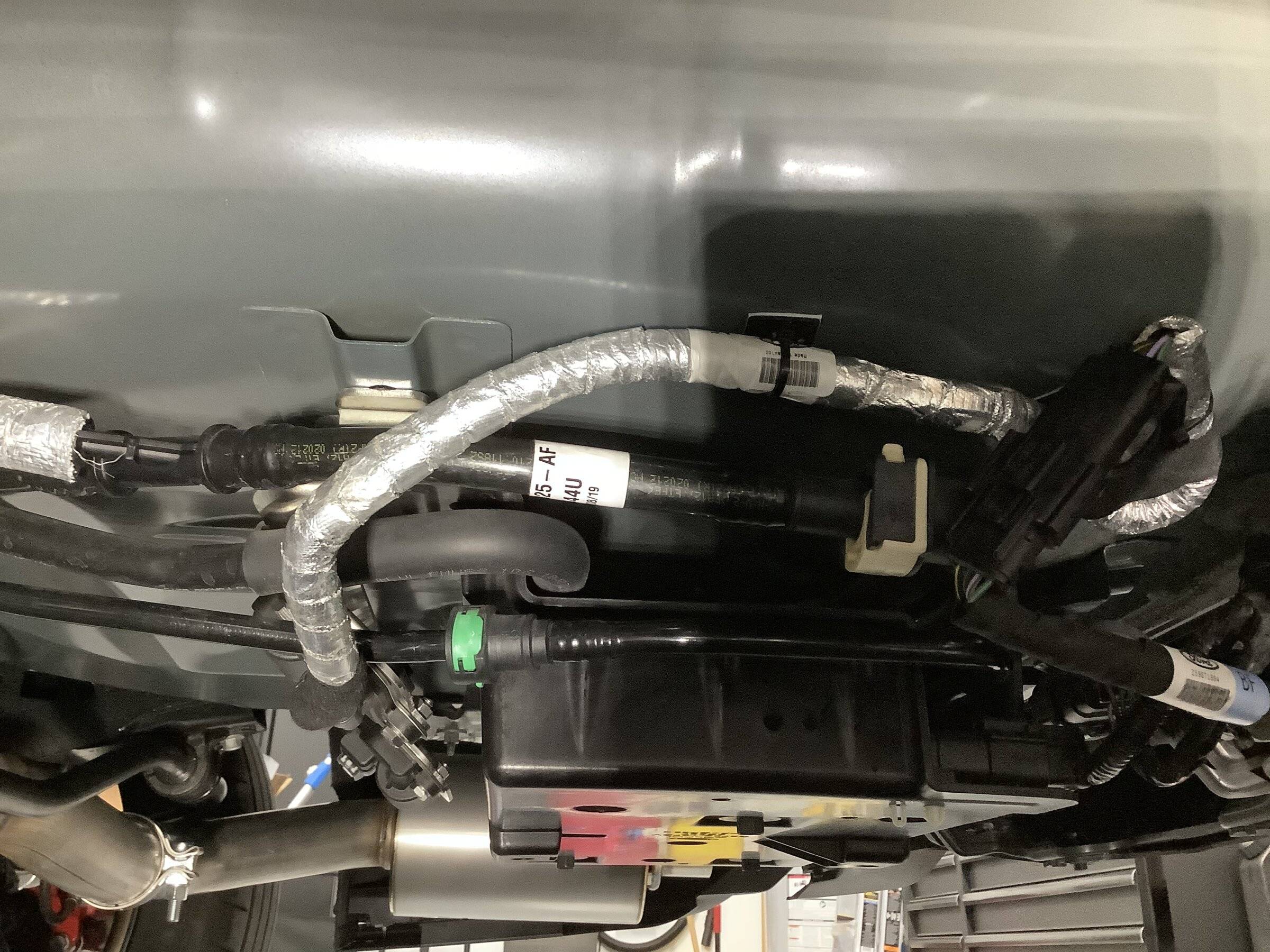

@TonyNJ, here are a few pics of the final install of the AWE actuator bracket installed. Bye, bye “Exhaust Mode Malfunction” indicator light!

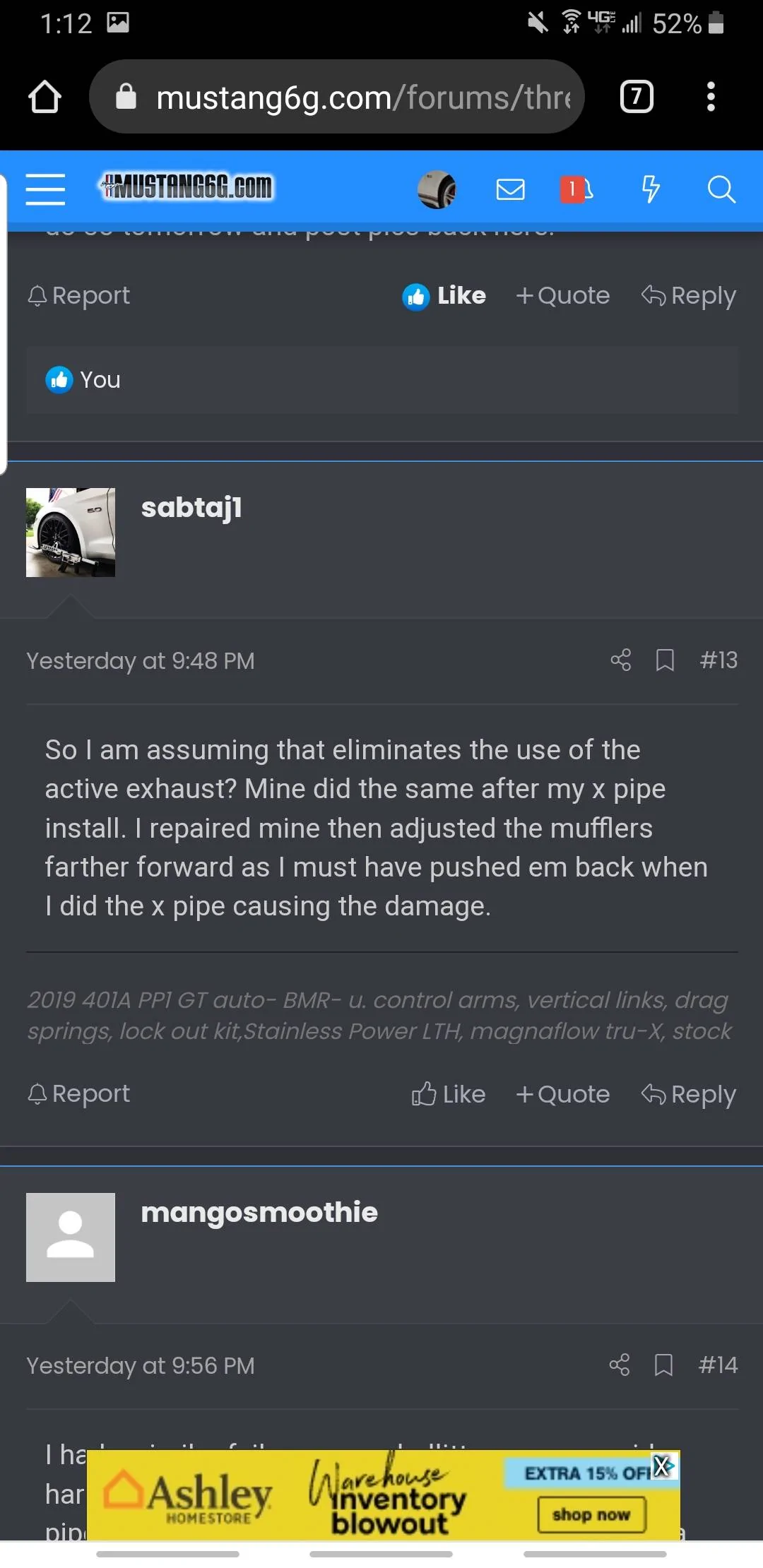

Wow. That's clean. This guys reply to your thread confused me. You repaired the AE, not bypassed it, right? Not sure what he means about eliminating it.

@TonyNJ, you and sabtaj1 are both correct. I did repair it; so let’s say your AE passenger side harness shorted out like mine did, you can fix it and get back into the game (keeping the factory AE exhaust and be able to switch between modes, just as the car came from the factory), although the problem could resurface, unless you clearance the pinch weld area directly behind the connector. I was going to do this at first by carefully using a Dremel tool to cut out a channel in the pinch weld and then apply some rust inhibiting black paint on that area, but decided against it. Now, I no longer have a functioning AE because my Steeda axle back does not have this feature. What the AWE bracket does, is simply relocate the actuators and allow me to plug up the factory AE wiring harnesses, so that the computer thinks the system is functioning properly and it won’t throw the light on the dash. That’s exactly what I was looking to accomplish with this mod.
