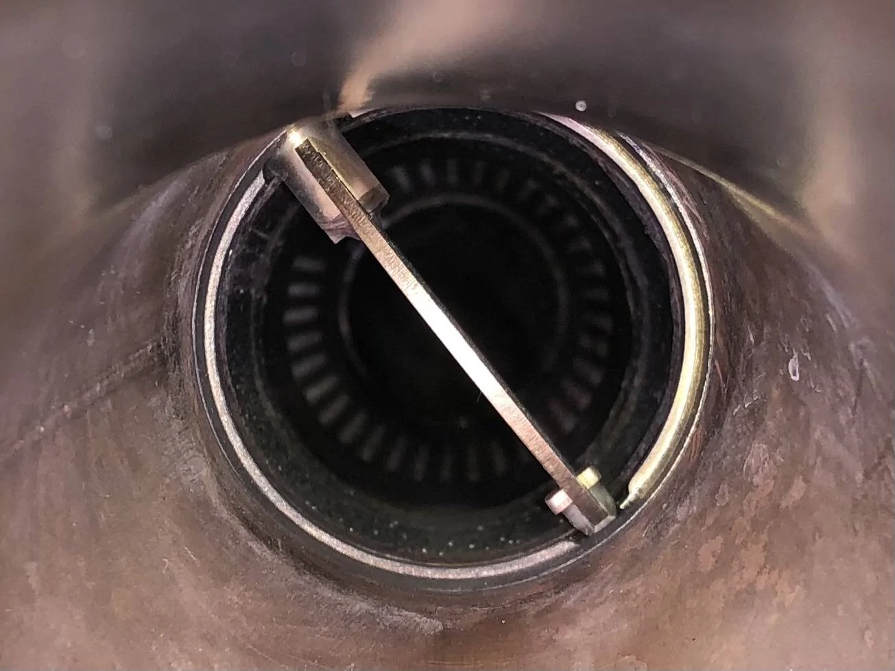

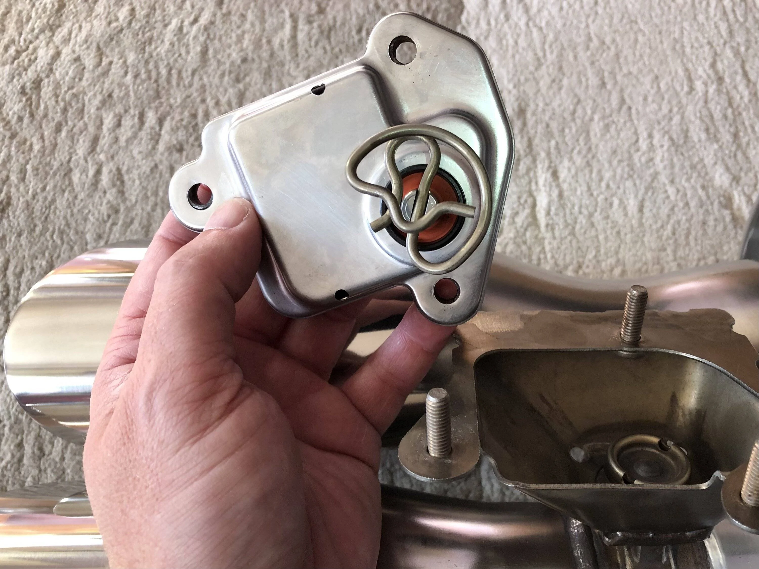

You would have to be spraying in the wrong places for it to get within the vicinity of any electronics :like:
And there is a nice lip seal on the shaft to help protect them :
Can i do this with exhaust on the car??
Thanks Ant
You can get to the top of the pivot shaft with a straw through the holes shown above in the mounting plate.
Then looking up the inside from the rear end (and once you see lubricant seeping through from the top), you can hit the top and bottom pivots from the inside :

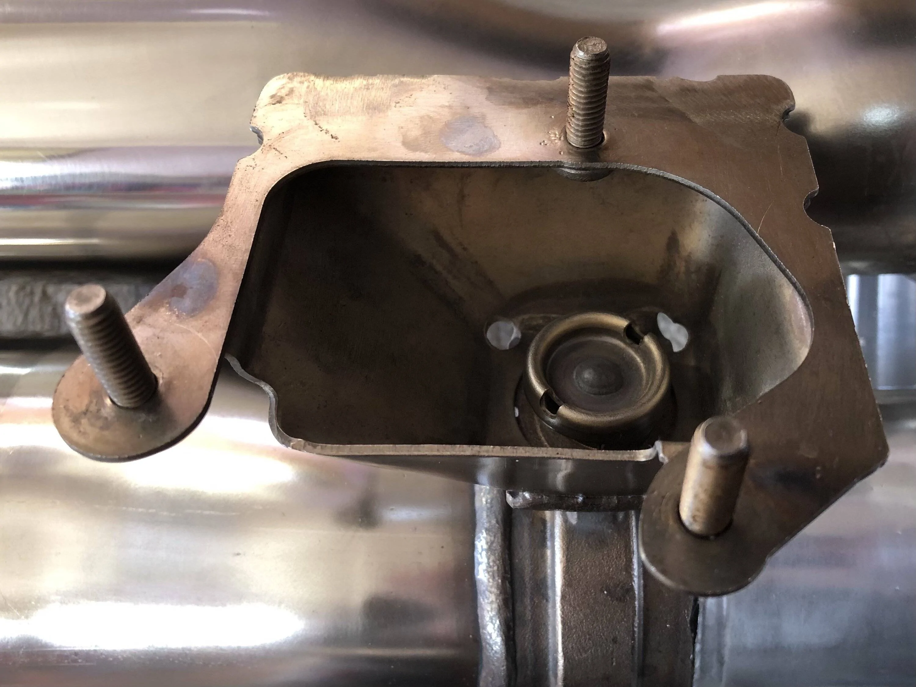

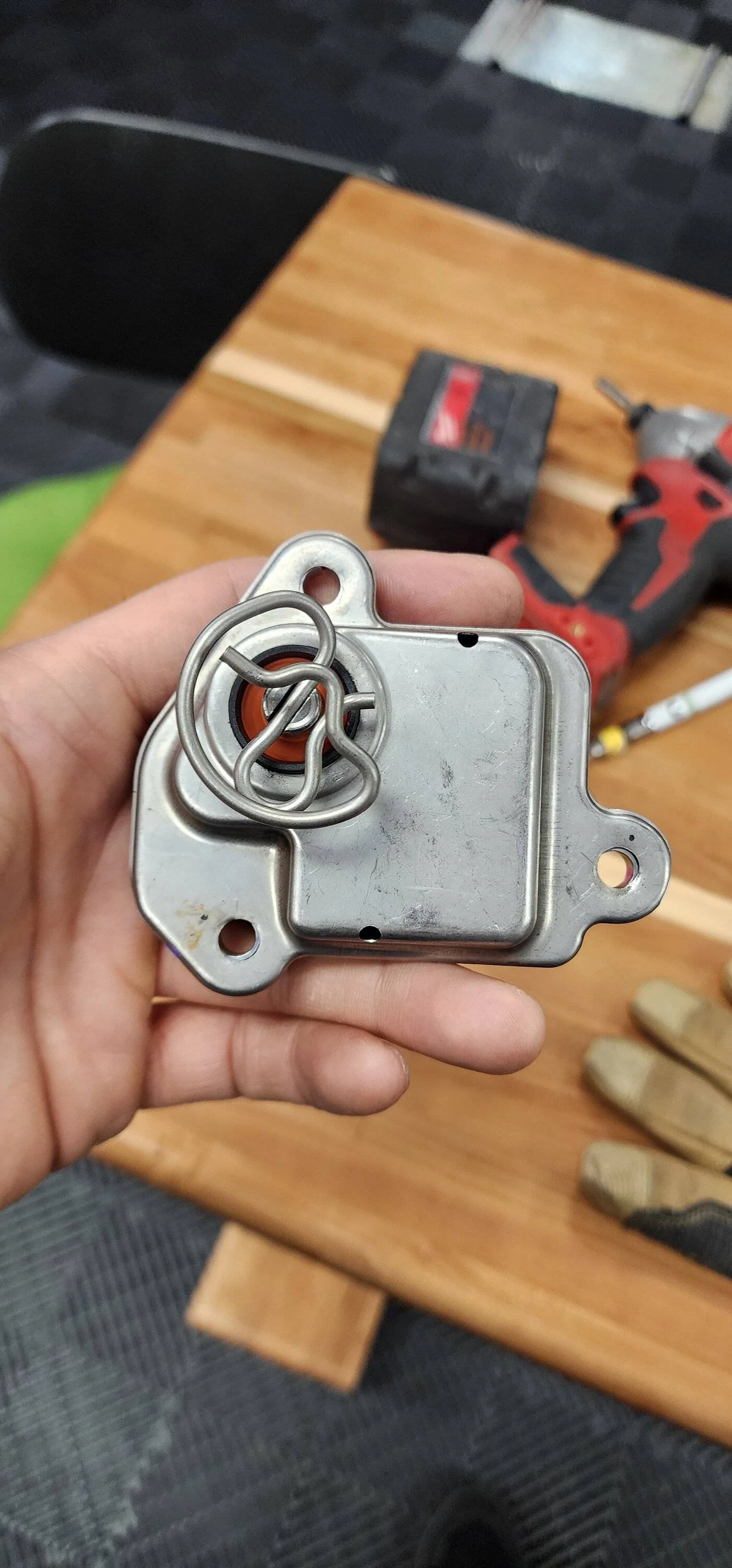

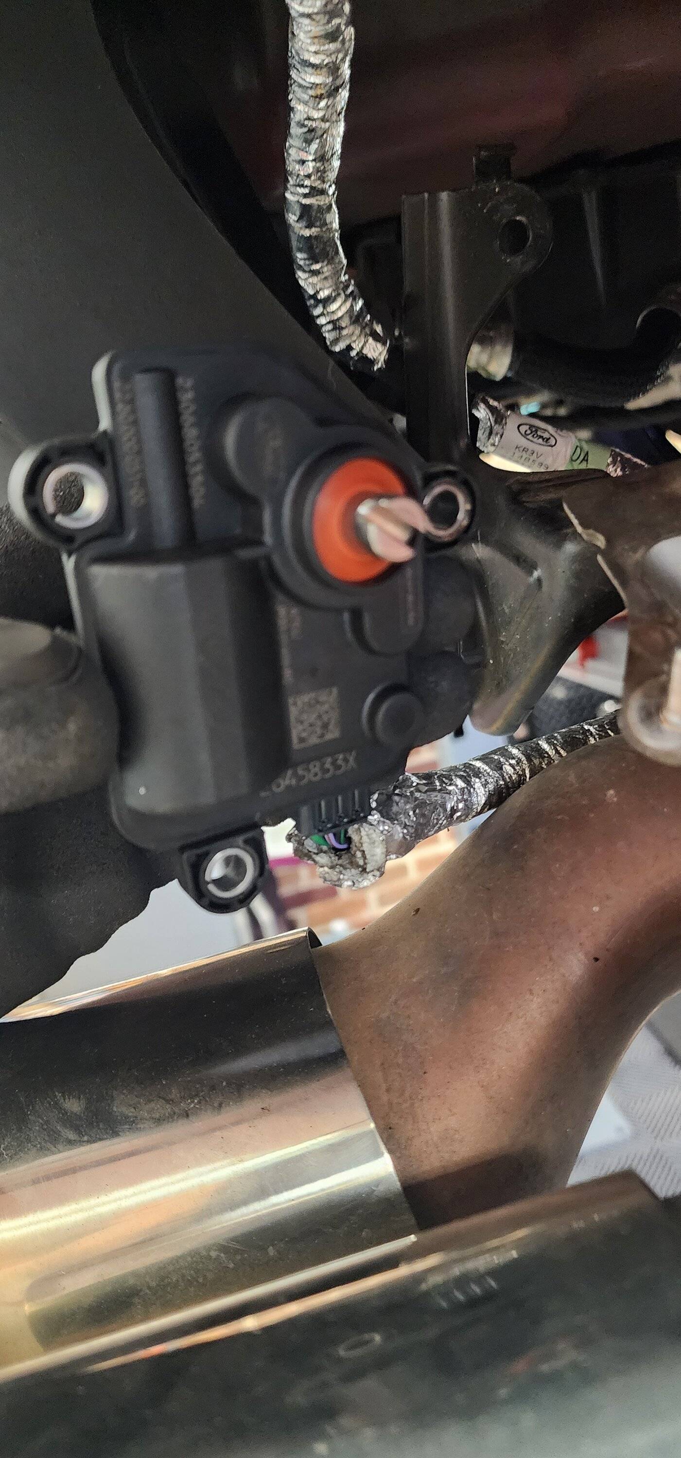

Don't worry about hurting the valve. It's a sealed unit. I've had a few noisy ones. If the valve is operating correctly, check the area for rocks, or loose hardware. There are 3 nuts that hold the actuator in place on top of the exhaust tips. You may have to lower the rear part of the exhaust to get to it. Maybe they're loose.
There's also a small chance this spring either broke or came loose, but that would probably send a code saying "Active Exhaust Not Available."
AE is a great invention, but lots of little issues with it over the years. Wiring getting frayed, noise, bad actuators. It's a pretty simple system you just have to go through it.

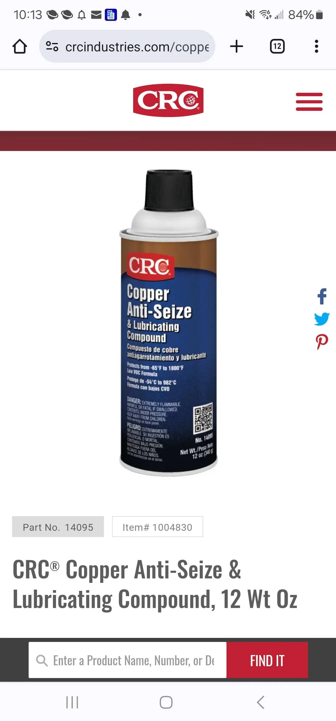

How about this stuff??
