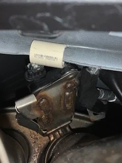

after a recent track day. My exhaust failed again. I took off the harness and both had been nearly sheered. Here are pictures and part numbers. I was able to fix my harness by pushing pins out and slipping over some heat shrink.
parts are $32 bucks each at TASCA auto parts. ford P/N JREZ-14A411-H
View media item 15906View media item 15905
Also added a pinch weld bumper to protect harness....its $2 and 5 minute fab and install.

What did you make the pinch weld bumper from? Is it holding up?
I bent over the pinch weld about 3” in width in the plug-in area. Zero issues since.

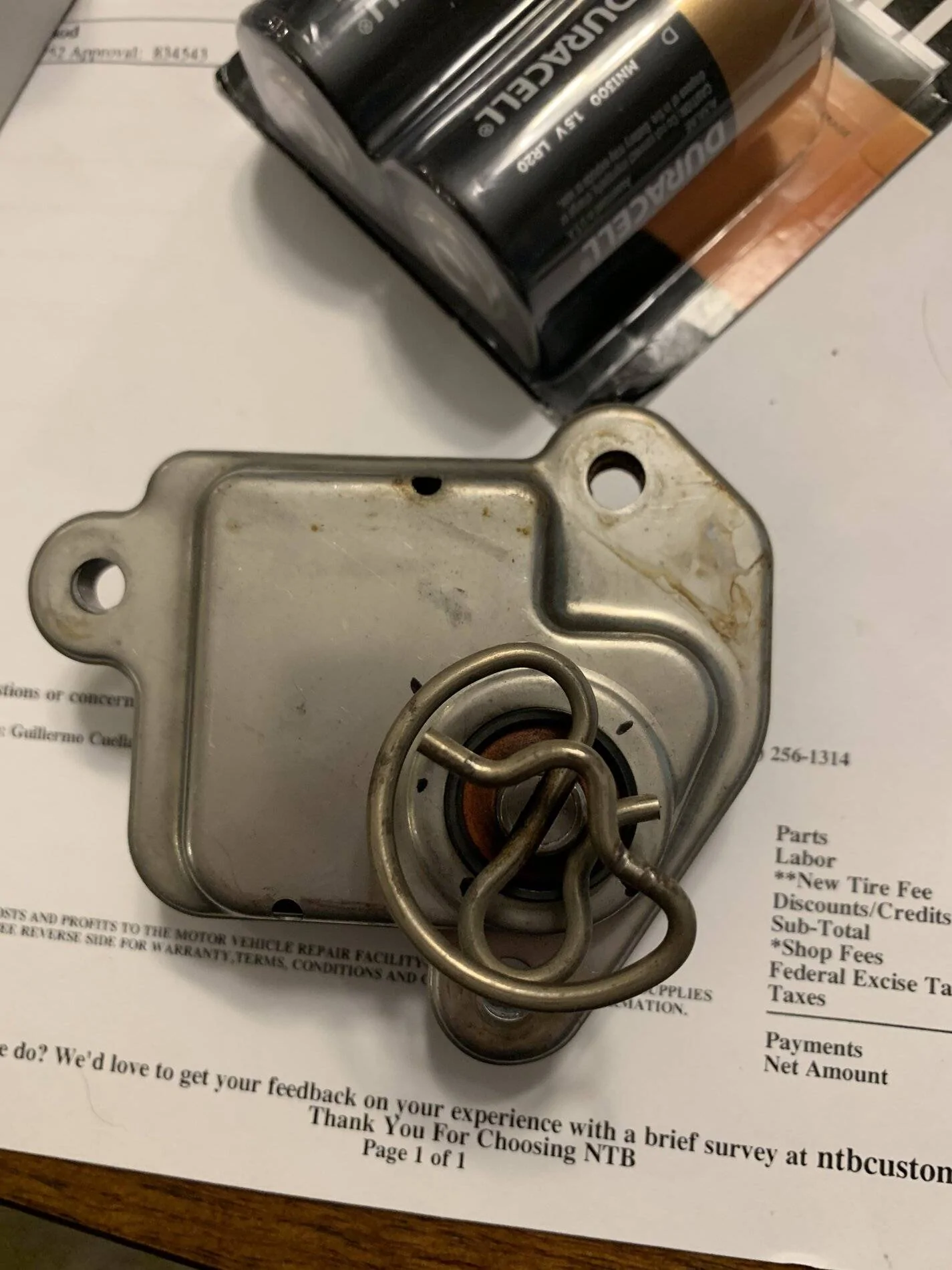

Also as an additional problem found and fixed. The passenger side began to rattle. Turns out it was the spring. I removed the factory spring. I then heated spring to mild red color in the center portion and expanded the spring 1/4” and let cool. Did this months ago and all good. No more rattling from baffle.

As far as the Spring mod goes I took the mini butane torch like to caramelize sugar on crème Brule and about midway of spring heated it til medium red not glowing bright. the spring I put into vise so I could hold heat and pull to enlarge the height of spring. Make sure to pull straight up from center as not doing so could have alignment issues on the motor and baffle knotch. Make sure the baffle is in the open position and that the fuse #34 is pulled in engine bay. Before you start any disassembly.
