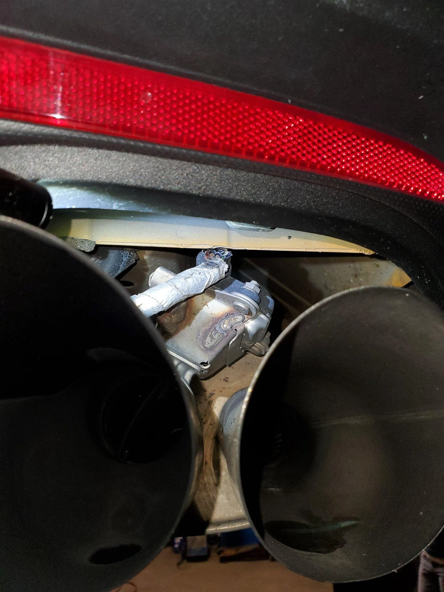

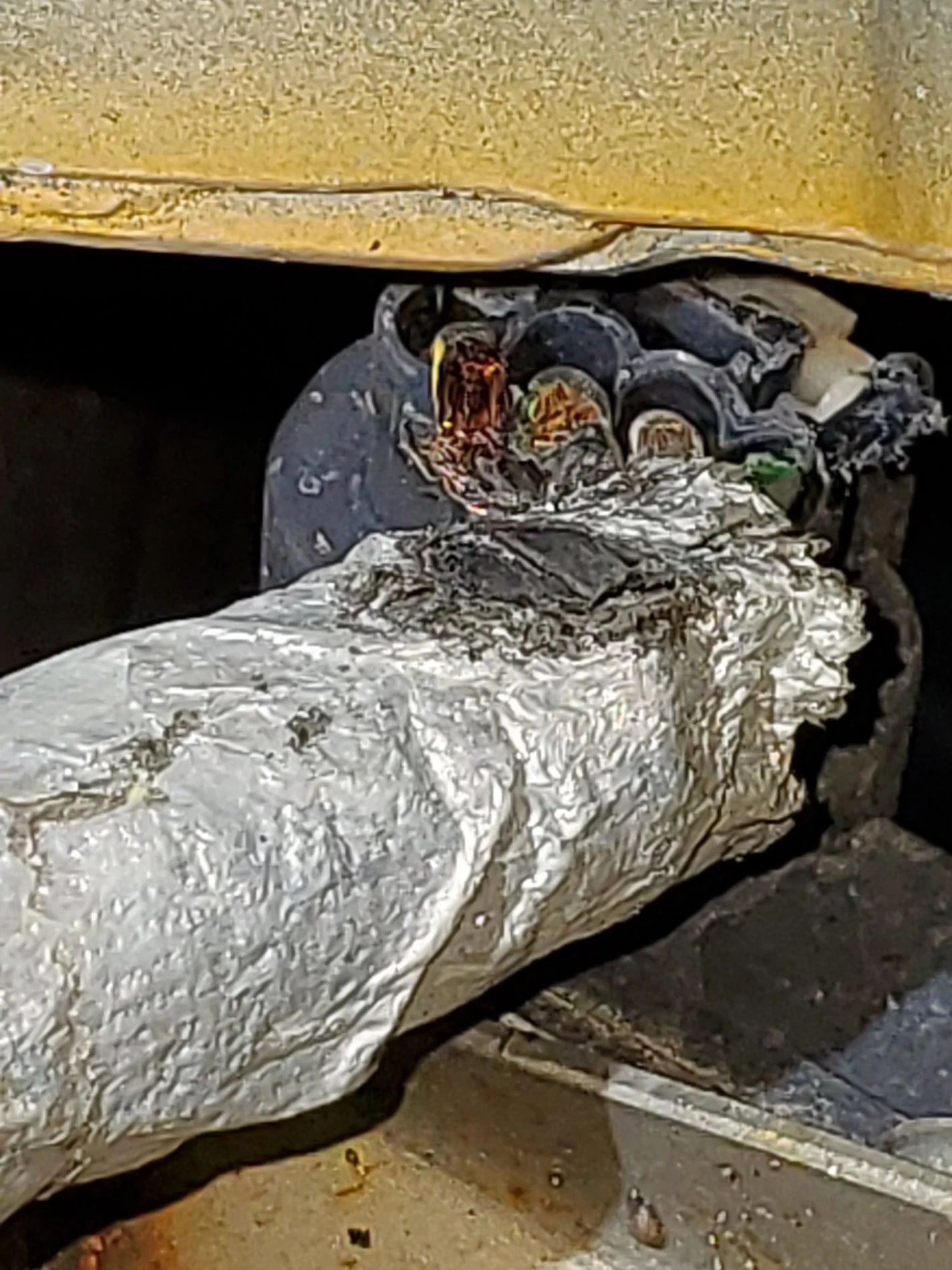

Update... I found the problem.. the passenger side actuator plug wires got hot and melted the insulation
Ooooo yea.... THAT will do it!
I don’t know why Ford made those harnesses so short there or never attempted to tie them up further away from the mufflers...
That’s what most of the AE functionality issues are related to also... deteriorated wires, connectors or both.
