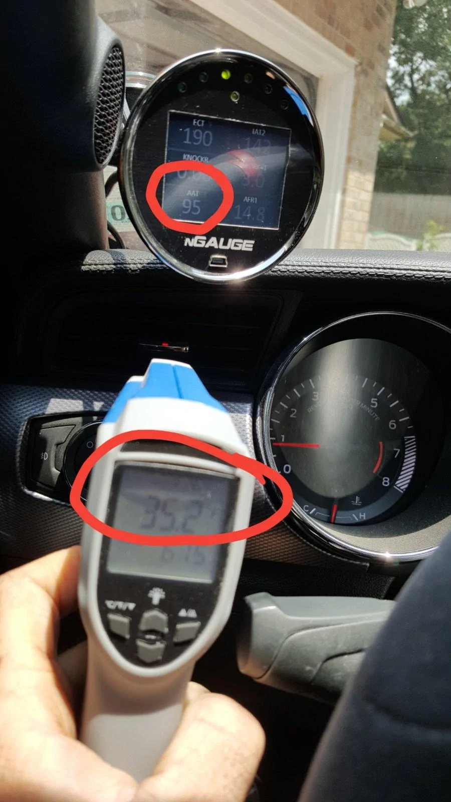

Well not good news to report. It seems about 5 minutes after using my system it went back to blowing 80 out the vents.
The downside was after putting sealant in and charging the system I let it sit for maybe 3-4 minutes before shutting it down for 4 hours.
I think the correct method may be to seal it, charge it, and drive it on max for an hour or more.
When I got home I put the rest of the 20oz can (1/4) in but watched the psi gauge sit at 45, then travel quickly down to 30 and hot air was blowing again.
So I assume I have a extremely large hole in my evap system.
