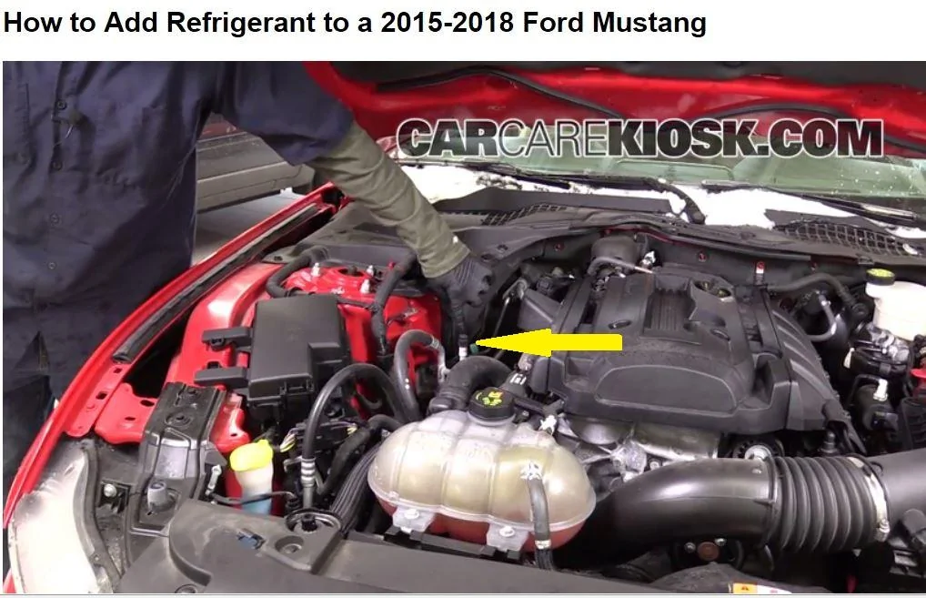

@GT Pony thanks. However check the video in the link below, I think they show the location of the low pressure port to be the same as the one shown with a yellow arrow in my photo :shrug:
Can someone confirm that?
https://www.carcarekiosk.com/video/...L_4_Cyl._Turbo/air_conditioner/recharge_freon
Yes, it's the same one you pointed to, which is back towards the firewall. It was hard to get my bearings from your close up photo. See below, from the video you linked to.
Also, I saw in another video that said the high pressure service port and low pressure service port are different sizes, so you can't mix them up by mistake.
