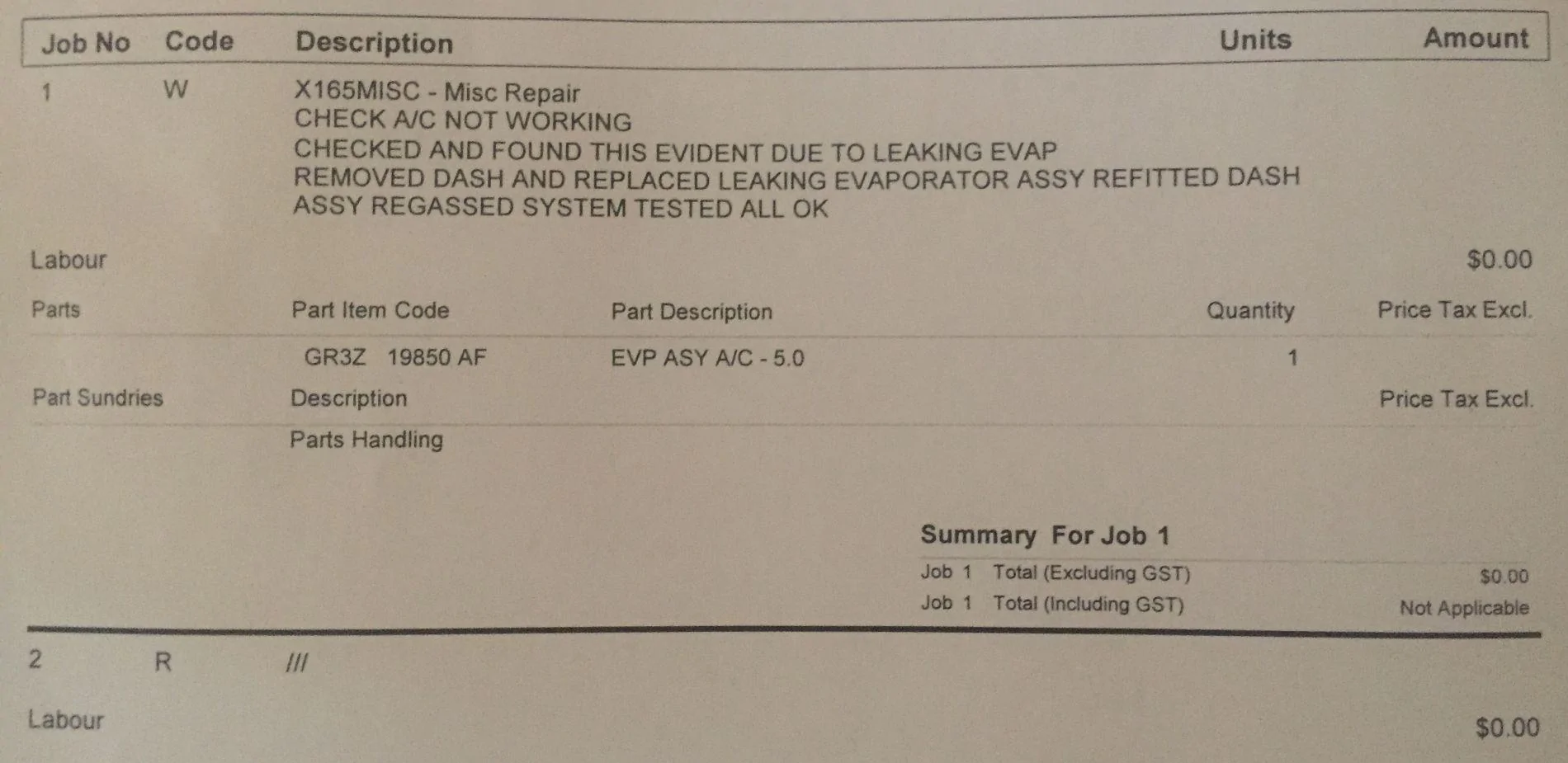

Just picked the car up after the evaporator replacement.
Gave it a good looking over - no damage whatsoever that I can see and all lighting etc. reconnected properly.
No new rattles detected on my short drive home.
Oh, and the air conditioning is now working perfectly.
:clap2:
Part number of the new evaporator assembly (RHD GT) is: GR3Z 19850 AF.
