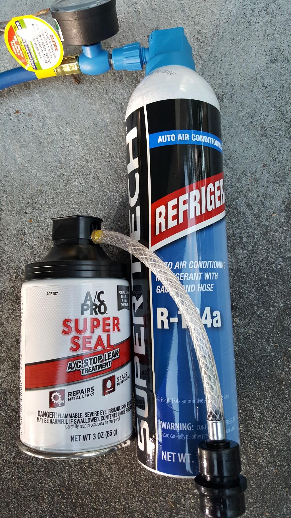

Joined the club sooner than I expected. 16k miles. Said fuck it and went to Walmart and found a sealer for metal and rubber and the cheapest can of r134 with a dummy gauge. Didn't feel like getting my gauges out. System holds 21oz so I figured 16oz would put it just about right because the system still had enough to blow cold at idle, but nothing higher. Now it's blowing cold and I hope the sealer lasts a while.
