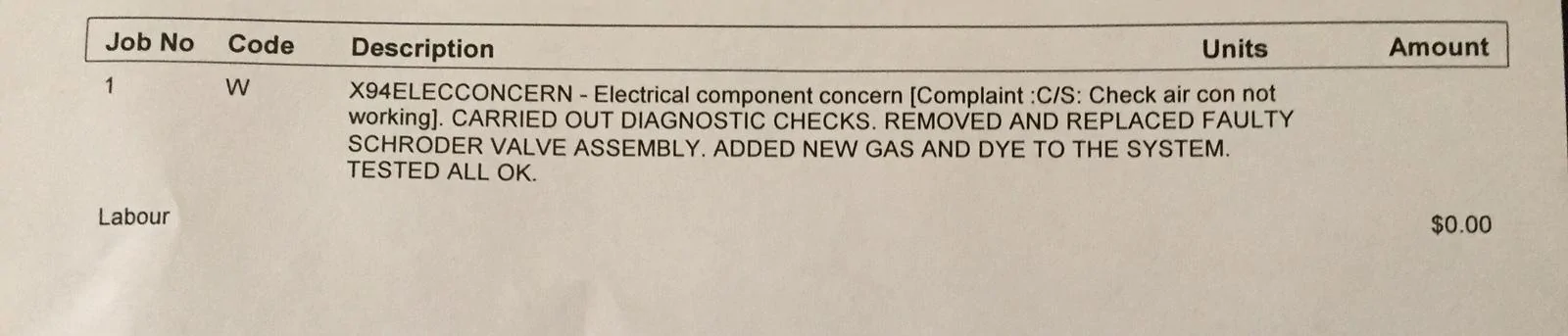

Add me the the list. My A/C stop blowing cold. Dealer replace the bad parts and some bolts in under 2 hours.
Under two hours? Sounds like what my issue was. Bad Schrader valve.

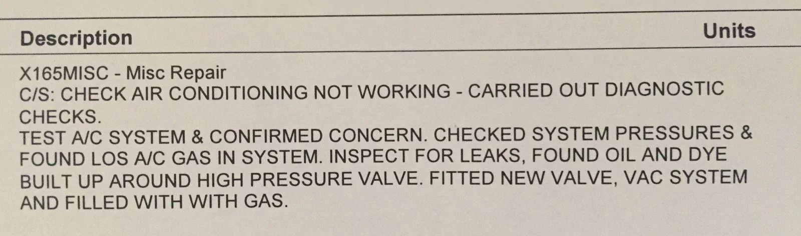

Bad Schrader valve.
That's what they claimed my issue was the first time I had it in.
It failed again a few months later - this time the dealer reckoned they found another valve issue.
Only a matter of time before it goes again - hopefully they'll bite the bullet then and replace the evaporator (ideally before my warranty expires in a years time).
