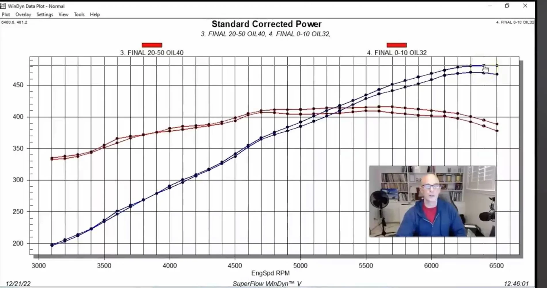

Remember the claims Royal Purple would make, where if you changed your engine oil, transmission fluid, and differential fluid to Royal Purple you'd gain 8-10hp? :lol:
This dyno graph is 20W50 vs 0W10
So you'd never see anything close to this with brands of the same viscosity or one level difference (like 5-30 vs 5-20)
Not to mention just changing the oil in your diff...

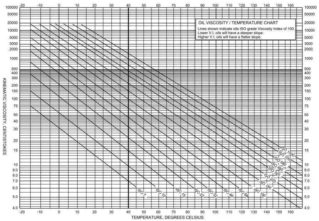

Without a diff cooler, your diff will run 260+ on track by the afternoon. At that temp, 140 weight behaves like 90w (or worse) anyway. You can use the attached nomograph to play What If. 12cs is a good baseline for viscosity.
Here is another chart to convert ISO to SAE viscosity:
