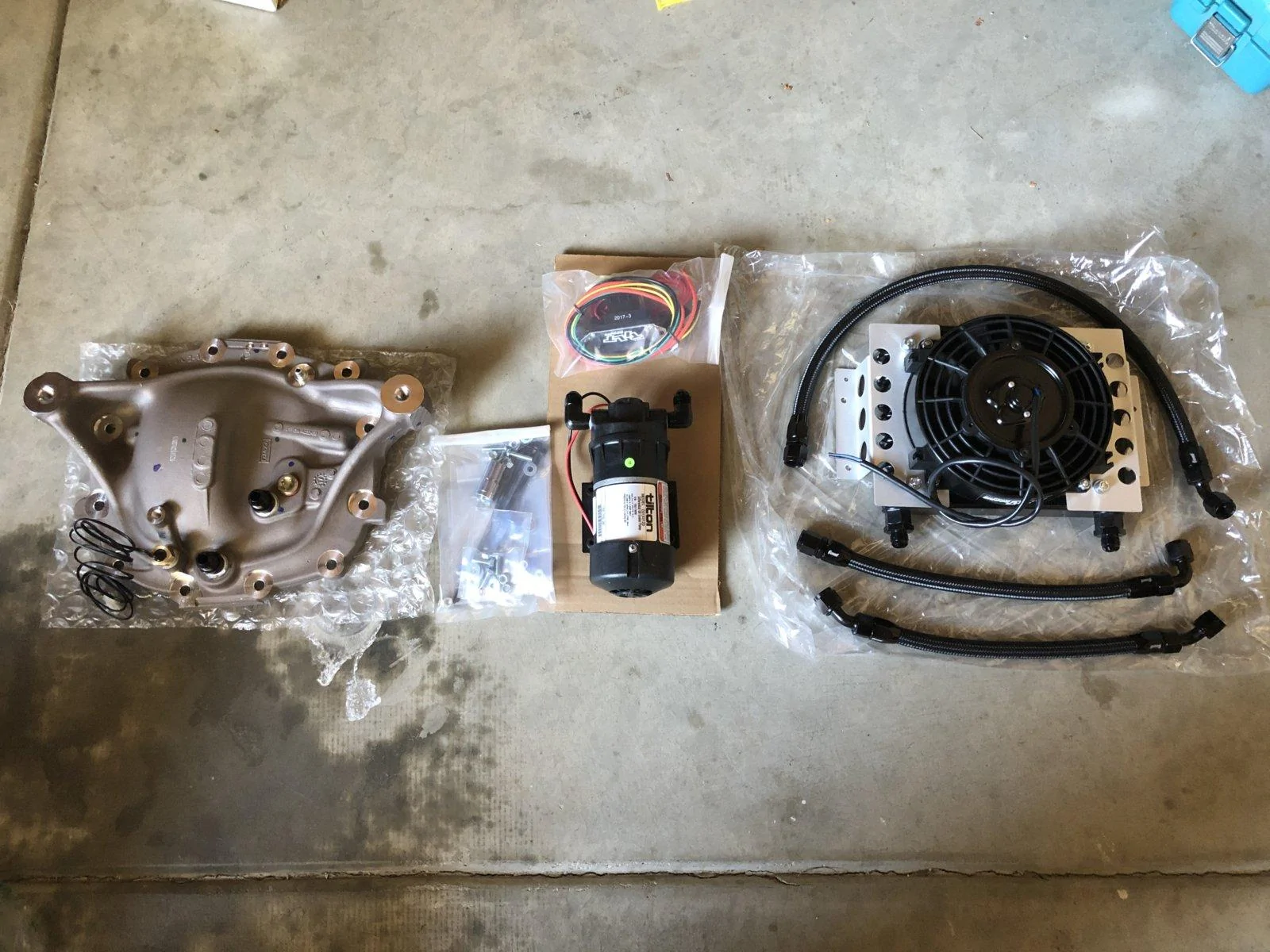

As the title states, I added this to my car recently as I and most of us have had issues with overheated diffs on track. I have not run it on road course yet but I’ve been just testing it’s ability to cool at somewhat lower temps plus dial in the setting to not kicking on till about 200-225 degrees so during normal daily driving it never kicks on. As I can tell for the month that it’s been on the car it works perfectly. When I tested it at lower settings in would turn on and run till it lowered the temp and then shut back off. Without further ado......
Kit contents.

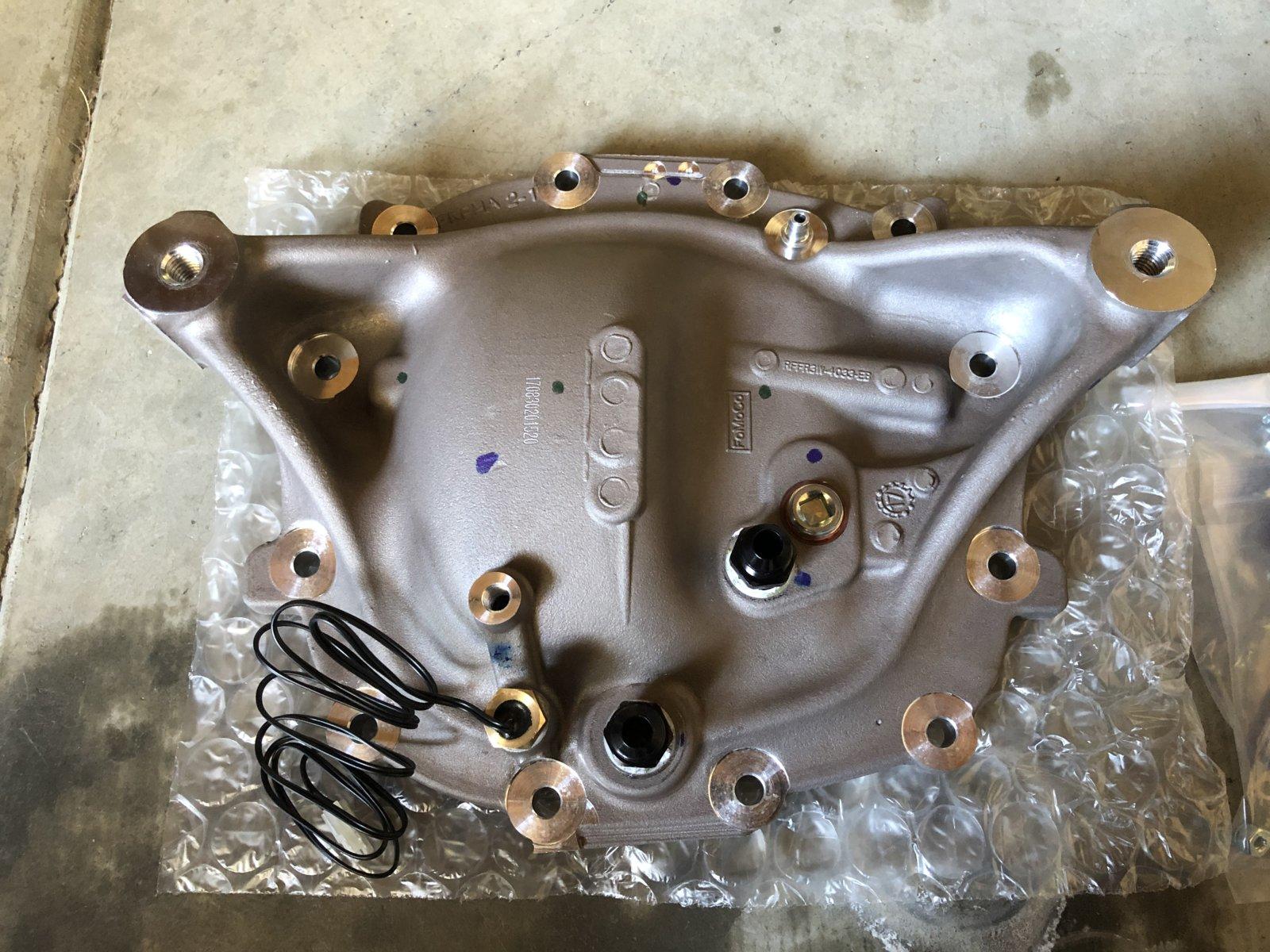

New oem cover with hose connection points return/send and the thermo sensor plus the connection point for factory diff temp sensor in 16’s and up which I still utilized.

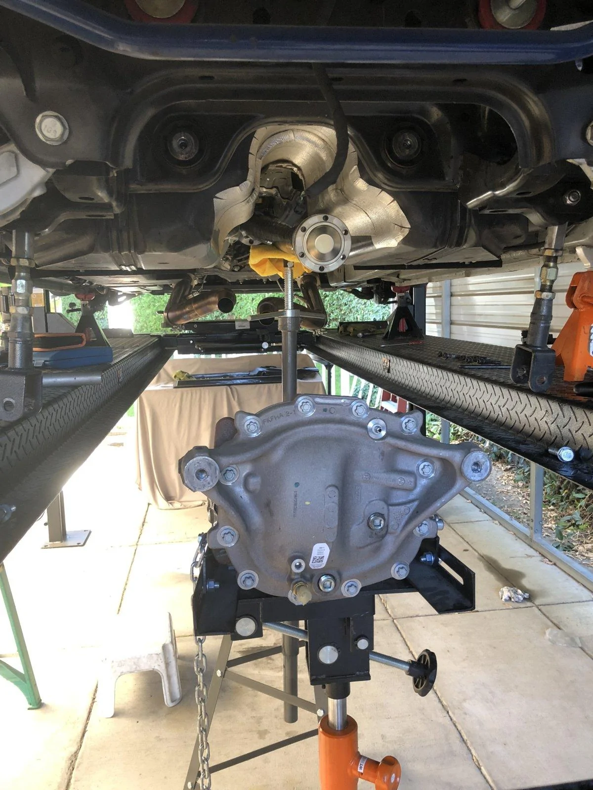

The diff has to be dropped to get access to all the cover bolts.

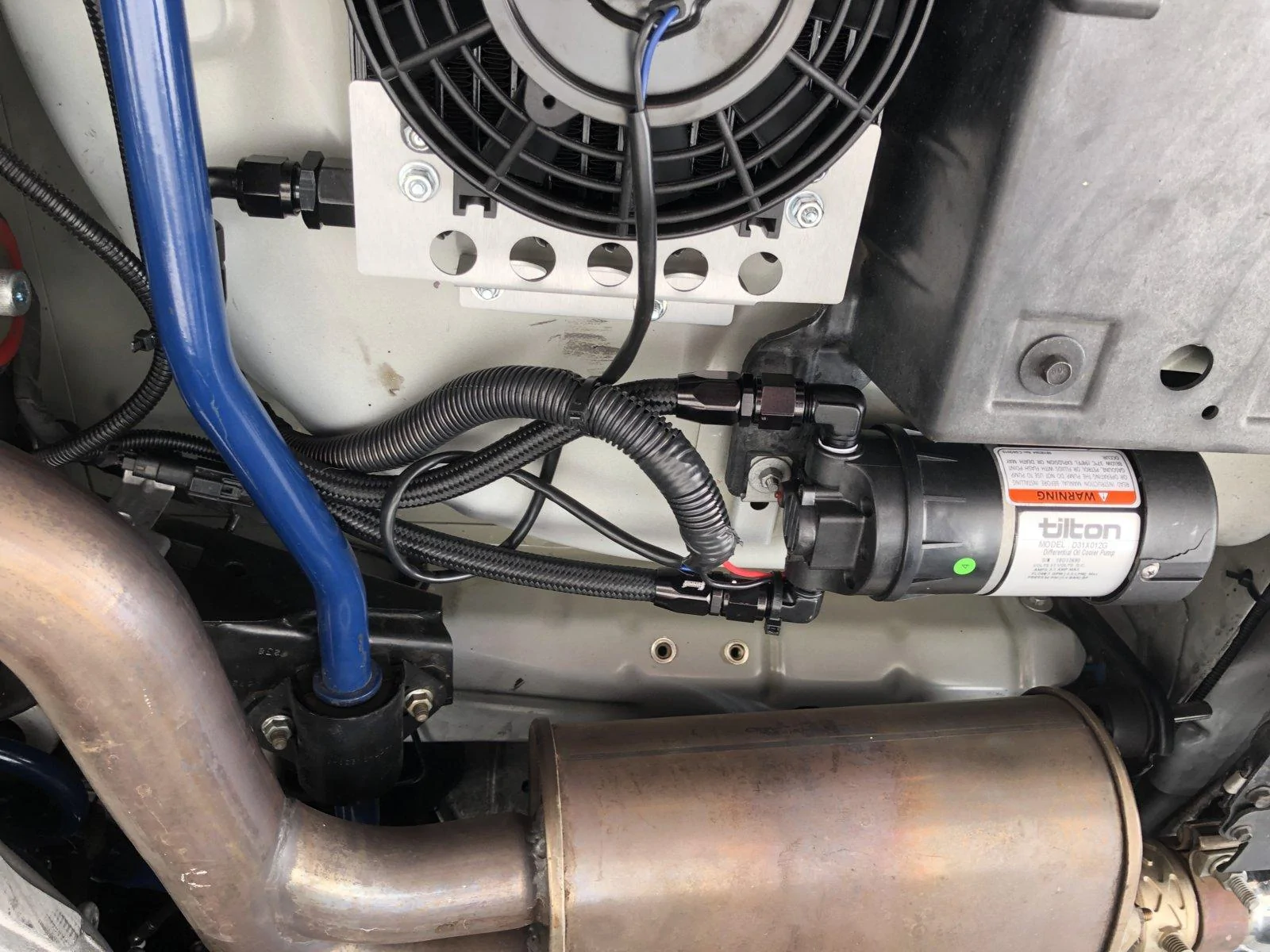

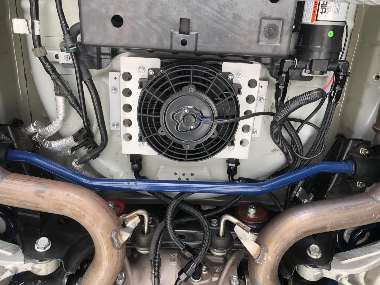

Installed.
The black relay on the right side of the spare tire well has an adjustable dial to set in the activation temp. As you can see I have the Watson battery relocation kit that I put in the spare tire well which makes running power and ground connections easier.

So the cooler is installed above the diff?
Seems like a bad spot to get cool airflow.

There is no way to install the cooler "below the diff" and there is no concern installing it where it is; let the pump do it's job.
The fan on the cooler has significant efficacy in the process of cooling the fluid passing through the cooler just the same as your radiator fans are capable of keeping your car cool with no airflow from movement.

It's not. wildcatgoal explains it in the post above.

Having a lift is obviously very helpful but you truly could do this job on jack stands and I wouldn’t hesitate to do it that way if I had to. Literally a floor jack could support and lower/raise the diff enough. To drop the diff you’d have to get to the point of removing the half shafts. I don’t consider that a difficult job either as I've done it plenty of times. If you go this route, don’t hesitate to ask anything.
