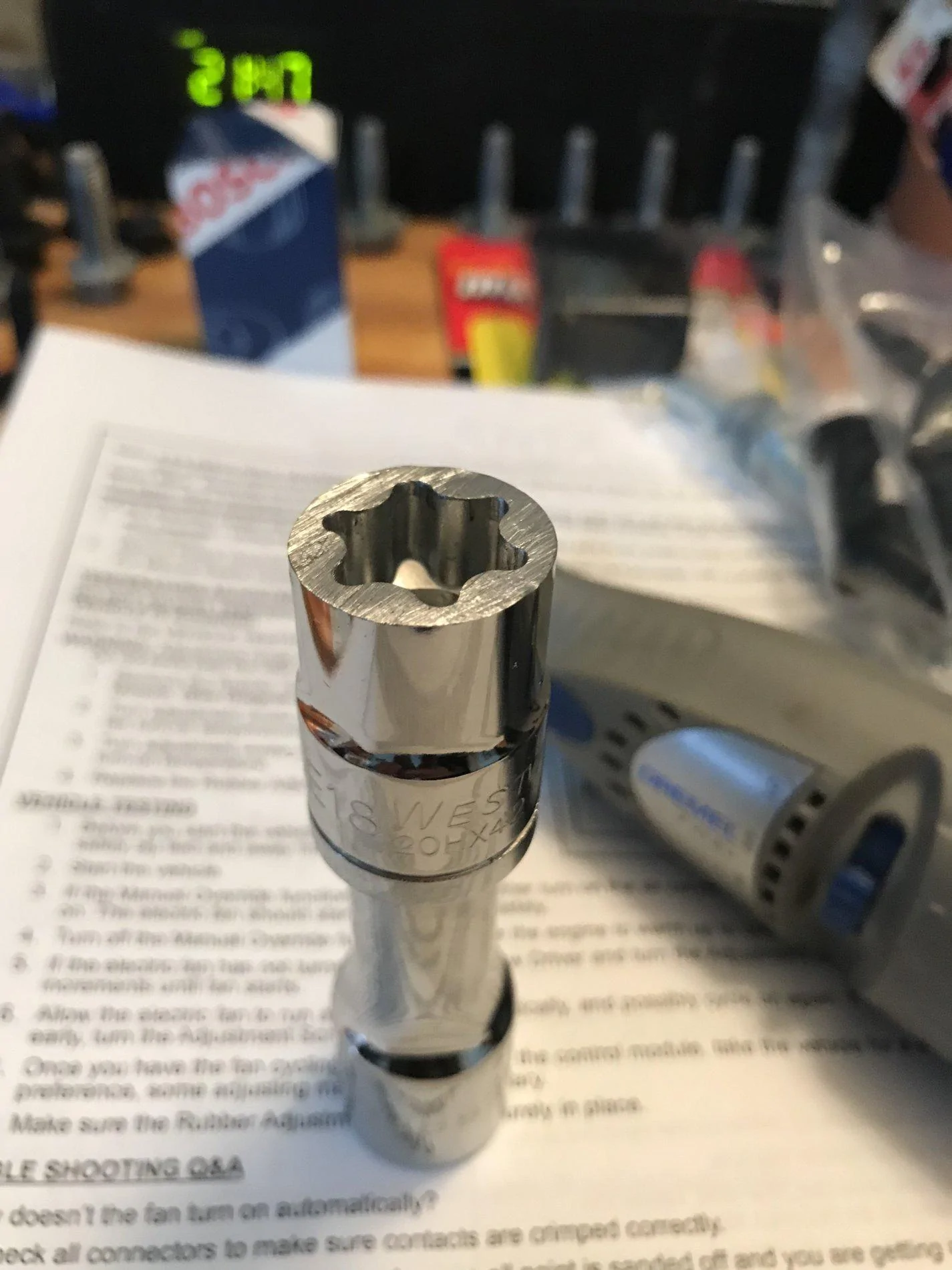

went to 2 different parts stores in search of a socket...no dice...ended up cutting the tapered part, of the socket from the kit, completely off and cleaned up the edges with a dremel...worked like a champ

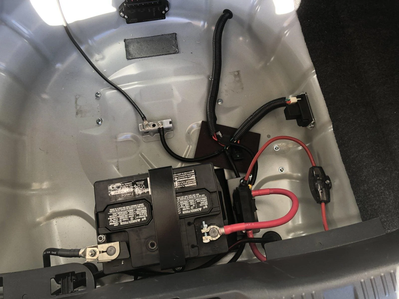

The black relay on the right side of the spare tire well has an adjustable dial to set in the activation temp. As you can see I have the Watson battery relocation kit that I put in the spare tire well which makes running power and ground connections easier.
I want to put my battery in the same place. Did you order the RH or LH Watson Kit?
Ordered the left hand kit just to make sure there was enough power cable. Just trimmed it to fit once the final layout was figured out. You’ll also want to buy two shorter bolts that mount the tray to the floor because of the evap under the car.

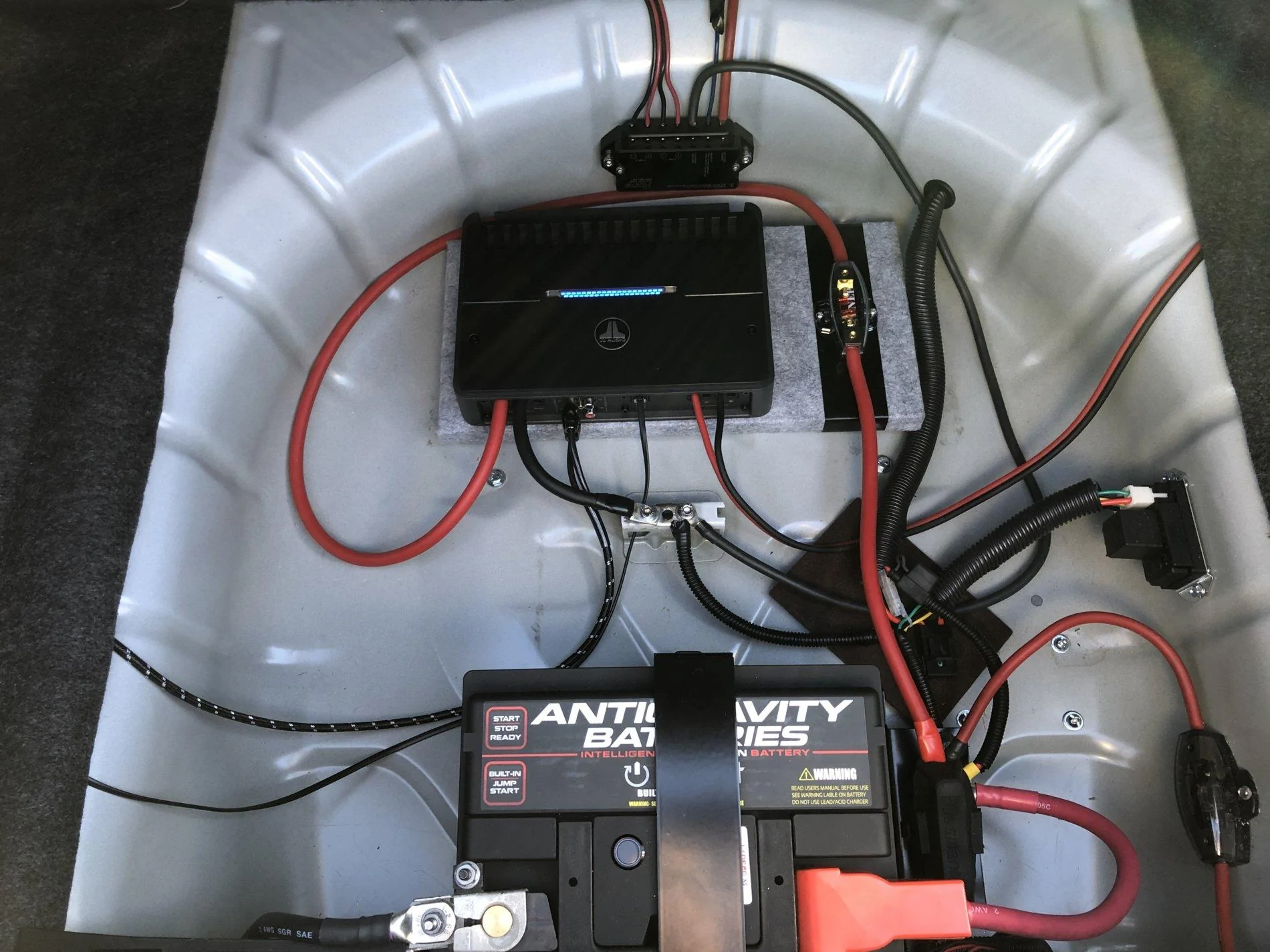

Current look after adding subwoofer amp and antigravity lithium battery. Lots of traffic in there.
