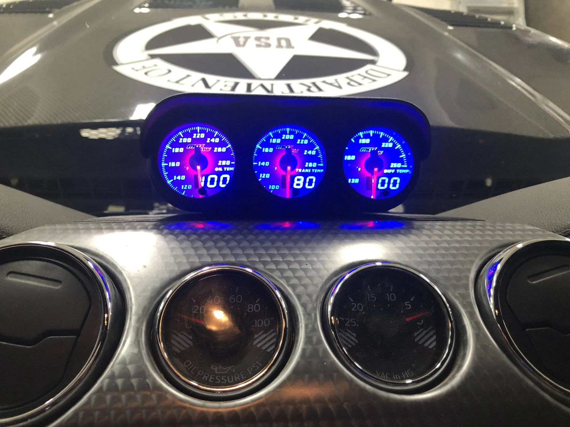

you will fry 3rd or 4th gear without a cooler eventually, if car is driven hard 20 minutes at a time on fast courses.
fwiw, i never see temps above 220 with a trans cooler, with sensor on the suck port so fluid is being sampled hot. others have seen >300 sampled at the same spot without a cooler.
same with the diff, expect temps >300 without one under the same circumstances. i never see more than 220 with my FTBR setup (sensor also on suck port). you can run without cooling, but be prepared for frequent fluid changes due to oil shear. or lost track time on the 16+ due to limp mode.
.. and to answer OPs question: on my setup, tranny cooler is wired to a switch i turn on/off as needed, while diff is triggered by a sensor (trigger temp set manually) - i also have temp sensors on both suck ports wired into a gauge pod mounted on the dash. i will probably eliminate the diff trigger and wire in another switch soon (to eliminate a potential point of failure).
