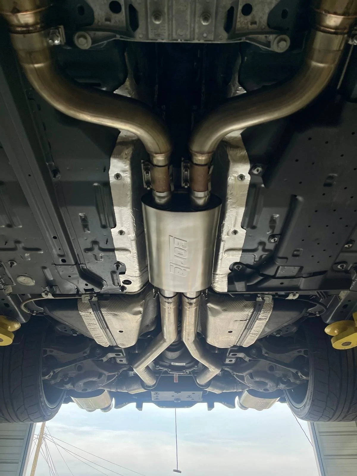

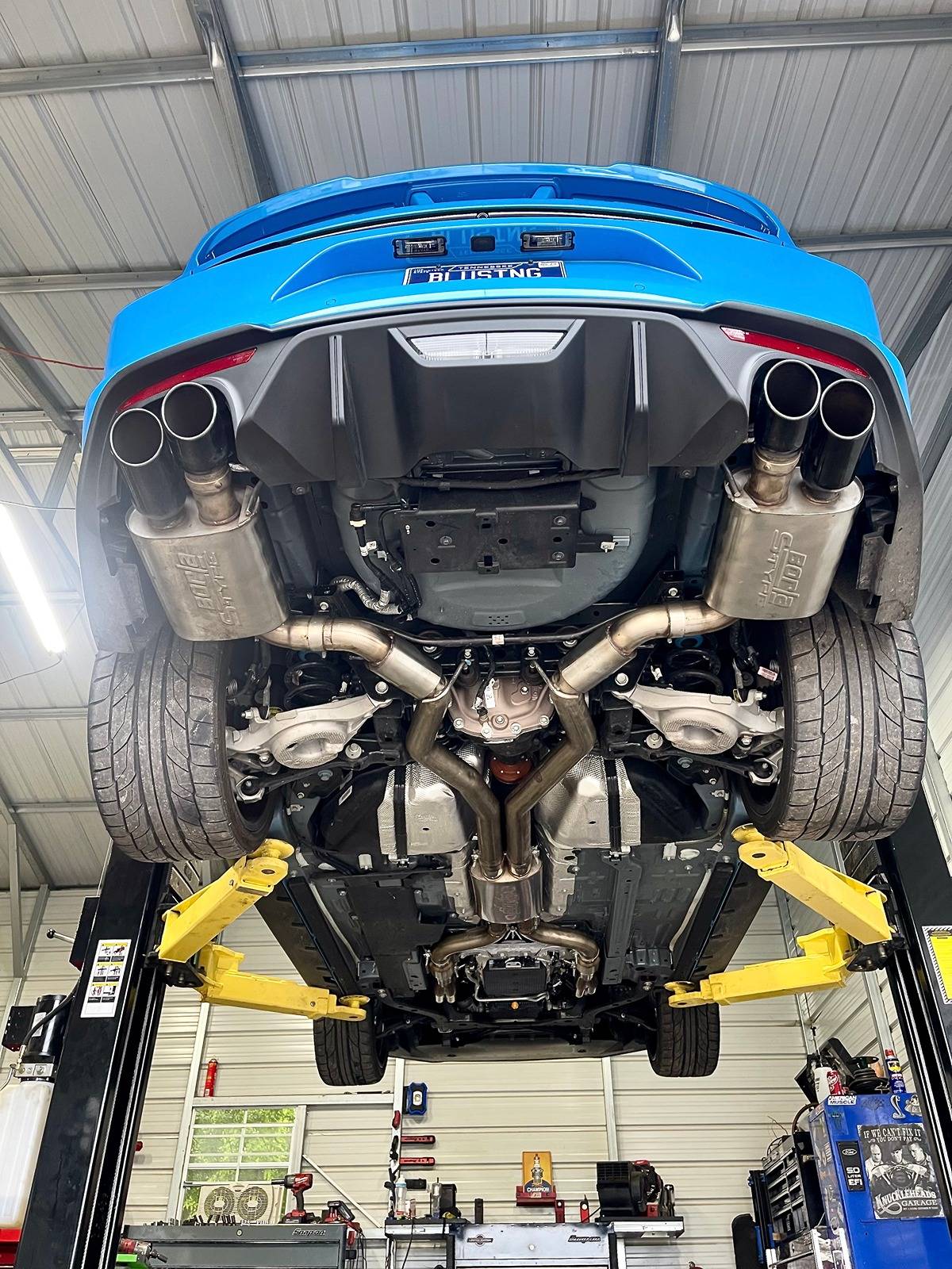

I’d add active exhaust plus a mid pipe with resonators. You can build your own like I did or buy one premade with resonators. Active exhaust is my favorite part of my car. Can be dead quiet or super loud with the flip of a switch.
Here’s me in track mode (valves fully open) + ford racing x pipe + 12” vibrant resonators:

I did the Borla "Touring" resonator to replace the X pipe on my Active S type cat back. Made a huge difference. It is dramatically quieter now. So I would say the Borla Touring cat back would be a solid choice. I love my setup now, it is a little quiet but has that "Borla" tone back that I love...
