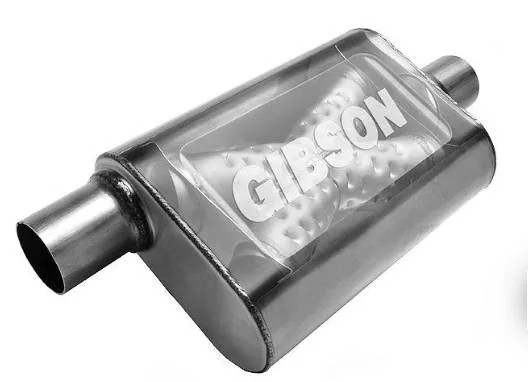

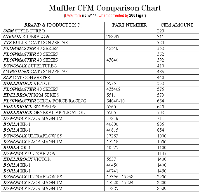

Just curious how Gibsons dont flow enough for SC applications? baffled muffler vs straight through design? My only concern is that straight thru exhausts are much louder then chambered designs.
Trent W
Trent W
Jan 20, 2015
180
59
Utah
2015 GT PP
