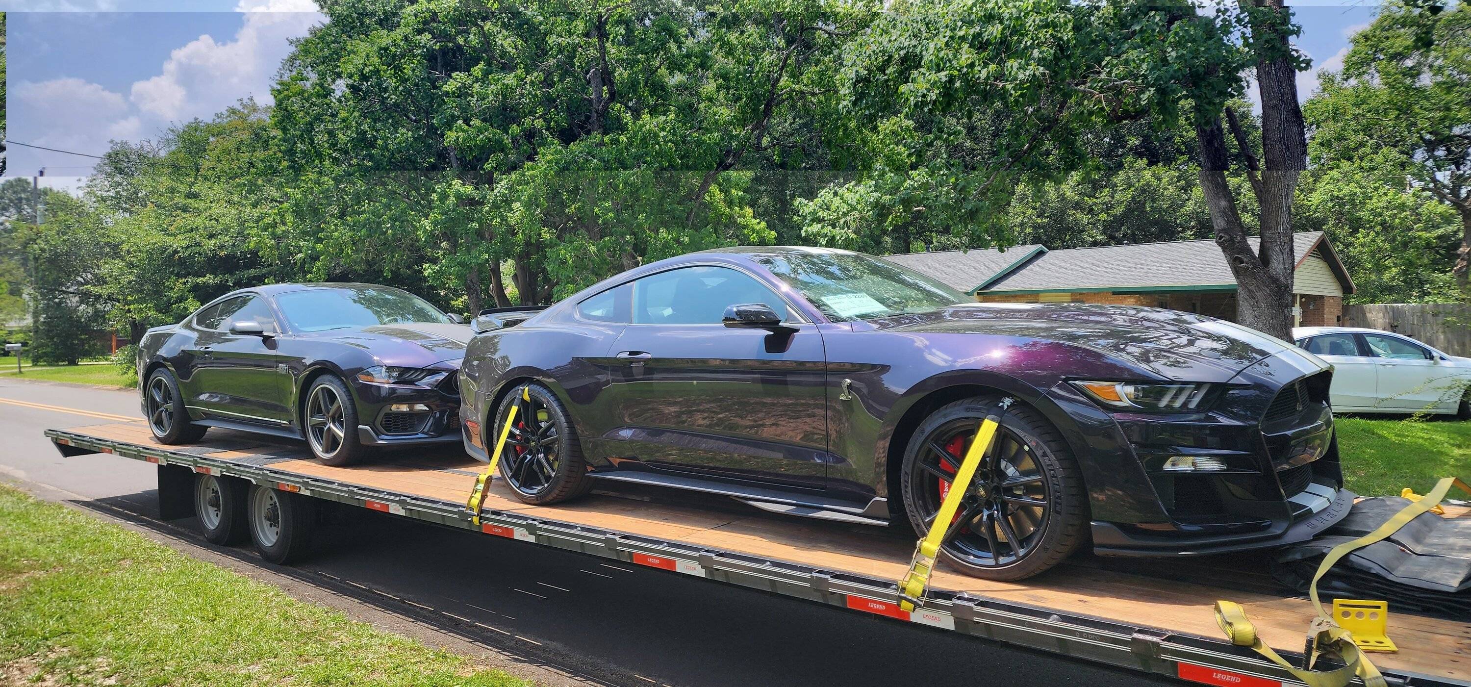

Greetings! As the title reads, my 2023 Mach 1 was damaged in transit to me. When the carrier loaded the car onto the trailer, the incline was steep and the rear valance and exhaust tips were gouged the F up. Not really visible from up top, but it's there and it is a costly mistake. I'm positive that they were hoping that I'd miss this in my inspection.
Long story short -I've had the car about a month now- the carrier has ghosted me and the dealership on resolving the matter. So, the dealership is stepping up (as they should since they hired the carrier) and taking care of the matter.
Since the exhaust tips aren't a part, the entire exhaust from the resonator back has to be replaced. Ouch$!!! This is why the carrier has ghosted us.
So, I've been presented with 2 options by the dealership. 1) Replace with OE exhaust, but due to the odd & large size they supposedly have a high rate of being damaged in transit, which puts me back to square 1 for who knows how long since the part is already on back order. Or, 2) pick a cat-back system with active exhaust that has a higher chance of arriving undamaged due to smaller sections/boxes. However, in my limited research on AM active exhaust for the Mach 1, I've seen a couple of posts where the active exhaust has failed prematurely. I admit that I didn't research what the warranty was on those particular aftermarket brands, but if I were to go with OE, I should have the factory warranty + the extended warranty to cover this problem should/when it happen(s).

Can't help much with the exhaust, but does he/they have the straps wrapped around the wheels/tires? If you have damage, I guarantee the GT500 does too! This carrier has probably left the country so he isn't harassed.
If I saw my car show up like that, first place I am taking it is the dealership for a full inspection. Wow.
That wheel/tire strap doesn’t look right as itā€˜s putting all the load on the top of the wheel. That’s a moving miscue big time. That trailer isn’t set up to move cars & most likely transported both cars in gear with the parking brake engaged.

That is not a good trailer to haul vehicles with.

@WItoTX Other than visible damage, what other damage could potentially happen from being transported like it was? This is my first car to have delivered, I've driven them home myself in the past, so I don't have much experience on the correct way it should have arrived. I did think it odd that there weren't any wheel chocks on either vehicle. So, yeah, car in gear and handbrake on.
