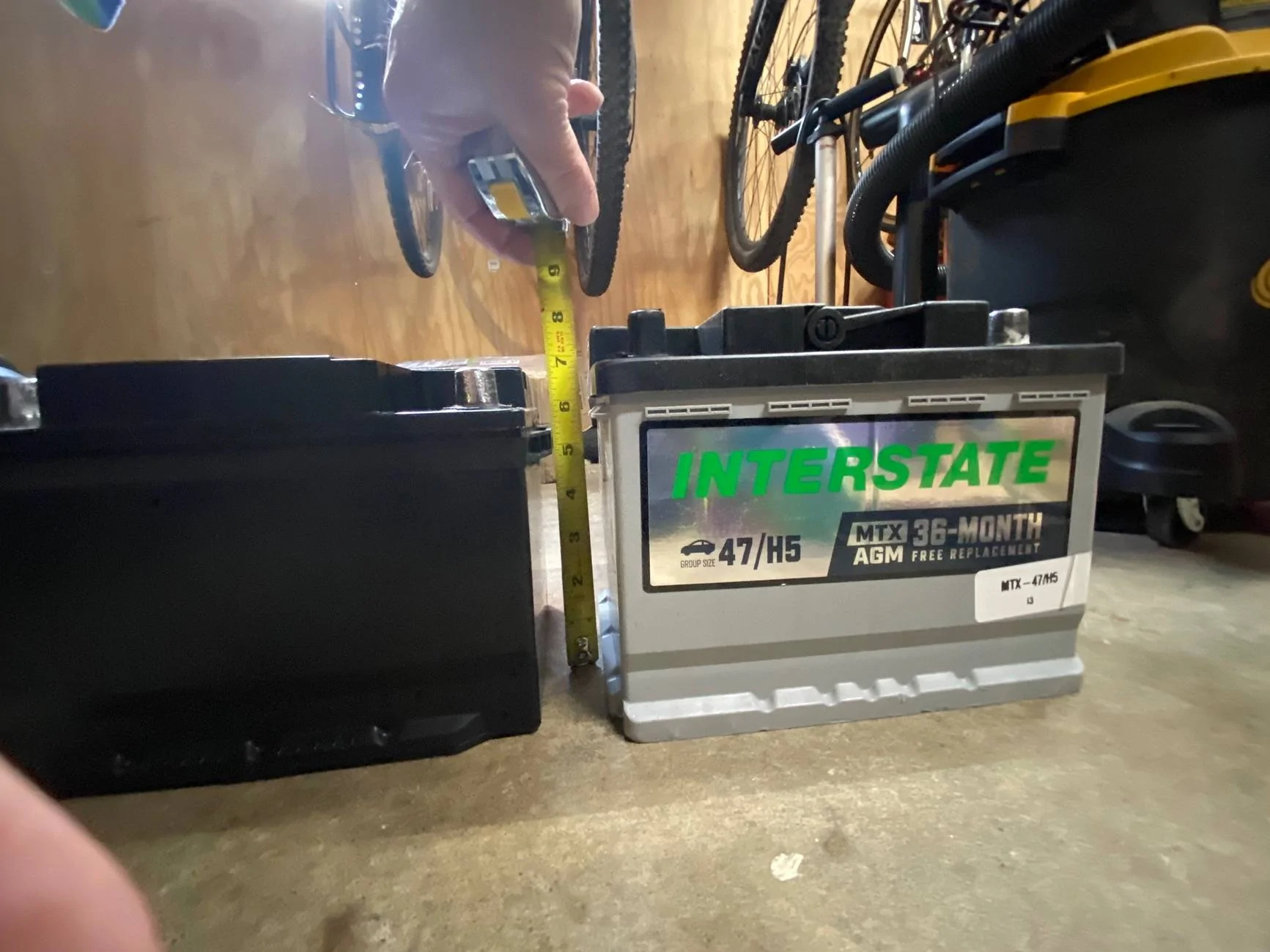

Good Evening. I picked up an Interstate 47/H5 from Amazon. I knew it was taller than the 96R, but was taken by the difference. It's an inch taller. :inspect:
I got it in and the battery cover is bowed up. I could get the little cover fasteners secured - no issues there. I did note the hood is impeded slightly by the taller height of the battery and cover. It closes, but requires an extra light push to close. So, the tallness has me bit concerned. But there is play on the battery cover and the foam cushioned hood liner that I think its not a big deal.
Lastly, I did the batter BMS reset per my owner's manual and it worked as described. :thumbsup:

My Costco Interstate battery doesn't have the MTX marking I see on your Interstate battery. It is a tight fit, but my battery cover is not bowed.
No height issues aye?

The 47 is just a tad bit taller cover still fits on though
