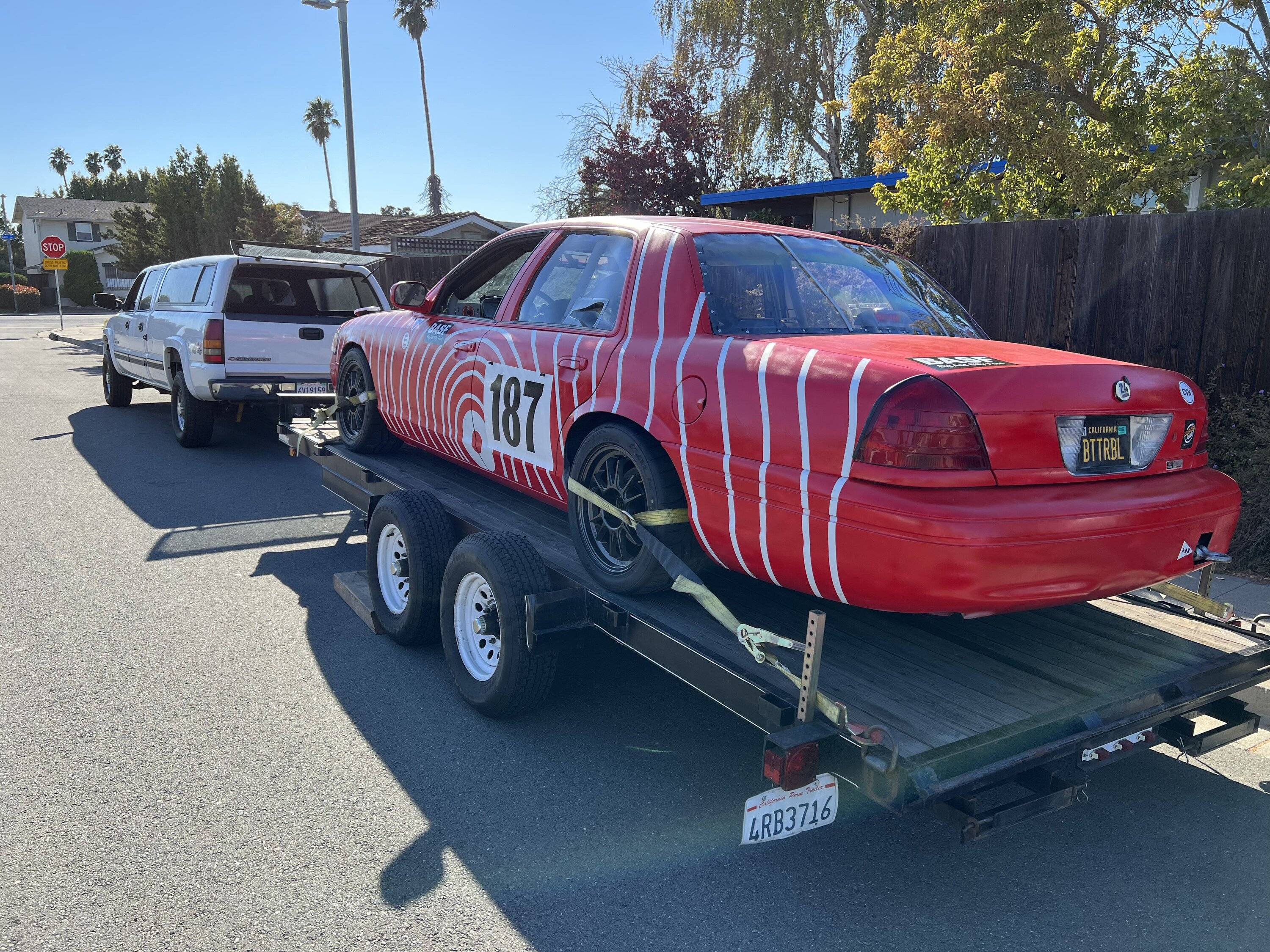

I’m no tow expert by any means, but we’ve towed our race car over 5k miles at this point with 0 issues. (Other than having a hell of a time getting it on and off the trailer because it’s so low.)
I don’t like tire straps wrapping the wheel like in the photo because it puts stress on a single point on the wheel. Plus the downward angle of the straps means then the trailer starts and stops the car cars weight is sort of being held by the transmission in park. It allows a little forward and back weight transfer, which could in theory put some stress on the transmission and suspension components.
As shown in the photo, I’d actually prefer the car had the parking brake on, to help limit movement.
was told the safest way is to have the straps work against one another, looped at the mid point of the tire to distribute the load evenly.
Like I said, I’m not an expert, but we’ve never damaged our car towing it.
With all that said, if there was an issue, I think you would have noticed or found it by now, so I wouldn’t stress over it.
