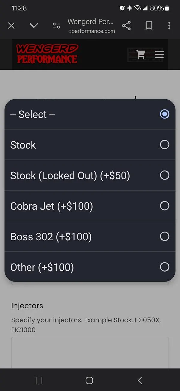

Is this the tune?
2021+ Mach 1 N/A Tuning???
With Stock option
Thats what I did.
Just specify everything stock. And order a tune device and credits..

Tune device ??
You have to have a device to interface with the car. I went with the RTD.. Just get one that Wengerd supports. He supports a few, I dont know if SCT is one of them.
Got it.. I think RTD is the most common it seems on the forum with Wengerd
