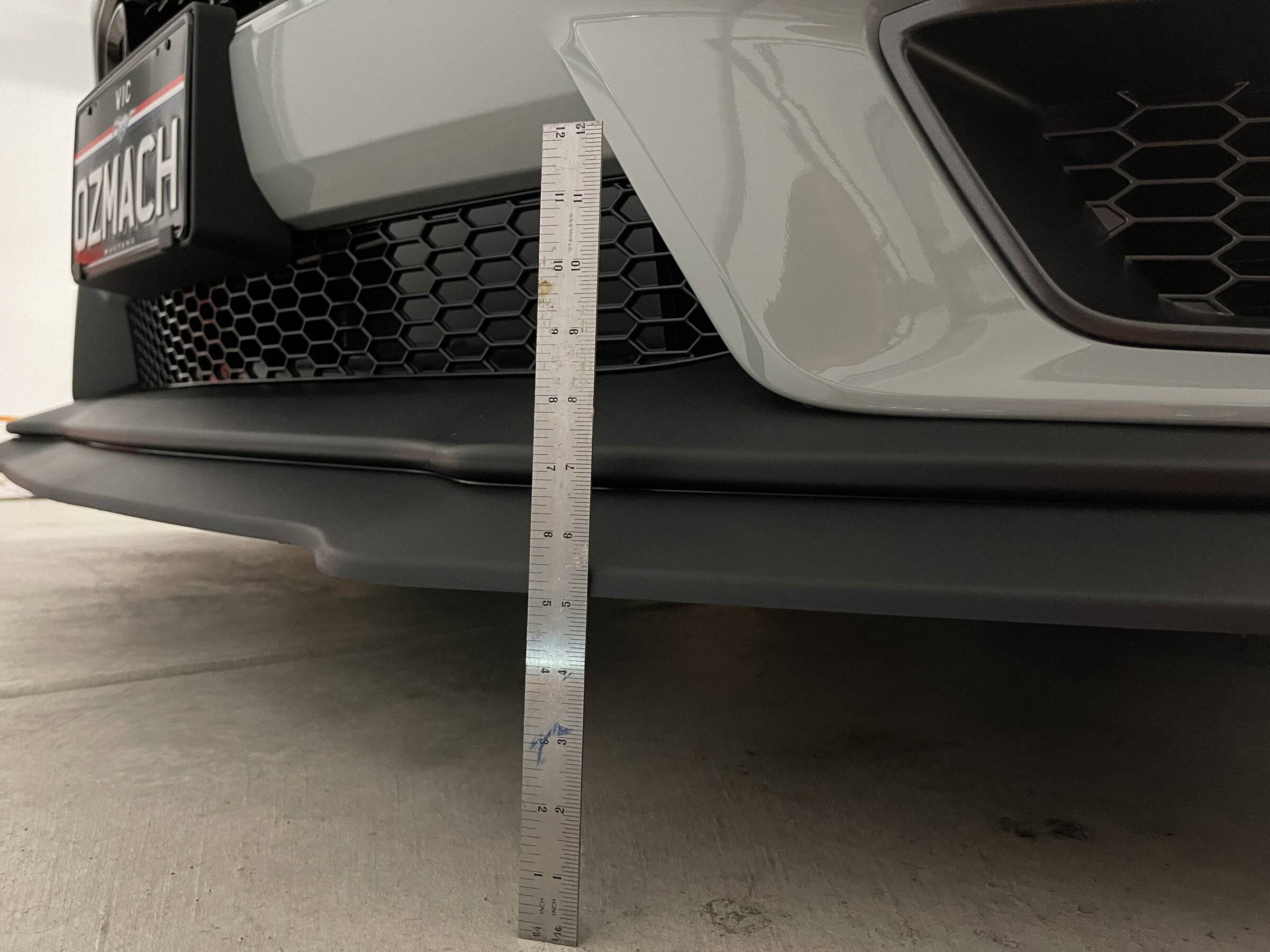

It’s one of those great measuring sticks that don’t show 4.9 inches. That’s the “Dark Side”. Maybe lookat the picture again and check the rear of your cell phone 😜

The front splitter and rear spoiler really enhance the aesthetics with a much meaner stance, and of course better grip on the track if ever going that way. As a guide, pre suspension modifications will result in 13cm clearance with the front splitter on, measuring the ground to splitter edge. The underbelly pan of course is lower than that. A bit of caution on the roads, choosing the right crossovers and streets with little or no speed humps. Thankfully I can get in & out of my driveway no problems 👍👍.
Driveway clearance is an issue for me, but still keen to see how the car sits and drives with the HP springs, rear bar and a decent wheel alignment.
Ill fit the HP suspension, I'm a mechanic by trade, been off the tools for years but still like to do as much of my own work as I can. A friend has a workshop I can access, so ill use his hoist and spring compressors etc to get it done.
Good to know how much clearance you have with the front splitter, ill fit that last, not looking forward to the inevitable ground scaping that will happen when its on. Thinking a front camera might help but still on the fence about that.

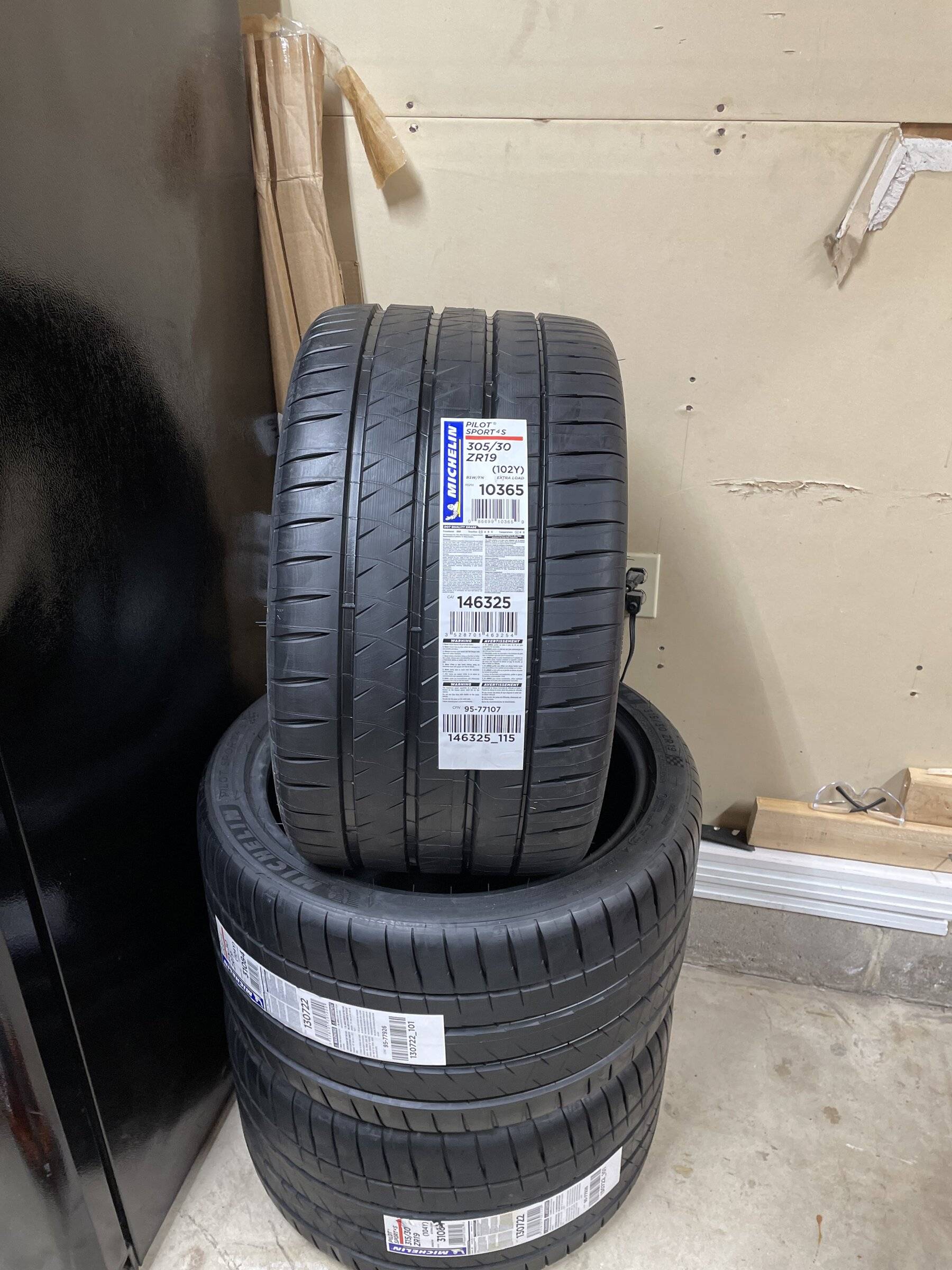

Tyres came in, couldn't wait 😁
Pilot Sport 4S 285/35 R19 and Pilot Super Sport 305/35 R19, both with nice fresh DOT.
Where did you get the Michelin pilot super sports?
I need your exact size (305/35 R19).
Discount tire told me they are discontinued and most places online say they are on backorder.

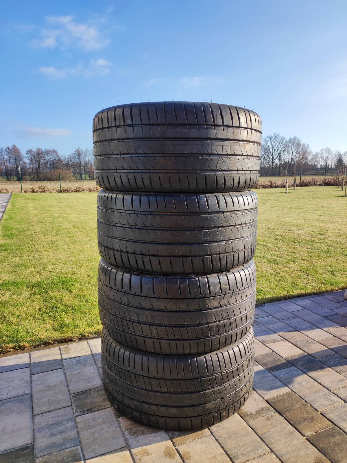

There were two pieces available here in Europe. I see 4 in stock here now at national/European supplier and Michelin probably has some more in its EU storage.
No idea how the situation is in your market. They have no PS4S replacement yet and they are official size for Shelby, Camaro and Corvette iirc so hopefully they make a batch here and now. Best to order and wait.
Btw both PSS 305/35 tyres had November 2021 DOT so they do manufacture them still.

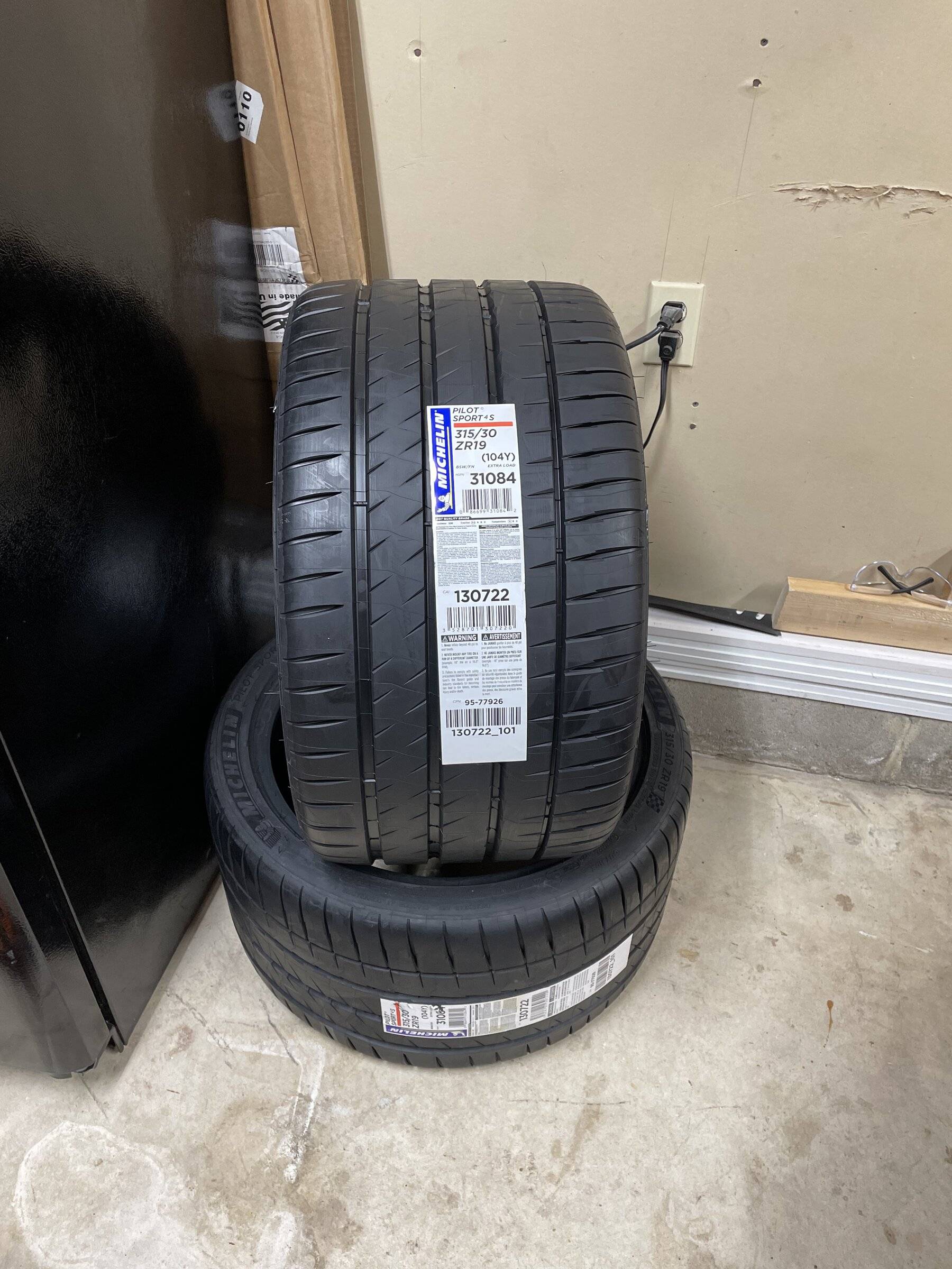

I got 275/35 up front and 295/40 in the rear on Continental Extreme Contact.
I’m gong back to the drawing board, I don’t like how it leans slightly to the rear.
My tire guy insists 305/35 and 315/35 will not fit with out modifications….
Opinions ? Comments?
I’ll be hitting up Discount tire tomorrow to see what I hash out
Charlemagne
Jan 14, 2021
1,974
3,484
Czech Republic (Europe)
Nick
@Bullitt69 It probably depends on your wheels and offset and whether you're lowered. Mach 1 HP wheels with offset 52.5 in the rear allow 315/30 or 305/35 easily, pretty sure 315/35 wouldn't be a problem either except I don't see such tyre made. When 305/30 works in the front, 305/35 will too. I am not brave enough to run square 305/35 (peeking too much) so I chose 285/35 front and 305/35 rear.
