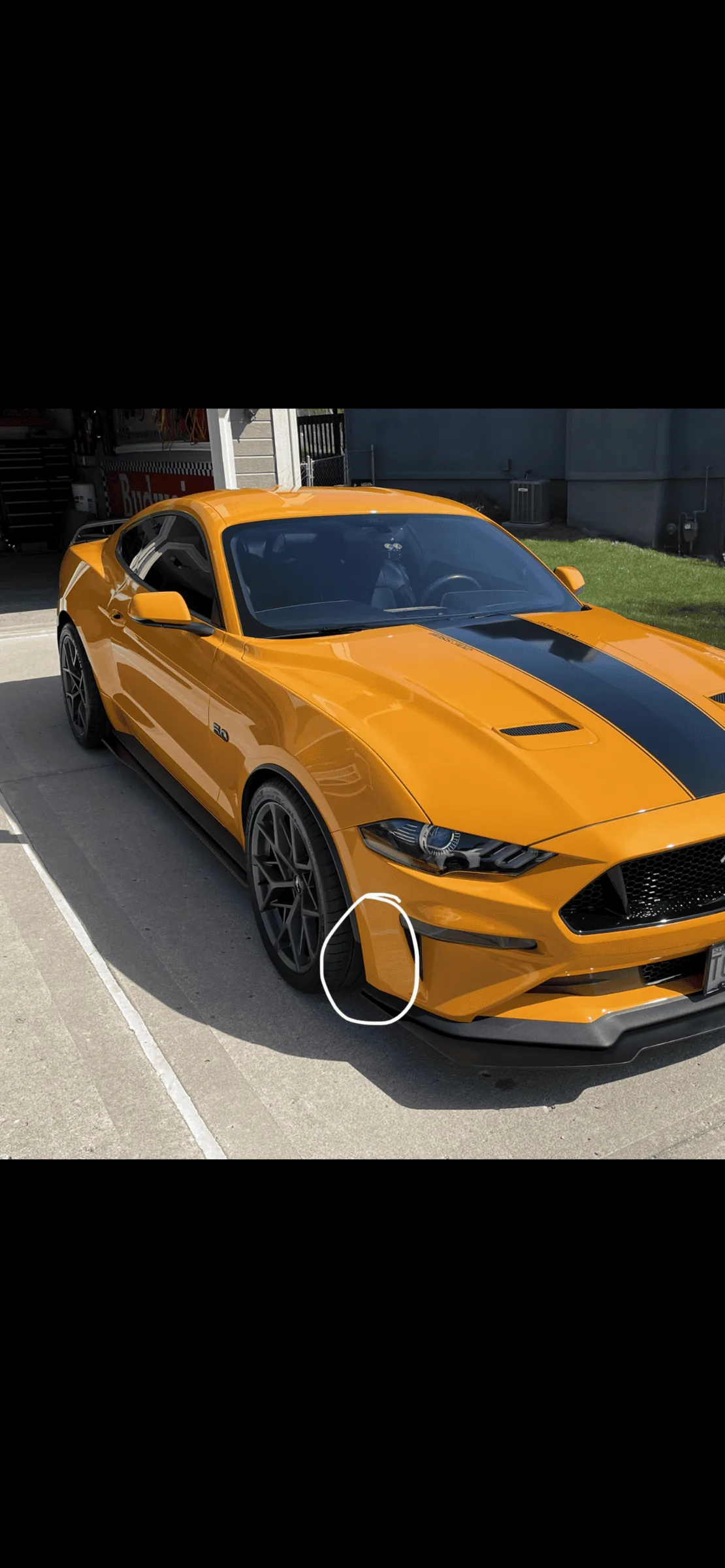

Anyone with a non Mach 1 find a solution for the front wheel lip mouldings that stop short on the front fender on the GT?
You need the Mach 1 splitter to close the gap.

It still looks good. Doubt there's any solution to this...
I made a few different style/profile “wings” similar to my stone guards I’m running but nothing looked right. No good mounting points and the fender trim is rounded and I was using textured flat plastic. Didn’t flow. Looked like an after thought.
