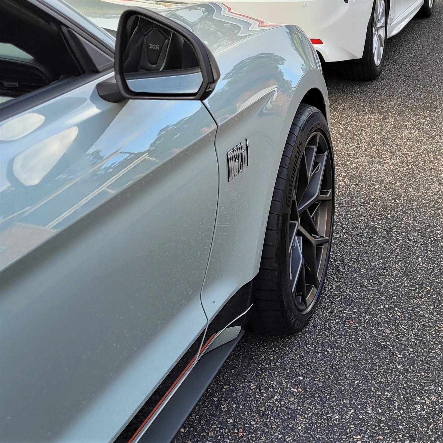

HP wheels went on today.
Tyres are Contact Sport 6.
285/35/19 & 295/35/19.
Looks great, remember they make the Mach1 fender flare that will cover up any front tire that is out side of the fender! It was part of the HP package for Mach 1s.

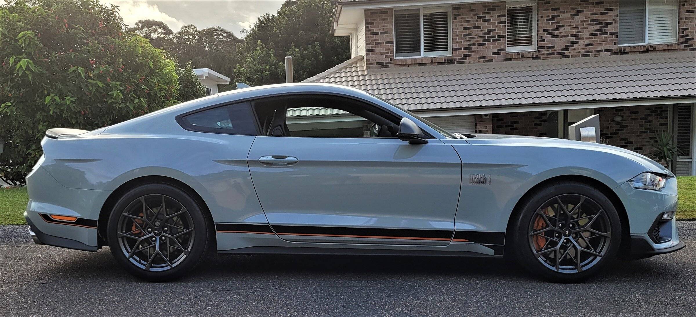

Thanks, they ended up fitting really well, always a bit of a gamble when you take on a change of rims and tyres, luckily it ended in a good result.
HP springs, adjustable camber plates and solid rear bar to go on next, ill be measuring ground clearance closely before and after, hoping not to end up with a lower stance. Once that's done its just the front splitter and rear wing. Will post some more pics as it progresses.

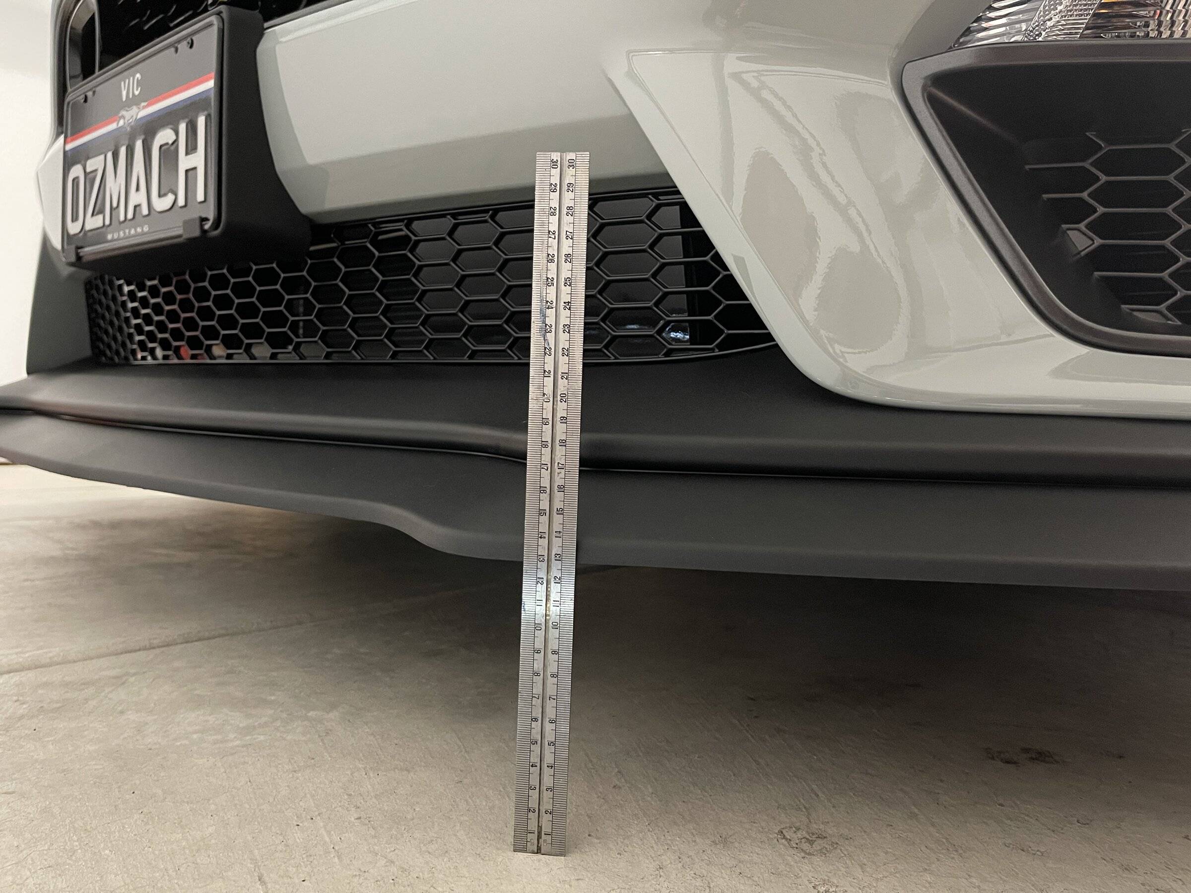

The front splitter and rear spoiler really enhance the aesthetics with a much meaner stance, and of course better grip on the track if ever going that way. As a guide, pre suspension modifications will result in 13cm clearance with the front splitter on, measuring the ground to splitter edge. The underbelly pan of course is lower than that. A bit of caution on the roads, choosing the right crossovers and streets with little or no speed humps. Thankfully I can get in & out of my driveway no problems 👍👍.
