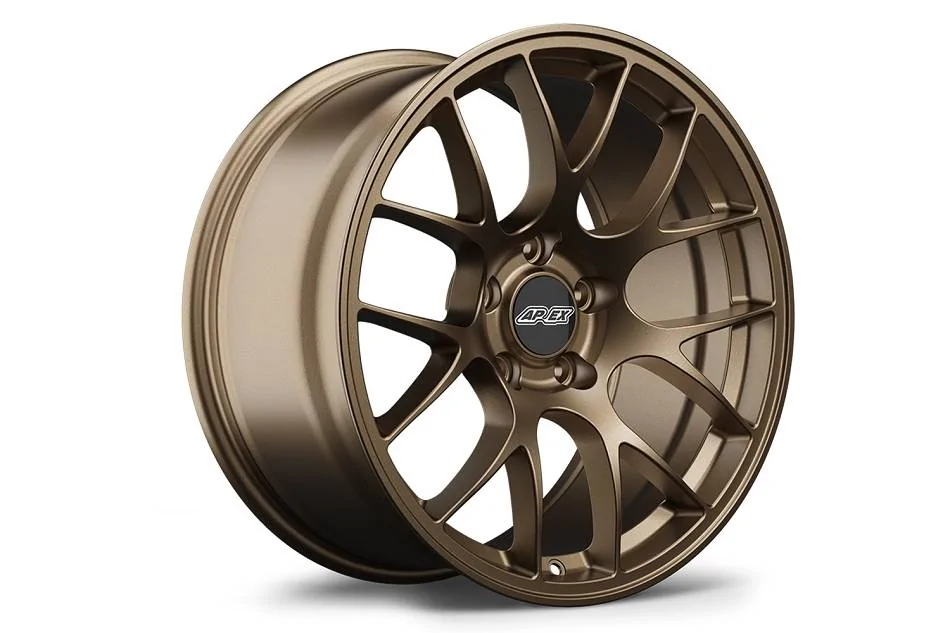

Thinking of storing my Mach 1 HP wheels in the attic and getting the Apex EC-7 but the only come in 19x10 and 19x11 and not sure if 305's will fit on 10" fronts, might have to go with 295's.

I know! The wheels I want to swap out to, don't come in 10.5" only 10" with the correct offset.
Then look at a site such as Tirerack for the 305, click on specifications, and see what the rim width range is for a 305.
unless you're using them for track/hpde/autocross 10" is plenty.

I saw that too, that's why I was asking. Can't imagine 1/2" would make too big a deal, maybe tirerack is wrong?
SOME 305 run narrow, some 295 run way freaking wide. It depends on the tire. Of course you *can* run a Cup2/PS4(a)S 305 on a 10" and you're not going to end up in a ball of fire but it won't perform at it's best and may have a small chance of rubbing suspension parts or fenders or whatnot. It's a guideline. People are free to ignore it just like the dude on another thread running 245 on a 11" rim.
10mm won't make a difference I'll probably just go with 295's
Look at the Michelin site, it says the same thing 10.5.
305/30ZR19 (102Y) XL BSW
Buy now
MSPN
10365
Mileage Warranty
30,000
Section Width on Measuring Rim Width
12.30" on 11.00"
Overall Diameter
26.32
Max Load, Single (LB @ PSI)
1874 @ 50
Revs/MI
792
Tire Weight
27.91
Rim Width Range (Min/Max)
10.50-11.50
Tread Depth (in 32nds)
9.5
