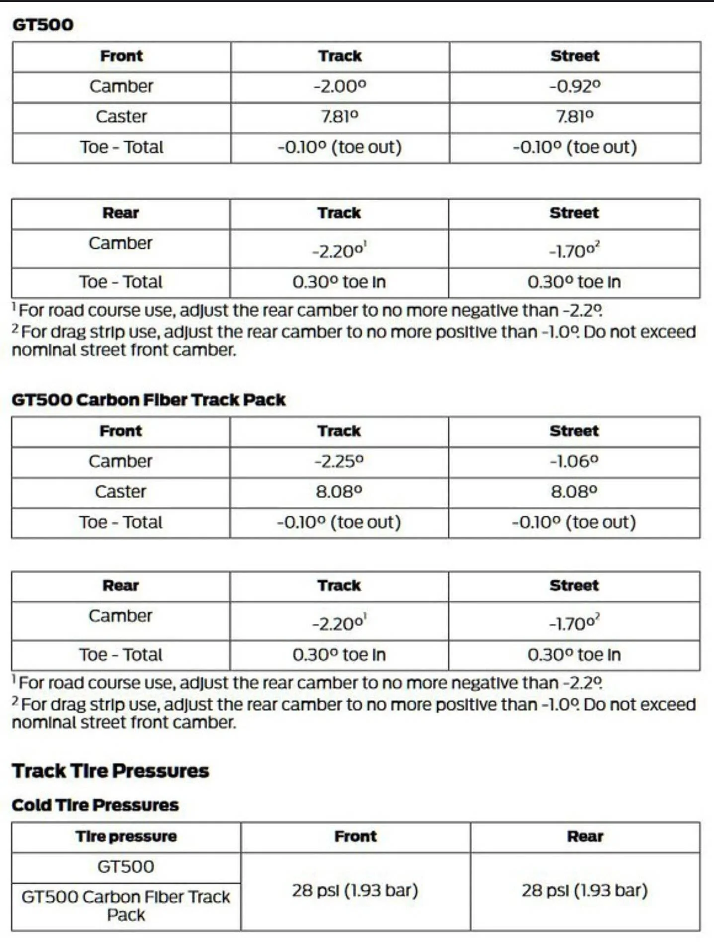

Ordered vorshlag! Local mechanic said no problem. I saw a chart somewhere Ford recommended track camber is -2.2 on the 2200+ GT500????

Look at the supplement to your owners manual. It's all in there.

I think that's where i saw it. I will go back and look again. Just wondered if anyone had real-world experience with them.
